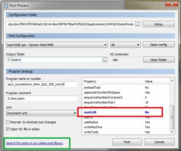

    I have used Fusion for many months now with my CNC router, and I discovered very early on that the G28 operation is complex and confusing if you are using Mach3. The answer however is simple - just turn it off in the CAM options. All works as expected then! I read this somewhere on a forum, along with long discussions as to what it should do, and what it actually does. Dazed and confused, I just turned it off, and I haven't looked back.

    Hi Charlie,
    When you post process the toolpath you get this menu:
    (red box)
    Select G28 - no
    I've also looked into searching the post processor library (green box) and there is another Mach3 PP in there which mentions various features including G28. I'll look into that.
