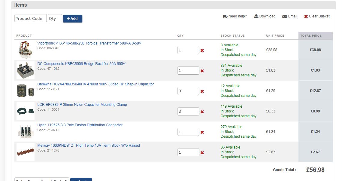

    Check out Joe's excellent vid.
    https://www.youtube.com/watch?v=4OoQ...zD30sZjtp_VyqY
    here is a shopping list from Rapidonline https://www.rapidonline.com/
    I would go with a 45-0-45 V toroidal instead of the 50V
Name:	power supply.JPG
  10. The Following 3 Users Say Thank You to Clive S For This Useful Post:

    Listen to Clive I speak from experience lol
    http://www.mycncuk.com/threads/10880...6816#post96816
    get a 45v not a 50v, if you do insist on a 50v buy mine of me it's only had 10 minutes on time before I bought a 45v one lol. Luckily I got both 1/2 price so it evened out in the end and one day I shall find a use for it.
    If you were in mainland europe 50v is fine as the mains is 10v-20v less.
