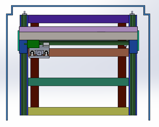

    After building a couple of 3d printers, and building and struggling to do anything with an MPCNC, iv decided its time to make a proper cnc router.
    Design criteria are,
    Desktop machine with foot print no bigger than 1050 by 850 to fit on my existing bench.
    Make use of the 4 750mm SBR16 rails, and 2 300mm SBR16 rails I have buried somewhere in the workshop.
    Capable of cutting the end of sheet timber to make box joints.
    Reduce costs where possible without affecting performance.
    After alot of reading, and a few design iteration, this is what i have come up with.

    Total length 900mm, rail length 750, travel 600mm.
    Mass approx 25-30Kg

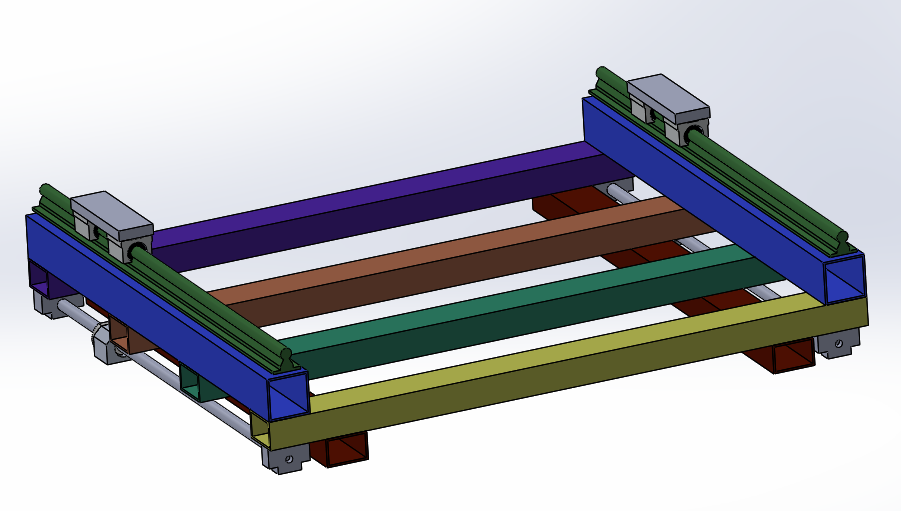

    Base frame and Y axis
    Base frame is made from wedled 60x60x3 and 60x40x3 steel. Rail surface will be leveled with epoxy. 1610 ball screws are under the bed to reduce the machine foot print. Id like to drive this with just 1 nema 23 3.2nm motor. Is this possible with a gantry approaching 40kg?
    The machine will sit on 4 adjustable feet which are not in CAD yet.
    To give you an idea of the space constrains, this is a plan view of the current design with the workbench parameter shown.
    Total machine weight is around 70kg.
    Cutting area will be around 600x600.
    Gantry clearance 140mm from the steel base frame. 120mm ish after adding a bed.
    Id love to get some feed back on the design before I start ordering parts or cutting metal.
    Also im struggling with where to buy the electronics and what to buy, any advice would be really helpful.
    im also yet to choose a spindle. Id love a 2.2kw water coolded one, but they are bloody expensive and if possible id rather not have to bother with water cooling. Any suggestions?
    Design is crazy simple this is a good thing! I can understand why you want to use the SBR16 BUT sell them and get 15mm Hiwin's you're router design is too good for SBR and it will be the weakest link.
    Except the truth this is going to cost more than you think it will, if that doesn't scare you off and it shouldn't mostly your costs go up because someone tells you not to buy this but to buy that instead and you do but in the end you end up with a router not a Xmas cracker toy like the MPCNC.
    I speak from experience my plan was to build an xmas cracker but along the way it turned into a router and the budget went to Honolulu for a holiday ;)

    Thanks for the feedback.
    During the design I considered hiwin a number of times as I know they will be loads better, but to get things started at least I will stick with the SBR16 I already have.
    If fully expect to upgrade to hiwin at some point, hence the x axis ball screw been fixed to a bolted in piece of tube, not welded, so it can be easily adjusted to suit the smaller rails. The y and z rails can be replaced buy just drilling some new holes in the aluminium plates and a few new spaces I can mill (probably slowly with the sbr16 rails) on the machine before I dismantle it.
    This also helps cash flow a little! As you say I expect this to be a rather expensive project, and spreading out the cost a little will please the missus!
