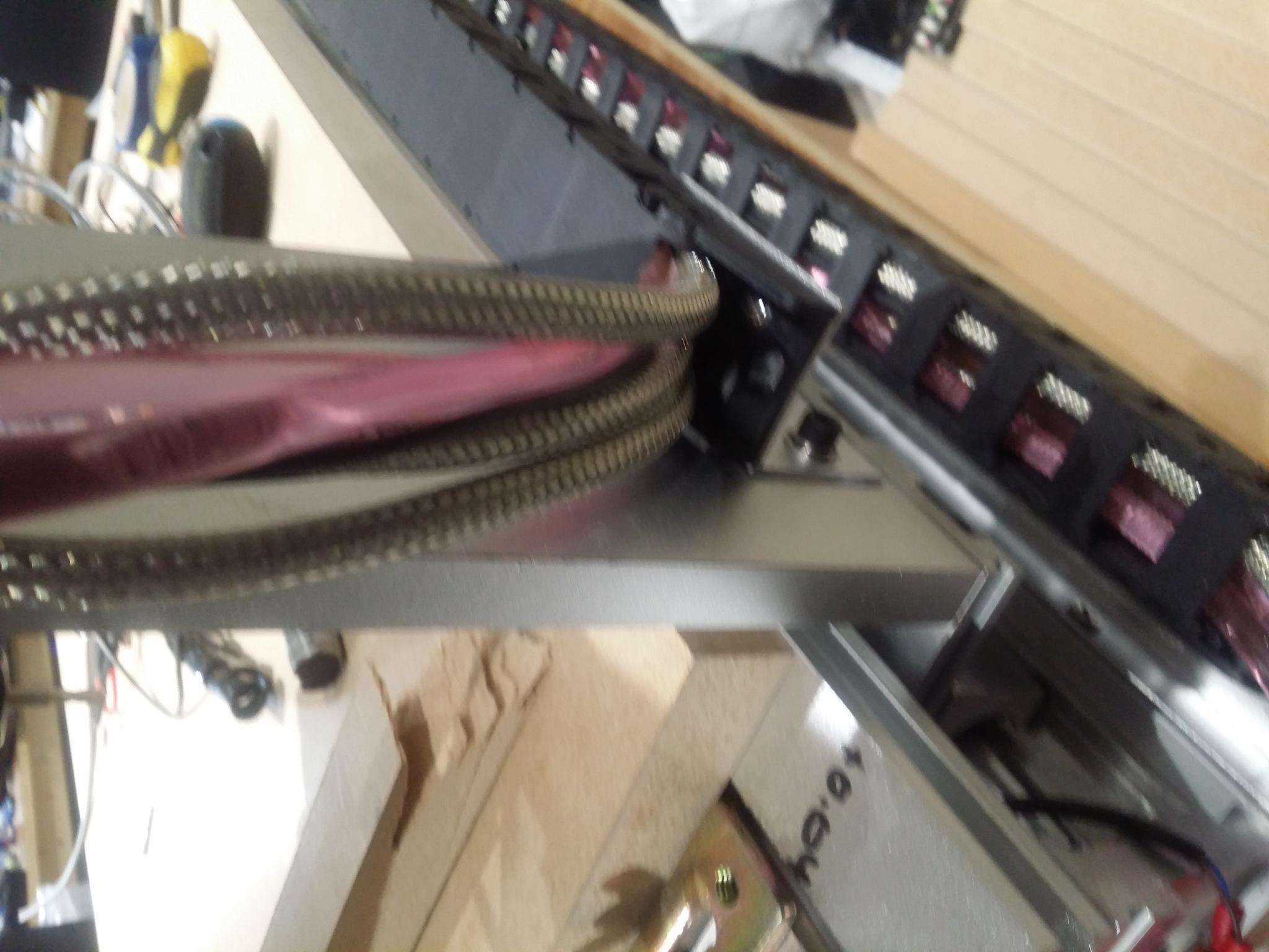

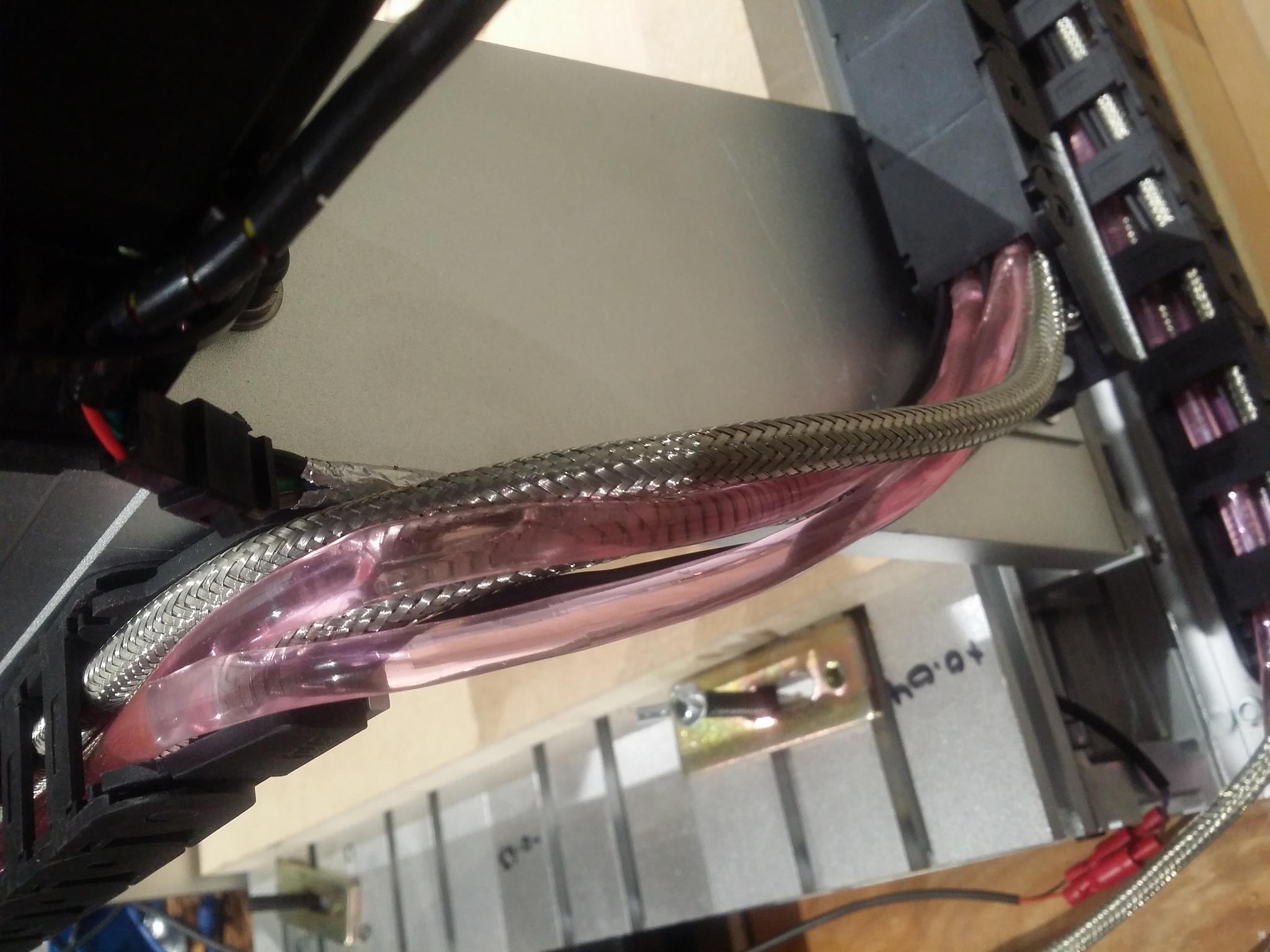

    I started with external cables to Spindle and Stepper motors.
    Supplied VFD cable looks nice flexible rubber 'pond flex' cable. It's plain unshielded 0.75mm2 3 core and earth. The earth wire IS connected to spindle (thank god), but no shielding.
    I replaced the entire cable with shielded 1.5mm2 CY control cable. To be extra careful, I also added external copper braid shield. It's now double screened.
    I didnt replace the stepper cable, I suply added a copper braid sleeving to the entire length. Obviously, the sleeve is connected to earth....
    Actually, no. The aviation connector barrel on the chassis is making contact with paint, not metal. NO EARTH CONNECTION! I had to scrape off paint inside the case to sort that.
    Next job is shielding the cables inside the control box, then probably moving VFD to its own enclosure.
