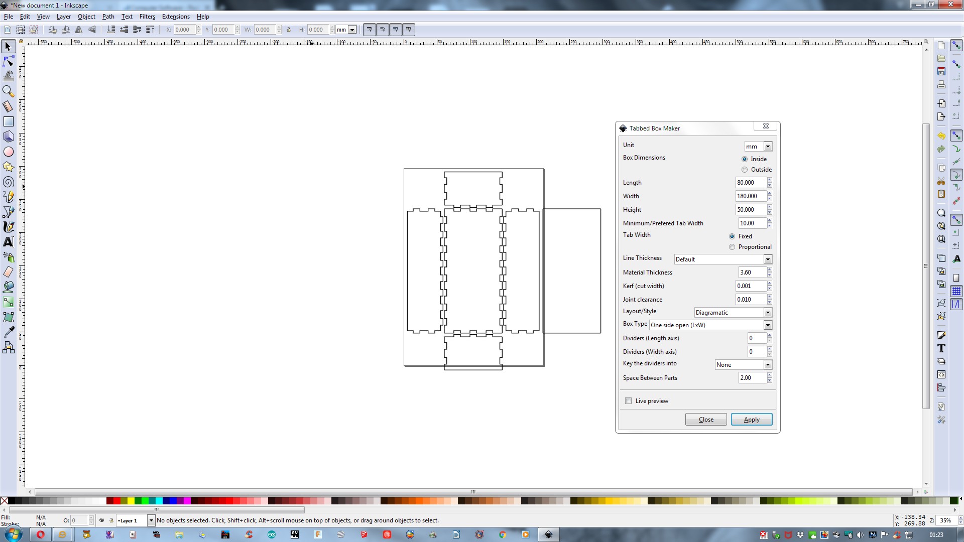

    I have just deleted Python and my two copies of Inkscape, so I could do a fresh install of Inkscape 0.92 and include the tabbed boxmaker extension. After a lot of faffing about due to the confused situation of the two Inkscape versions - it all works beautifully.
ID:	23690 and you can save as a DXF as well !
    After struggling with AutoCAD (and giving up !), this is neat.
  2. The Following 2 Users Say Thank You to cropwell For This Useful Post:
  3. #2
    I didn't know about that extension, thanks. CamBam has a similar plugin, http://www.atelier-des-fougeres.fr/C...s/BoxAuto.html
    There's also a script I did for finger joints, http://www.cambam.co.uk/forum/index....33621#msg33621
    it uses these modifications I did to the machine, here, http://www.mycncuk.com/threads/8243-...5028#post65028
    and here, http://www.cambam.co.uk/forum/index....33143#msg33143
