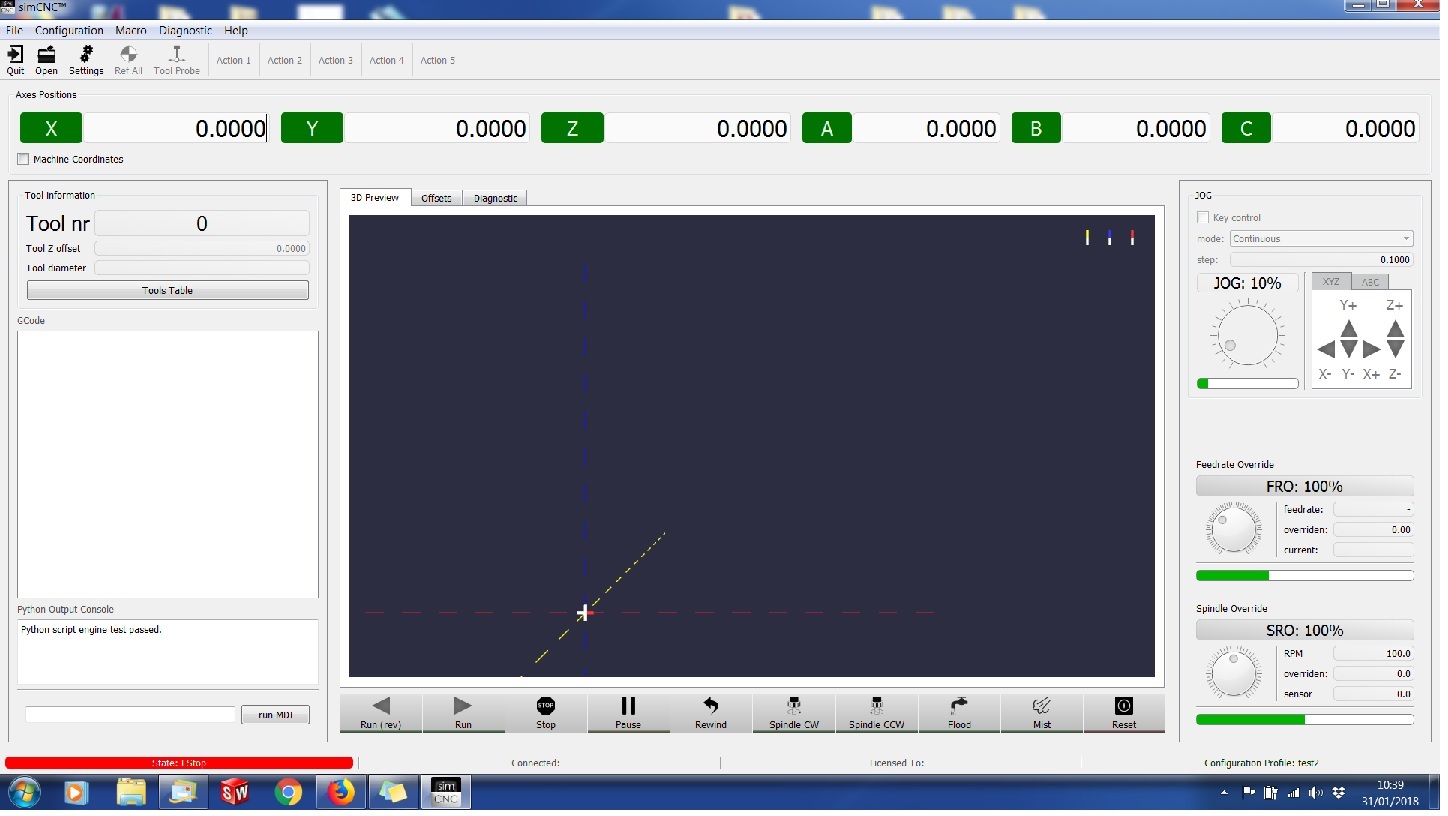

    Here's the front end. That's far as I've got so far. I'm having trouble updating Firmware and until it's done can't use it in anger. I'll start a thread with any issues I find and why can't update firm ware etc. Thinking it's dodgy Firmware or loader because I've updated many these controllers without issues.
    Just ordered the 30 day trial software myself. Not much info on the website, no manual to peruse, does a manual come with the software download Dean?
    No there is an Install manual you can download. I'm sure there will be manual at some point but it's still early days and sure there will be changes happening. Manual tends to be little later down the line when things have settled down.
    Just so your aware machine needs to be connected to internet to install software which is a pain in the arse but I'm sure they'll come up with a standalone version at some point.
    yep, having to connect to the internet is a right pain in the arse, I deliberately do not have my control PC connected to the internet. I look forward to your review of the software Dean. I am sure it will be far more informative than anything I could do lol. I am really hoping that there is semi auto tool change height setter like the 2010 screen set.
