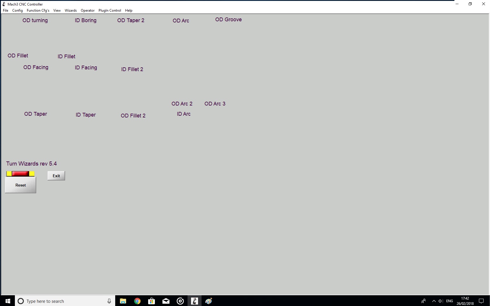

    Can anyone help me with my mach3 problem? I'm trying to load the turning.set creenset but when I do, it looks like there are things missing, like in the attached screenshot. I tried installing it on other PC's and it's exactly the same, I used a couple of different versions of the installation file, including the latest version.
    Then when I click EXIT, I go back to the previous screen which is completely blank. hmmm...
    What am I doing wrong?

    You're selecting the wrong screenset. That is the screen for turn wizards.
    What I suspect you want is the 1024.lset screen (the .lset denotes a lathe/turn screen, whereas .set is mill/router/plasma).
    But I do want a turning screenset, and the 1024 is the Milling / plasma screenset as far as I can see.

    Ensure that the 'option' for turn is selected. By default, only mill is offered when selecting.
    Thanks, where do I find this option?

    When you try and open a new screenset it 'filters' to mill. Just change the option in the pop up box.
    Okay, I got my main screen back but when I try to load the Turning.set (the one above with missing textures) and pick Turn Files .lset from the list, the Turning.set disappears.
    I just want to load this screen

    Okay, I got it.
    I copied the 2 folders from the TurnAddons folder int the Addons folder and then they appeared in the Wizards list.
