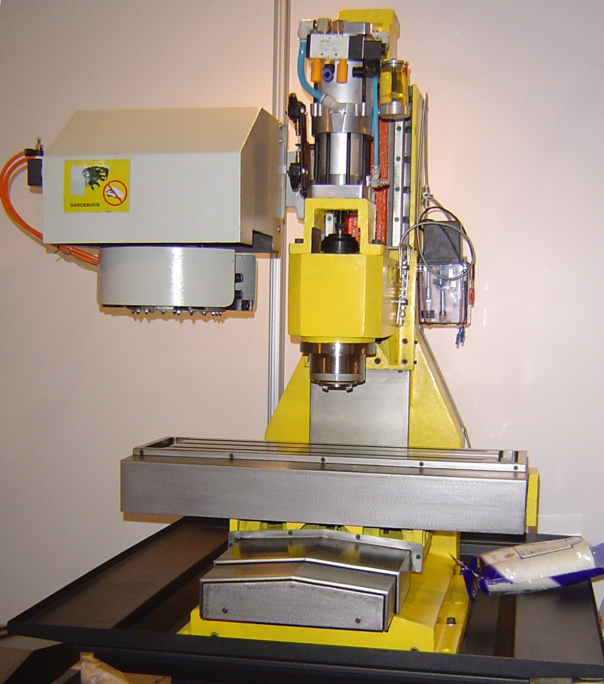

    Attached are some plans that Dave Walsh (of BT15 spindle cartridge fame/saga) posted at some point.
    And here's some notes I made about the UMC10 (IIRC I noted them down from his videos)-
    6" x 6" x 1/2" wall thickness column
    10" x 4" x 1/2" wall thickness base
    6500rpm spindle = ~11000rpm motor speed
    3hp spindle
    table 1 1/2" x 8" crmo steel
