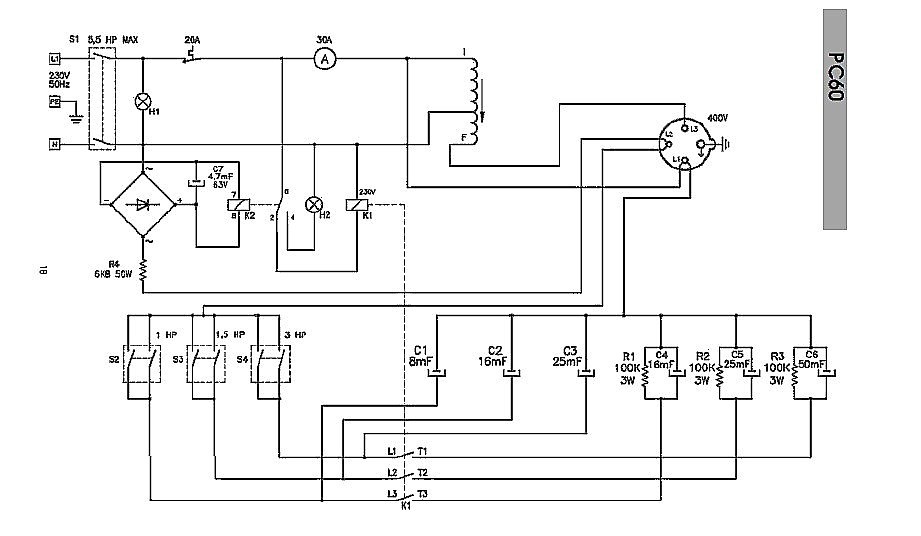

    example of simple converter that would not work for your machine
Name:	simple 1 to 3 phase converter example.jpg
    John

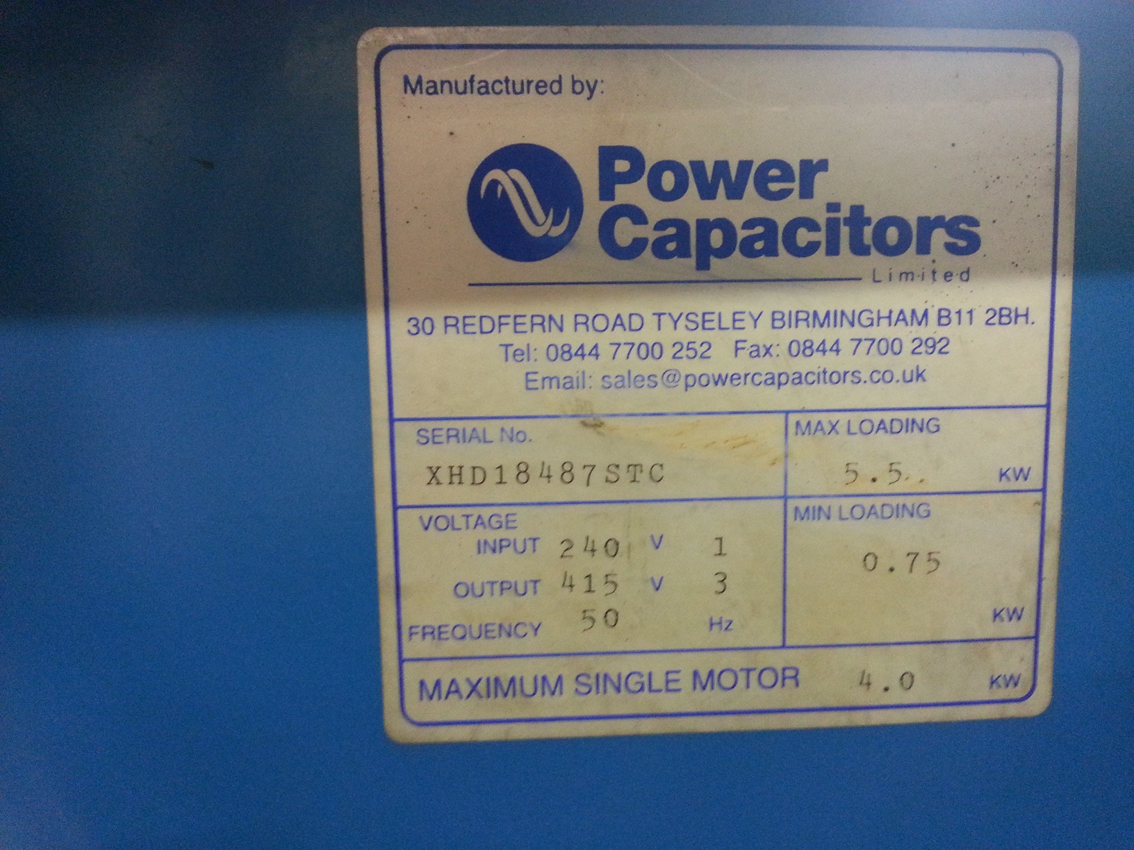

    The converter is a Transwave 5.5Kw cant see a model no. but the serial is XHD18487STC
    As it not mine I dont want to open it up to see if its like the example. cheers

Name:	20180215_190348 (002).jpg
    Looks like 0.75kw min on the plate and the spindle motor is 1.5kw. not sure if the ac servos will pull enough though to move the axis without the spindle running.

    Static converters are no good for anything other than direct motor loads. They rely on the motor spinning, and the corresponding load/backemf and a bank of capacitors to create the generated leg. Without the spinning motor, the generated leg voltage will be all over the place. Even with a motor attached, the generated leg voltage will vary during changing loads. More advanced static converters let you switch capacitors in/out to try and compensate, and some even do it automatically for you.
    However, what you could do, is attach a reasonably sized motor to the static converter, and you have a rotary converter.

    I have just spoken to a very helpful guy at Transwave and he has suggested the same thing, Not ideal but would get me running hopefully.
    Yes this one has a switch for the capacitors so I can load up the dummy motor and get it reading right before I power up the lathe, Just have to hope I can get a bigg enough dummy motor to smooth out the voltage.
    Its not ideal but at least i might be able to use the lathe and make sure it will do what I need it to do before spending any more money on a digital converter or a retrofit.
