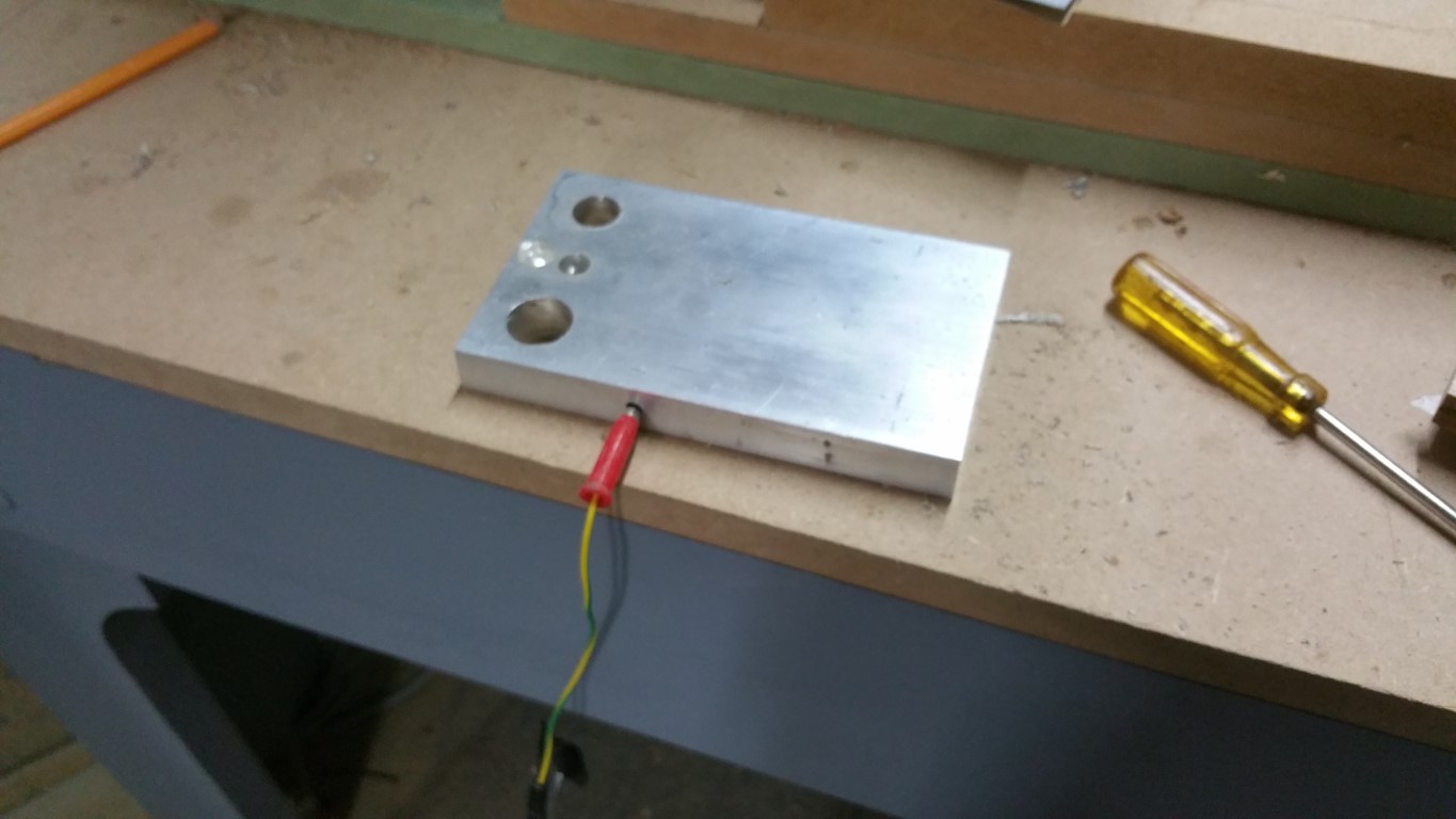

    One other thing I've added is another breakout board as i ran out of inputs to add an auto Z touch off plate- so ticked that off as well- also means i can add another 5 axis if i should ever need to! lol (although a 4th axis seems fun!!)
