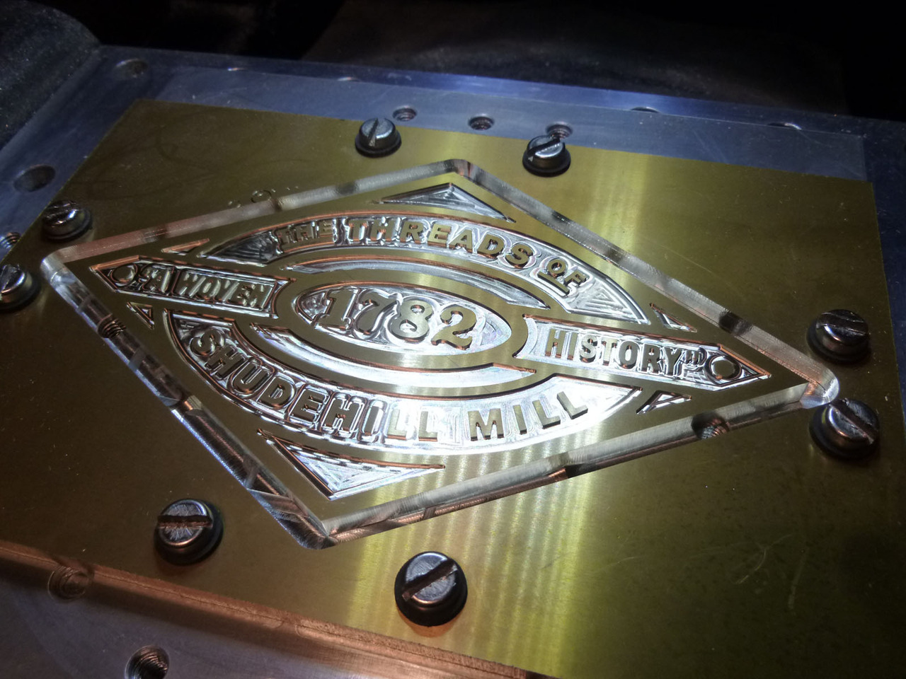

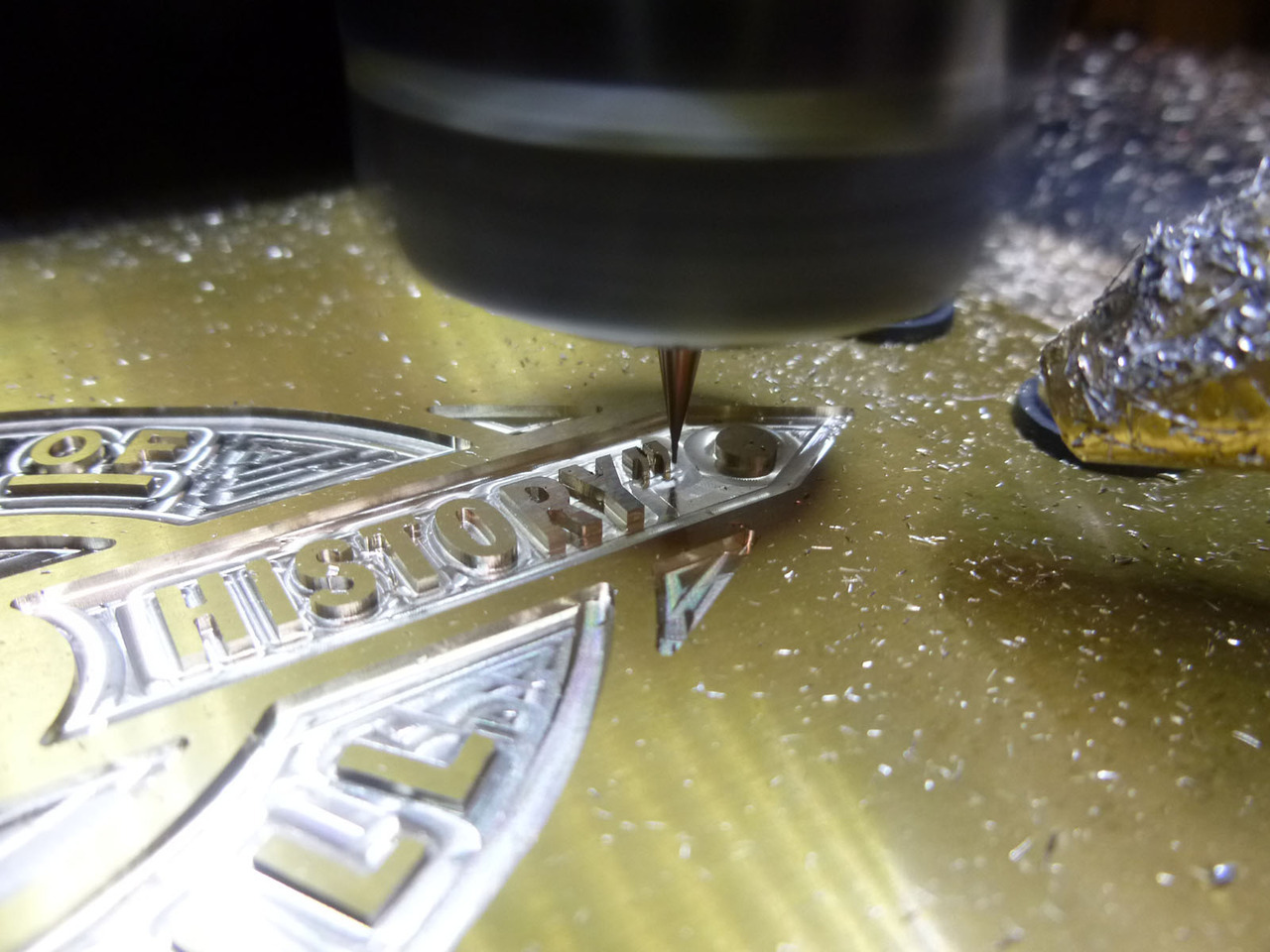

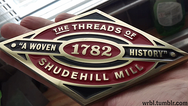

    I made this a while back. CZ121 brass - 1/4" plate. Despite being on a larger scale than most of what I do, I still needed to use a 0.4mm end mill to get that detailing around some of the letter-forms..!
    As usual, it was filled with cold enamel resin (well, half filled - to get that softer/relaxed look where the paint meets the metal) before getting the bejeezus polished out of it.

    that's awesome. how do you do the infill
  8. #7
    Wal's Avatar
    Lives in Stockport, United Kingdom. Last Activity: 2 Weeks Ago Has been a member for 9-10 years. Has a total post count of 491. Received thanks 71 times, giving thanks to others 29 times.
    Quote Originally Posted by johngoodrich View Post
    Cheers John.
    I use the 2-part cold enamel available from Cookson Gold. It's good stuff, but needs to be mixed very accurately - particularly when prepping smaller quantities. Two ways of filling - over-fill and sand back to a flush surface, or (slightly trickier) under-fill to get that sunken look. In either case, flash it with a blow torch to remove air bubbles.
    Wal.

    Apologies for resurrecting this old thread - the original post related to a test piece / prototype. The project sat on the back burner for near enough a couple of years, but a tweaked design eventually came through a month or so ago and I was commissioned to make 15 plaques in total. Managed to get a bit of the process (including the enamelling) recorded, here are a few clips. My favourite bit's got to be at 18 seconds in the first clip - 0.4mm end-mill in brass. Never ceases to amaze how resilient these little cutters can be..! Everything cut dry, just a bit of air.
    In that middle clip you can see that the cog plaque has a more pronounced meniscus effect - you're seeing it before the final clear coat of resin which I added to the process. It flattens out the effect, but will serve to protect the plaque and add to its longevity - the resin's pretty tough stuff. These are being installed as paving slab way-markers in North Manchester - it'll be interesting to see how they get on being walked on all day.
