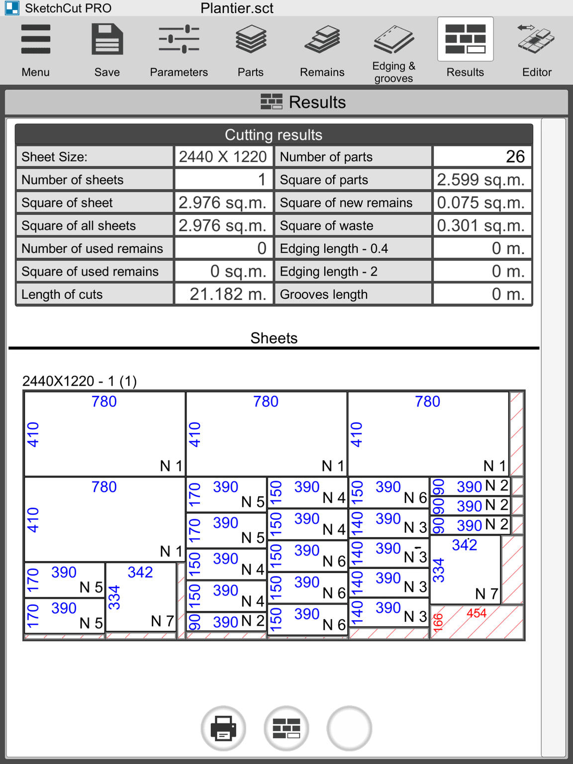

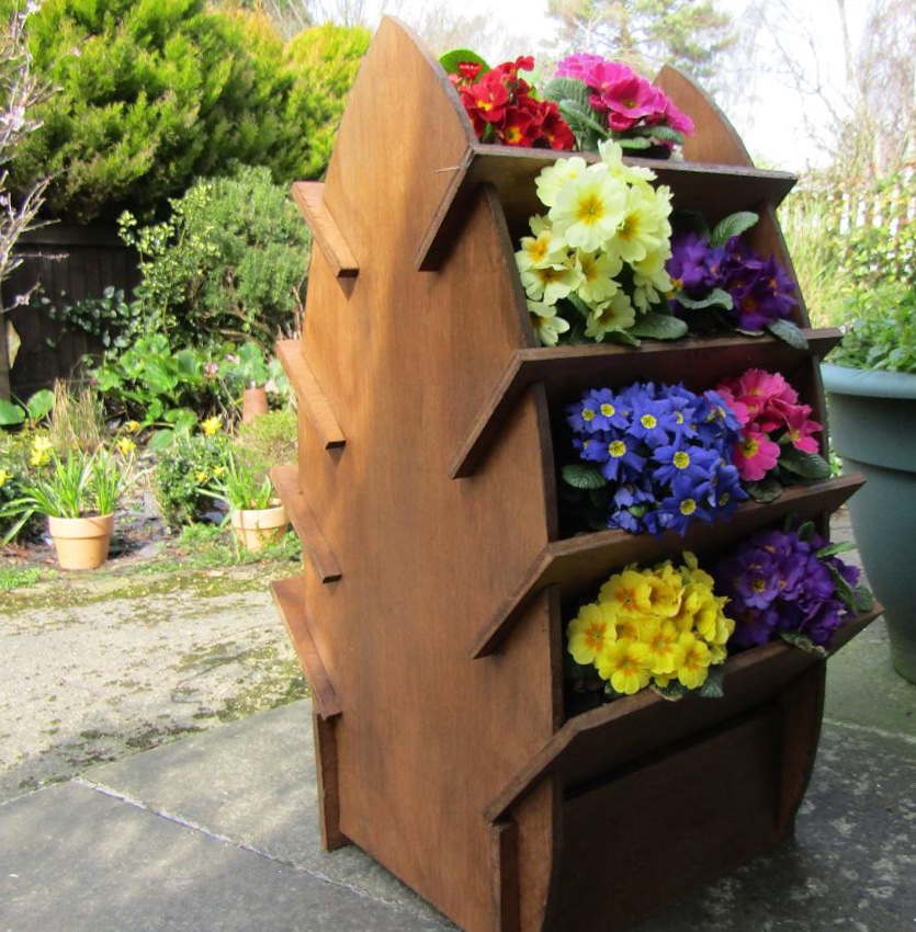

Attached is a garden planter I have designed.
Each individual piece is designed to interlock together.
It is made from 12mm marine plywood.
I have also attached a "cutting layout plan" for each individual part, to produce 2 planters.
Would this layout plan be correct for a CNC router or laser machine or is there something I haven't considered?
