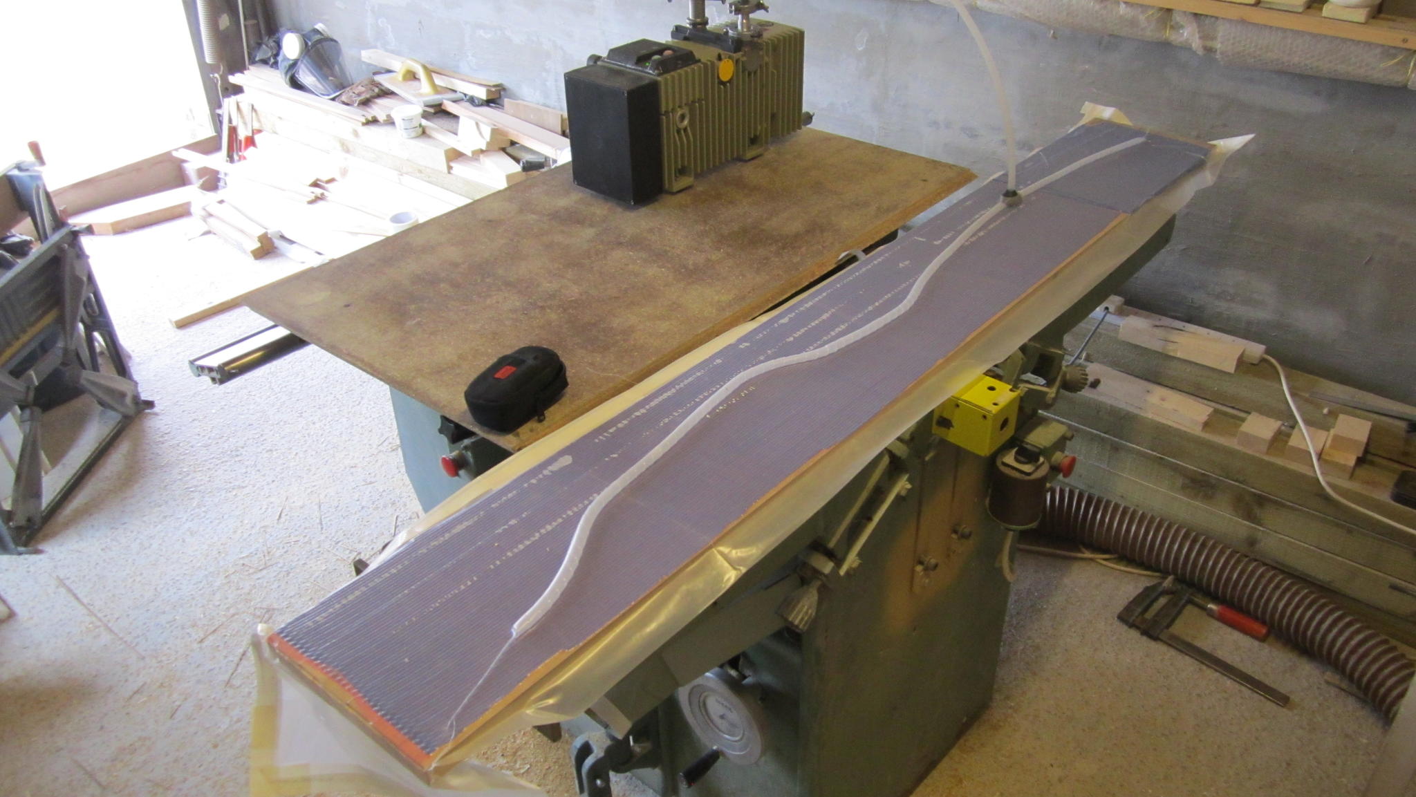

    should be fine with small surface area, also more than adequate for vacuum bagging. Have run mine for hours without a problem BUT you will get oil vapour from the exhaust and you need to vent this out of the workshop.
    Mike
