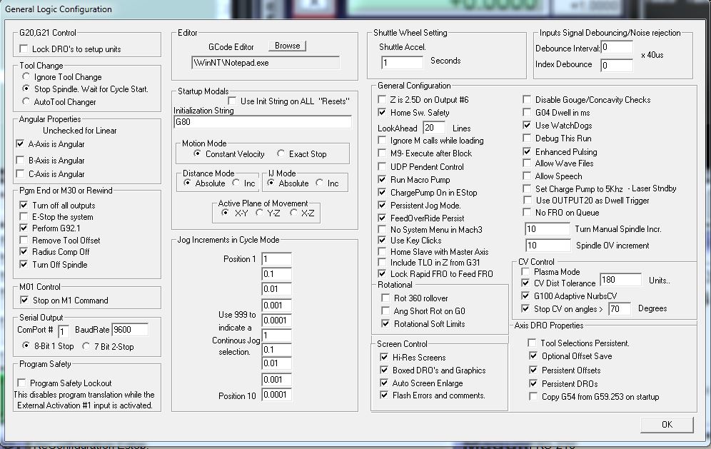

    cnc is underway a week ago and I'm still testing speed settings and axes movements, they are already calibrated from the mach, the machine runs through the mm. that I indicate until here everything perfect, the axes move at constant speed and even in X, Y-A and Z even if I move X and Y-A at the same time everything is perfect!
    but my problem is when I load a G code (done in Mastercam X5) to make a square of 100mm on the side with "rounded tips", on the straights it is perfect in speed, but when it reaches the curve it becomes slow and starts as a Take short steps seems to stop and continues slowly ... does not make a smooth and even as in the straight
    I do not know if it is due to the wrong G code or some configuration of the Mach3.
    The mach in "General Configuration" I have it as in the photo that I attached, but I do not know if it is ok

    My CAM has a % slowdown setting for corners and another for controlling whether curves are posted as curves or a myriad of short straight lines.
    Could you provide a sample of code where the issue occurs?
    magicniner I pass the code, it's something simple
    the example is done in Vectric Aspire, in this code the movement was smoother, with fewer stops ...
    it seems to me that everything is due to the "postprocessor" that each software uses to make the code G
    Can it be or am I going the wrong way?

    Check in Aspire with Vector Validator as you have a problem on line 8 radius differs from start to end.

    Really? Are you sure that ran?
    And the reason you didn't post the MasterCam code you were talking about would be.....?
    If behaviour differs with code from different CAM packages that strongly suggests your issue is code, not controller or it's settings, most of which are not on the General Config tab.

    the mastercam code does not publish it because it modifies it so many times that in the end it does anything, and the truth is, I realize that the problem is in the codes and not in the machine
    I have no experience in making codes, I only made reference to some videos published on the internet and they do not work as I should, I will have to continue learning to do it correctly
    I was worried that it could be my machine's problem and its configuration
