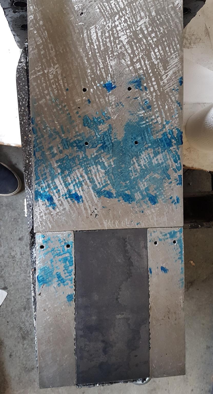

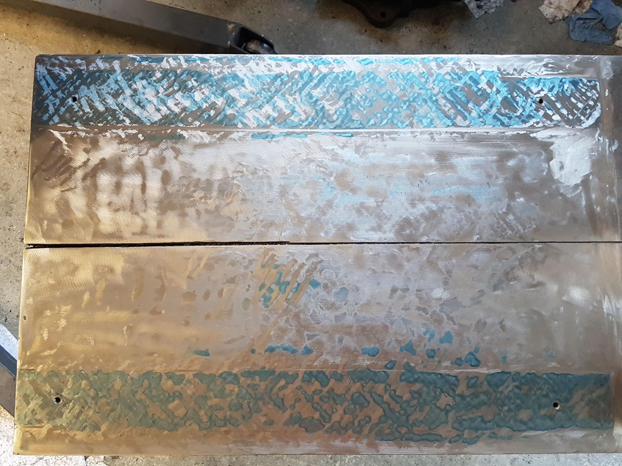

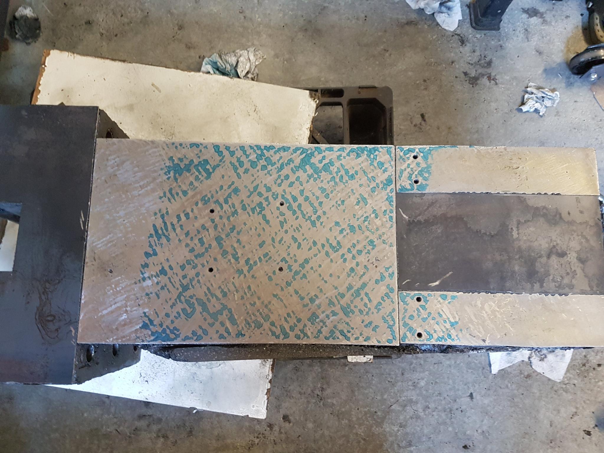

    Next step was to flatten the base casting so I could get the rails on. It was to big an area to scrape and the reference surface and base were to heavy to invert. So I blocked off two rail sized areas with wood and then used an angle grinder to lower the rest of the surface, a bit crude but worked well.
    I then flipped my surface plate and lowered it onto the base. It wasn't that far off, you could see damage from the previous owners of the surface plate.

    After several rounds of scraping, it is flat to about 0.02 - 0.03 mm

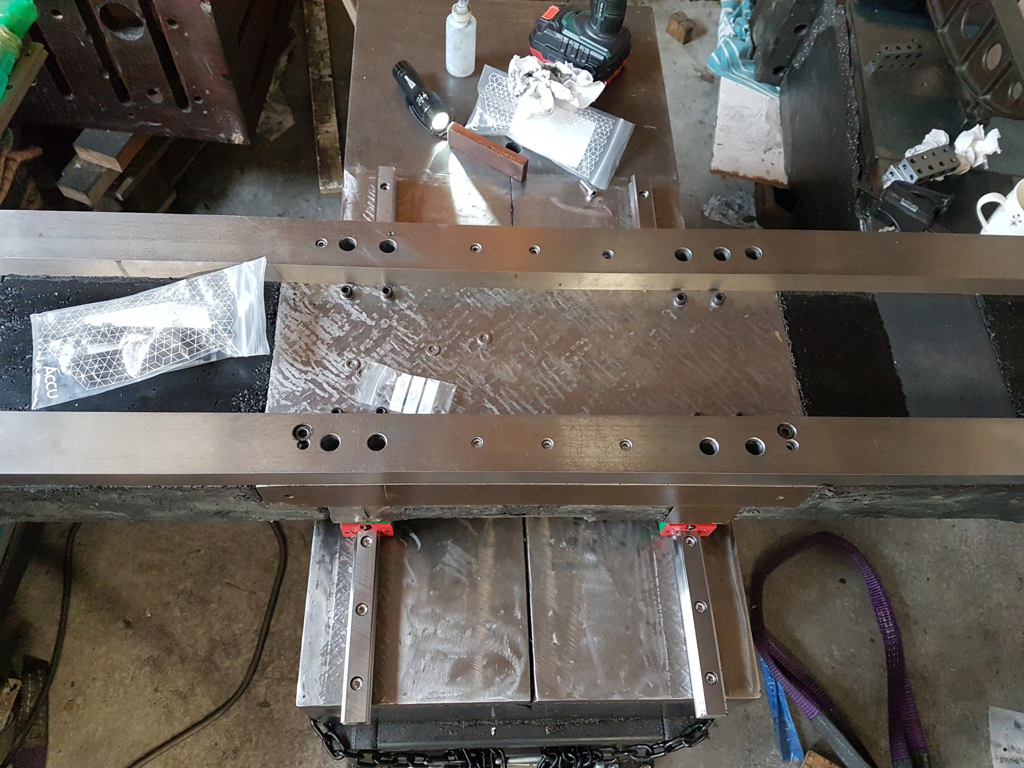

    Y axis and saddle installed:

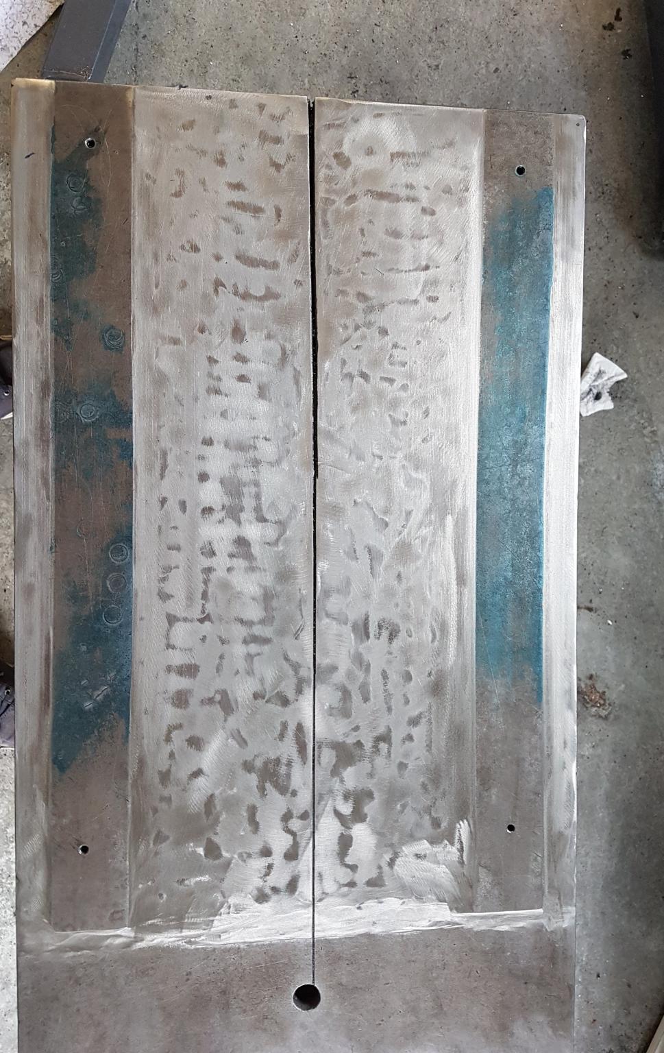

    Next step is to flatten the Z-axis rails, im using the same process as with the base, flipping the surface plate, it's really slow going.
ID:	26693Click image for larger version.

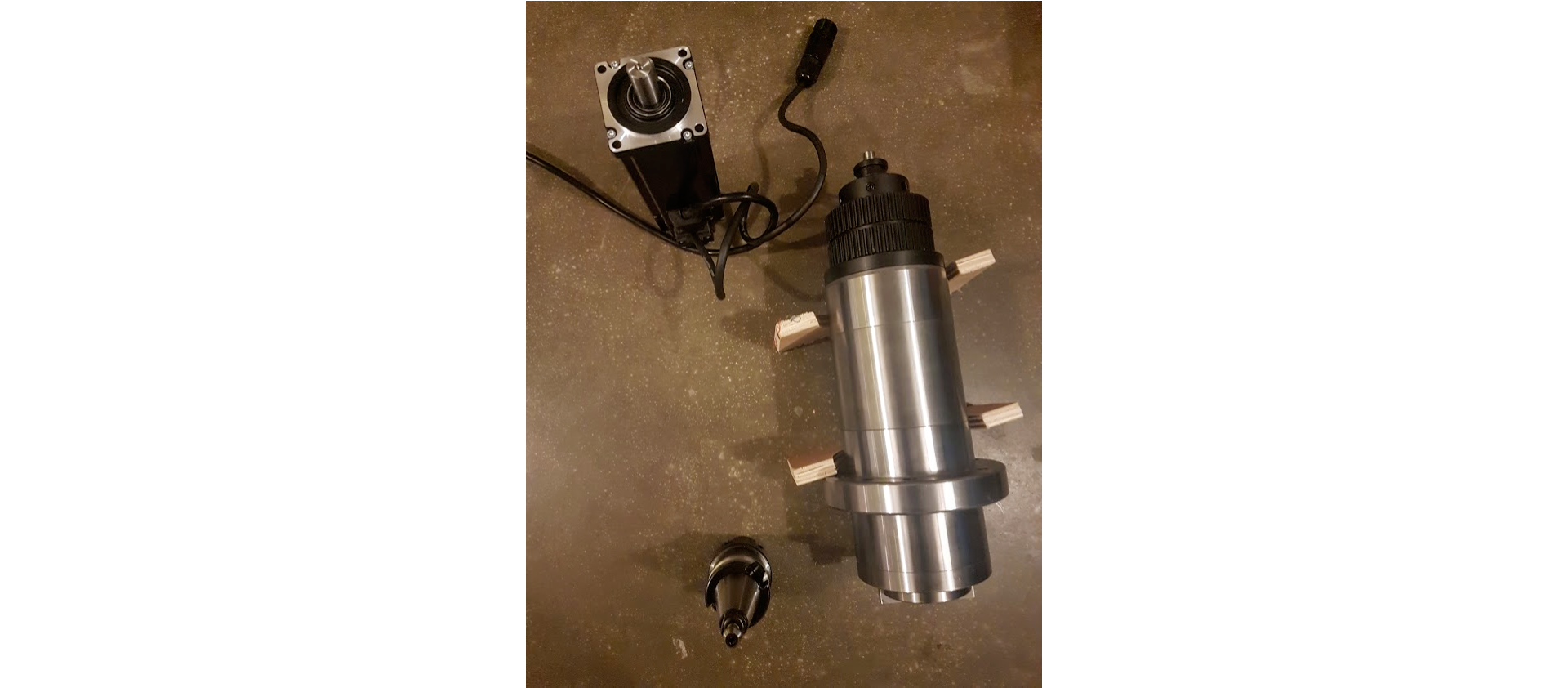

    Jazz thank you for your post, this makes a lot of sense, you've reassured me re the servos. I've decided on using the analog interface with Linux CNC, mesa 7i92 and 7i77 with the controller closing the outer loop. I might need some help with the tuning. I've bought 600w for the X and Y, I have also committed to the BT30 spindle with a 1.8 kw servo.
    Waiting for the servo for the spindle, pneumatic cylinder and mesa cards.
