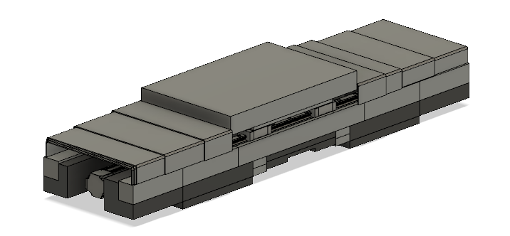

    Right so I've started on an large cast iron/EG mill build. Plan is to use several cast iron surface plates I have bought on ebay and embeded in epoxy granite, the hope is this will give me a flat surface to mount the linear rails to.
    This is the current design in fusion

    Travel: X 400mm, Y 250mm, Z 400mm
    Total weight 600-800kg
    Rails: 20mm hiwin clone rails
    Ball screws: Generic rolled Chinese ball screws, with a plan to upgrade in the future.
    Spindle: Initially: 2.2kw water cooled spindle. The plan would be to upgrade to a BT30 and 1.8kw servo from AliExpress if I can get this made and then integrate ATC
    Electronics: UC400 ETH, Initially steppers, with upgrade to 400W AC servos.
    Epoxy granite: Silimix 282 + west systems epoxy 105/206 10% by weight, 0.25% black iron oxide

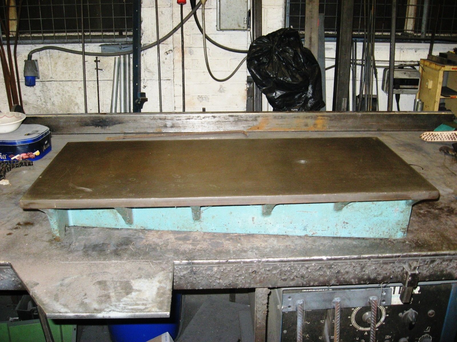

    Cast iron:
    I’ve got one 36 x 16 inch plate

    The large surface plate is reasonably flat, however the smaller plates are out by about 0.05-0.15mm. I am planning on trying to hand scrape them flat.

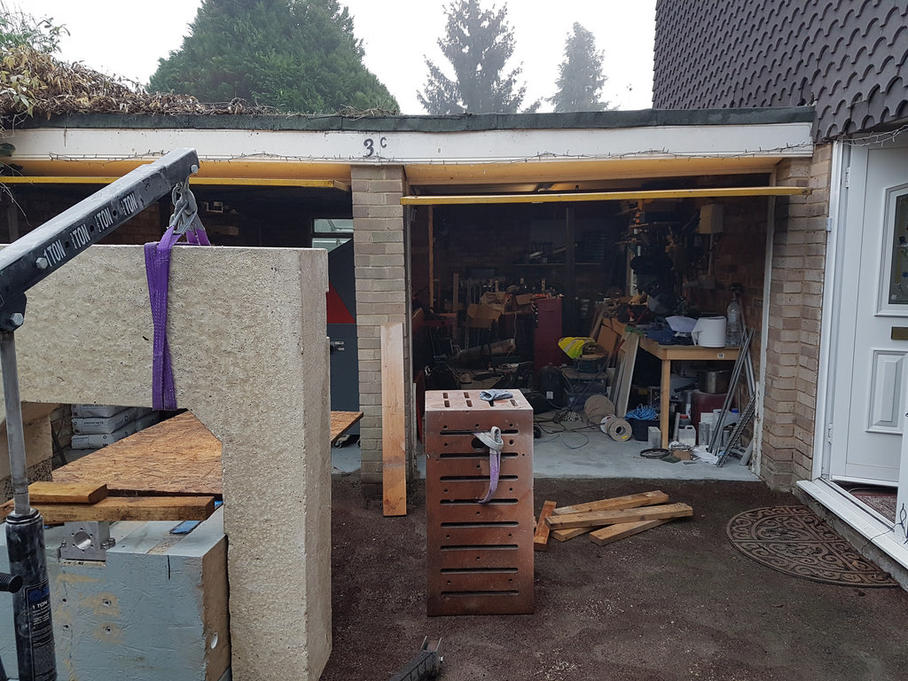

    I bought a hollowed out 'reference' block from someone. Its around 900 x 600 x 600 and might be good enough for what you need. It has slots in it and few holes / marks but its what I used to lay my Y rails, then later X and Z from that.
    Where are you based? Might be worth a chat, PM your number if you think its worth discussion via phone.
    Was just trawling through some older "subscriptions" and think this might be your "reference box" Chaz :
    From http://www.mycncuk.com/threads/10480...growing-nicely
    Chaz's Avatar
    Lives in Ickenham, West London, United Kingdom. Last Activity: 6 Hours Ago Has been a member for 9-10 years. Has a total post count of 1,605. Received thanks 110 times, giving thanks to others 69 times.
    Yep.
