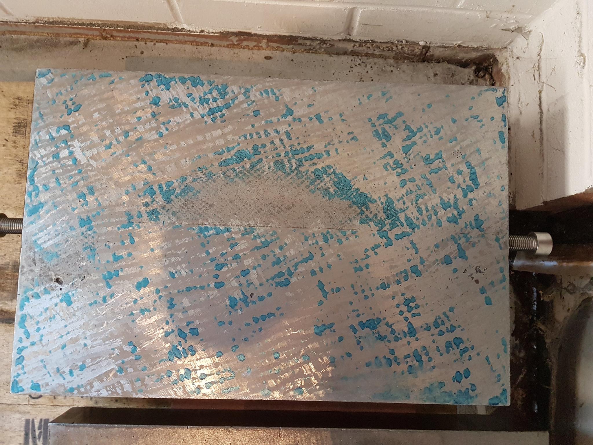

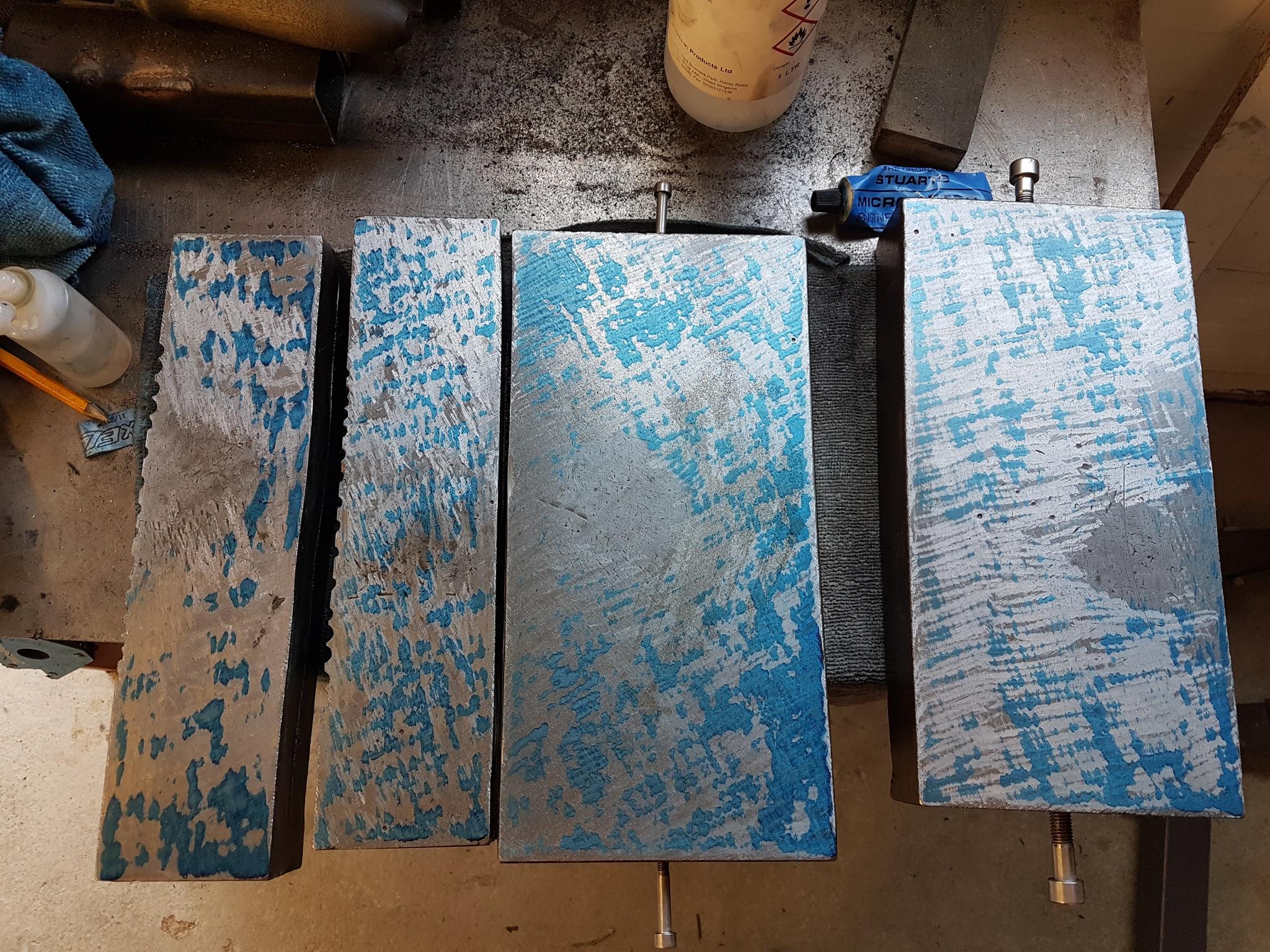

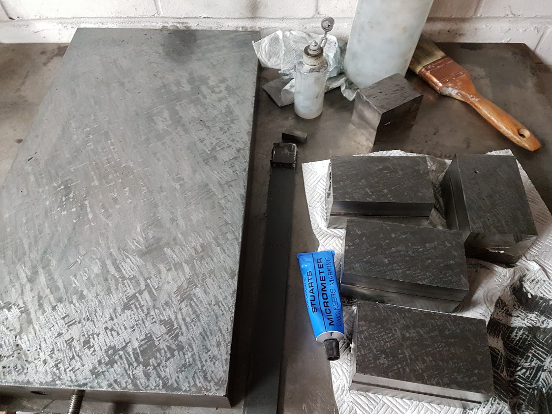

    This is a bit delayed but I owe a big thanks to Chaz who has let me borrow his reference surface. It has been really helpful and I am not sure how I would of progressed without it. I tried to pick it up in a Fiesta, which unsurprisingly didn't work, thankfully it came on a pallet.
    I've been making slow progress, I settled for an angle grinder for the cutting of the cast iron blocks, it took forever... I have managed to rough scrape all the surfaces for the column.

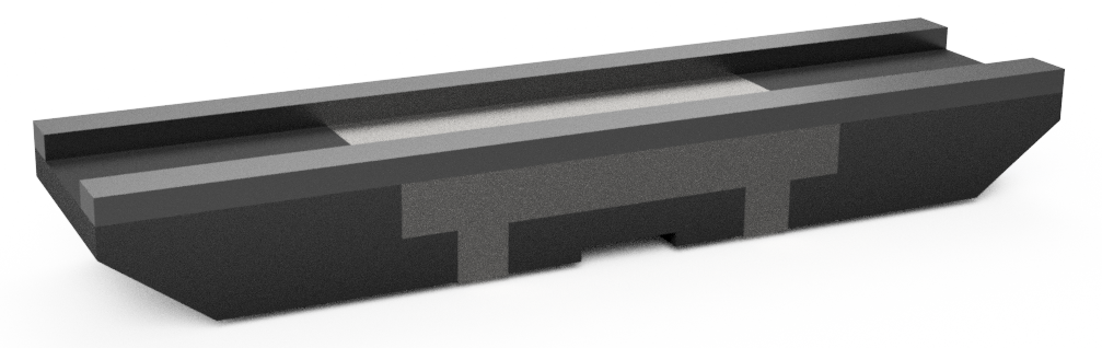

    These blocks of cast iron are the ones highlighted below.
    I have also scraped the main cast iron block.
    They're not perfect but within 0.03 mm. I am making the mold and getting the inserts ready, I plan to cast the column next week. Just trying to work out how to drill 18mm holes through the 2 inch cast iron blocks, my drill press isn't up to it and I really don't want to have to buy a mag drill, I don't know if anyone has any other ideas?

  4. #14
    Would the blocks fit on a lathe cross slide to drill the holes using a bit or boring head in the chuck?
    Or the other way around with the block rotating on a lathe face place and bit or boring head in the tailstock?

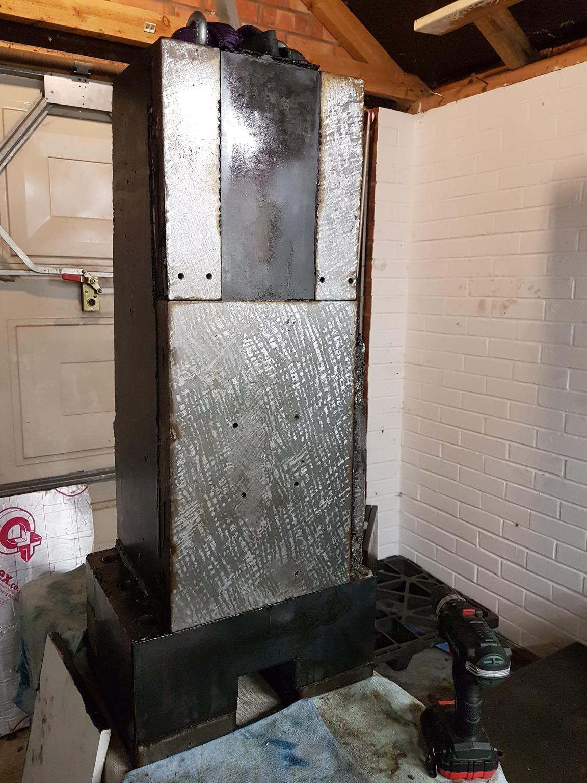

    Quick update
    That was a great idea with the lathe cross slide although I couldn't quite get it to work, having issues with its size. I ended up getting a mag drill... Drilled 60 holes and tapped for the insert bolts.
    Mould made and epoxy poured, all 150kg of it. Got it done in about 90 minutes with two of us. Had some slight issues, no vibration, we ran out of pigment towards the end and the mould blew out on one side. But overall went ok, if anyone wants more details on how to go about this I could write a more detailed post / video.

    It looks bigger out the mold

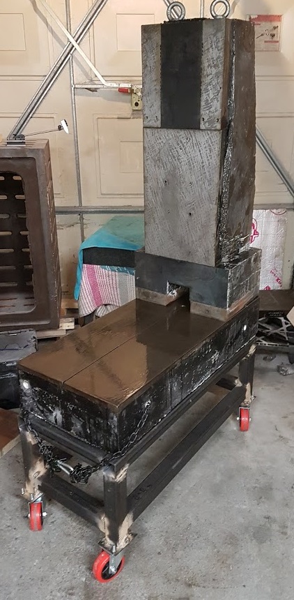

    I've made a temporary stand and put the column on the base
    I don't have a square big enough to see how perpendicular it is. Has anyone bought a granite square ? the only one I can find is this one
    https://www.zoro.co.uk/shop/measurin...MaAg9CEALw_wcB
    I have been making slow progress with the table, I have reduced the table width to 240 mm and I've got two ground 25x50x1000 mm bars to use as the rail mounts.
    The table "offcut" from reducing the table size width has been cut into four and scraped flat and parallel to act as spacers. I was starting to scrape the table flat but the carbide came off my scraper...

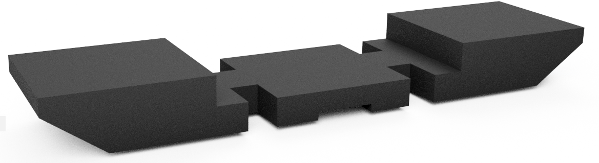

    I am slightly concerned that there isn't enough support under the steel bars and they will deflect. You can see this in the renders below, with the overhanging steel bars and the small amount supporting epoxy granite. I'm thinking about adding some threaded rod or increasing the thickness of the epoxy, i'm not sure if this is necessary though, thoughts on this?
