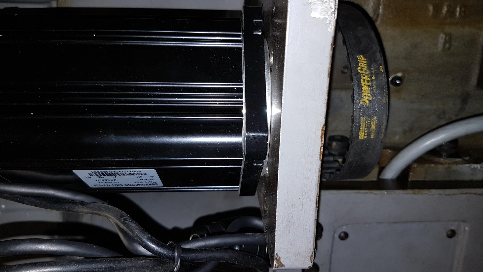

    Z axis mounting bracket part of head casting
    compared to motor front plate (note raised centre boss).
    AC servo in place, showing boss interfering with fit.

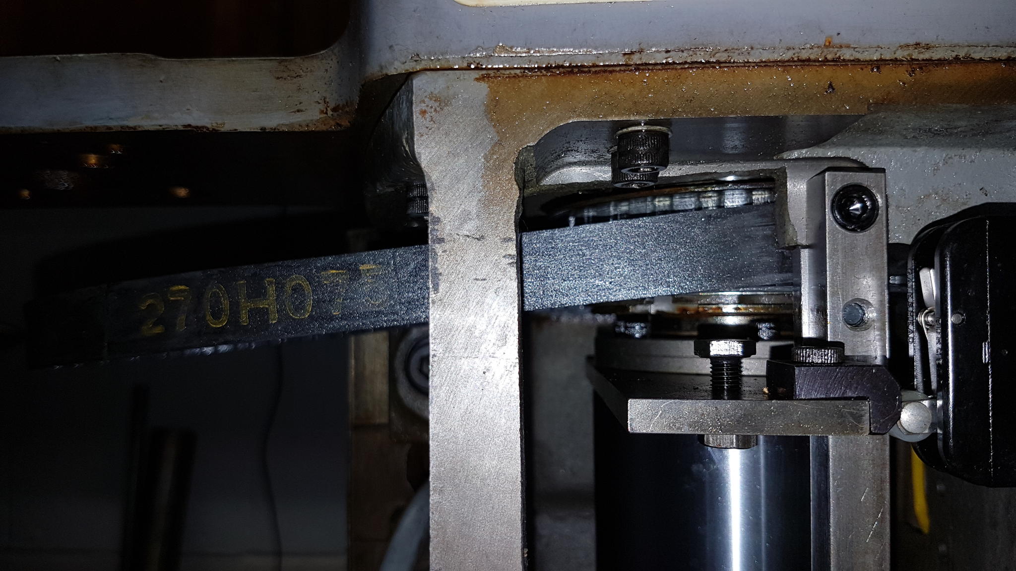

    Z axis pulley, above spindle ( looks a pig to change out)

    Thats the Z Pulley, not spindle pulley :-)
    How are you going to make up for the shorter shaft? Our machines look identical, apart from your slightly more powerful motors.
