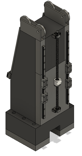

    Right so I've started on an large cast iron/EG mill build. Plan is to use several cast iron surface plates I have bought on ebay and embeded in epoxy granite, the hope is this will give me a flat surface to mount the linear rails to.
    This is the current design in fusion
ID:	24628Click image for larger version.
ID:	24630Click image for larger version.
    Travel: X 400mm, Y 250mm, Z 400mm
    Total weight 600-800kg
    Rails: 20mm hiwin clone rails
    Ball screws: Generic rolled Chinese ball screws, with a plan to upgrade in the future.
    Spindle: Initially: 2.2kw water cooled spindle. The plan would be to upgrade to a BT30 and 1.8kw servo from AliExpress if I can get this made and then integrate ATC
    Electronics: UC400 ETH, Initially steppers, with upgrade to 400W AC servos.
    Epoxy granite: Silimix 282 + west systems epoxy 105/206 10% by weight, 0.25% black iron oxide

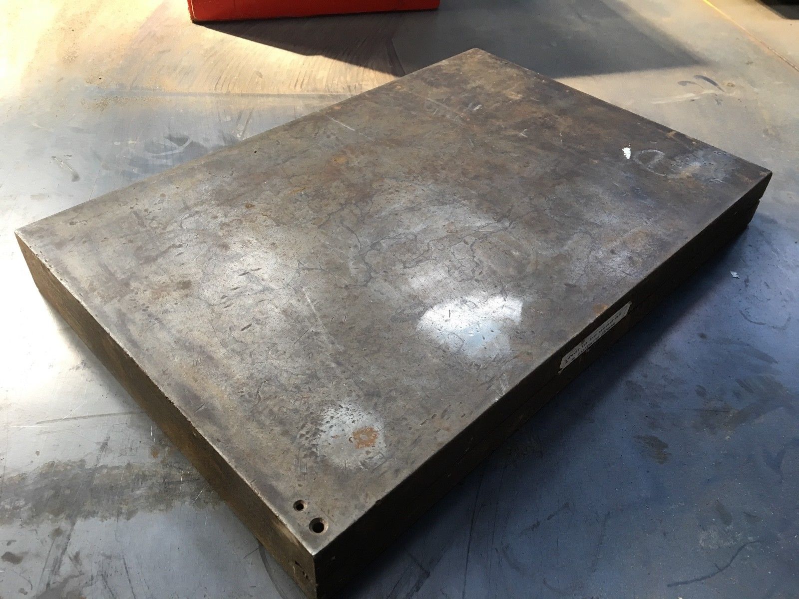

    Cast iron:
    I’ve got one 36 x 16 inch plate
    Along with four of these 18x12x2in plates
    The large surface plate is reasonably flat, however the smaller plates are out by about 0.05-0.15mm. I am planning on trying to hand scrape them flat.
    Issues:
    1. I have got to cut one of the cast iron plates into four for the column mounting blocks, I’m not sure how I will do this as they're 2 inch's thick, I think I will try with a cutting disc
    2. The column and table will consist of more than one cast iron piece, I’m not quite sure what the best way to keep alignment is, I think I will have to use a flat surface, possibly the big surface plate to cast against and an angle plate.
    I've got the epoxy and Silimix. I have made the mould for the base and I think I will cast this first to check that the epoxy granite doesn't warp the surface as it sets. I'll post back with the results!

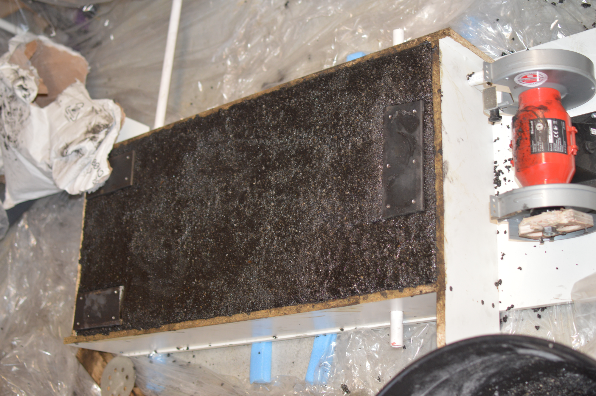

    Right so I’ve casted the base. I started by preparing the surface plate, I cleaned the underside with a wire wheel and then drilled and tapped several holes for M6 and M10 bolts, so the epoxy would anchor.
    The surface plate had a hole drilled in the top when I got it, I thought this might be helpful to run wiring/pipes through, so I routed some PVC pipe to the back of the surface plate. Before I decided to cast the surface plate in epoxy, I did briefly try and cut it, I sealed this cut with silicone. I also drilled two pairs of holes in each side and passed pvc pipe through, this will let me pass some chains through to lift it.
    The mould was made of melamine "furniture" board I got from wickes, sealed with silicone and then three applications of wax were applied (three was necessary in testing, it's a huge pain when it sticks). The surface plate was lowered with an engine crane face down into the mould.
    Mixing the epoxy granite was the hardest part, it took ages. We did it in 25kg batches, with one person packing the mould while the other used a hand held mixer. We also had a bench grinder attached to the mould, with an eccentric weight, but it quickly ripped itself free of its base. It took just under two hours in total and I managed to add some steel plate to act as mounting points later on and a small section of steel as a future motor mount.

    I let it cure for about 48 hours before removing the melamine mould.

    There are some areas that haven't fully combined and some air inclusion, this is worse on the side away from the bench grinder and I think related to poor vibration. But overall i'm fairly happy with how it turned out. As a very crude test, I've put a tenth indicator on a 30cm extension and jumped up and down over the base, I can't really get it to deflect. It weighs about 220kg now.
    I was also concerned that the curing epoxy would warp the surface, so I tried to map out the base with a indicator, there is very little movement (apart from the end I cut which shows about 2 thou of deviation). I also used a 2 foot straight edge, I can't pass a 0.02 mm feeler gauge under it. I don't think its warped significantly.
    Next step is to scrape all of the cast iron inserts for the column, I've started to do this, its slow work, but I think will be possible. I'm going to have to think of a way to level the end of the base, my surface plate isn't big enough so i'm not entirely sure how to do this?
