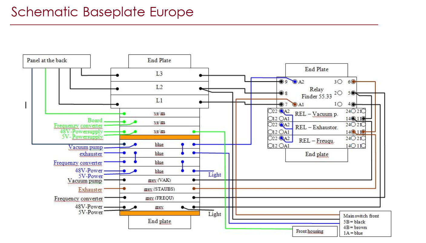

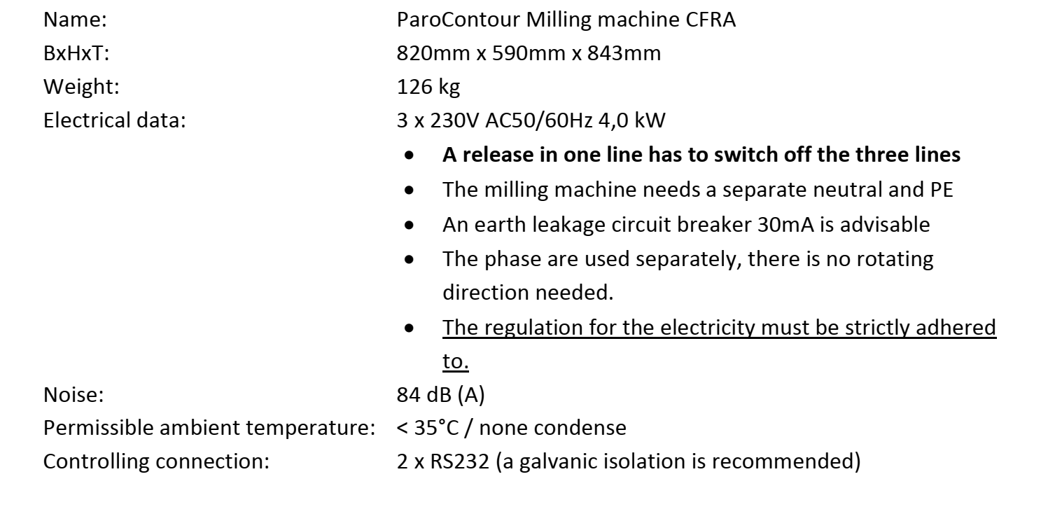

    Long story short,
    Snaffled a Mill, moving table with 2 axis gantry, Informed it was 3 phase also using an external vacuum pump and extraction. I may be able to get hold of the PC (running XP) that ran the system but all software is in German.
    Evidently, a reluctant somewhat difficult operator stated one day 'it started smoking' and it was abandoned and forgotten about (the person left the organisation shortly after) until a decision was made to dispose of it.
    No specs or decent manual and none forthcoming from manufacturer (I've checked)

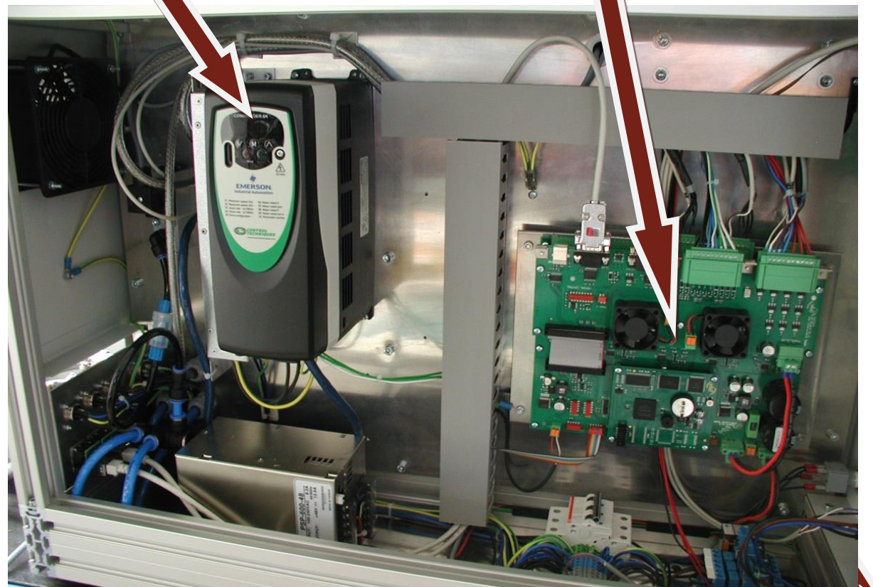

    At present I can reach through the underside and the spindle turns but the bearings don't feel good. I can see a stepper/servo and all axis are belt driven. I cannot open the 'user' door as without power the interlock is in operation. The mains cable has been hacked off and the remainder stuffed back through the grommet. I do not have any other cables.

    My questions are what can be deduced and what suggestions are forthcoming. I admit to having pretty serious wishes to get this machine running, either in this form or by cannibalization to reuse in a DIY Build.

    Some photos of the machine would help. Also a close up of that control board on the right. I'm going to guess it's a stepper driven machine, in which case the worst case scenario are a few new drivers, a new controller, and possibly a new VFD (can you get a photo of the label on the side of it?).
    Photo's I can get, as soon as I can rustle up the help to get it upright. I have just been told that the side it is sitting on can be removed which will give access to the VFD and main board. I will upload as many as appear worthy of inspection.
