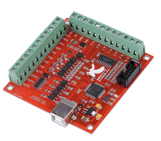

    The basic No-Name-Controller seems to work. I can jog the axes with the keyboard of my computer. The interface, that was build in, is of USB-Type (RnRMotionControlECO-V2.0 - is the driver). I tried to set up limit switches which should be connected to the 4 available inputs on the usb-board. Also the mushroom-emergency-switch at the controller-box is connected to an input of the usb-board with no effect. Regardless of what I do in setting the pins at the configuration section (Ports & Pins) - nothing works. At the diagnostic page the interface pins are shown but only 3 red lights are on which seem to represent the enabled 3 axes (so I can influence the lights by setting the enable of the axes on or off.

    Here the picture of the board:
    In the manual it says that you have to connect limit switches to the I1 - I4 inputs (as printed on the board - common to all switches is the "DCM"-called input ). In mach3 you then configure these inputs in such way that you define the input in relation to the axis - like I2 for X, I3 for Y and I4 for Z.
    Interesting enough - in mach3 these Input pins now have different names. As far as I found out I1 correlates to a pin 10, I2 correlates to pin 11, and so on. You can also configure in this section (Ports & Pins...) if you are using a NO or NC switch.
    Theoretically you can view your Input setting at the Diagnostics-page but nothing reflected there.
    So my general question:
    Has anybody experience with this kind of "Chinese Controller" and give me some guidance to get this machine up and running properly? For those who possibly can - be sure to be includes in my evening prayer!!
    novice

    The problem with lots of these cheap controllers, is they often only work with specific, often cracked, versions of Mach3.
    A google for bitsensor and mach brings up a few pages/videos you may want to have a look at.

    I have no experience with those Chinese controllers but I'm sure you could find on google the info you need. I think your only problem is assigning in mach3 the corresponding port and pin number for the input you need.
    If you suspect something wrong with the controller you could check at least that the input signal goes through the optocoupler.
    I don't think there is a problem with using a new mach3 licence with an older version of the software, the one recommended for the controller. Even in trial mode mach3 has full functionality except for limiting the g-code to 500 lines.

    Mach3 was designed to work with the parallel port. There the pins are straightforward, numbered from 1 to 17 and if there is one parallel port it is port 1.
    With the USB and ethernet controllers, the inputs and outputs need to be emulated so that mach3 thinks there's one or more parallel ports. Each controller manufacturer can assign what port and pins number they want to their inputs and outputs. For example the CSMIO IP-M controller uses the port 10 in mach3, if I remember well.
    edit: So the manufacturer should provide for each input and output the corresponding pin and port to be assigned in mach3.

    Hi paulus.v,
    have checked the couplers - working fine. 24 Volts the input swing, 5 V the output swing. Detected with mach3 a page where the USB-Contoller is checked. Shows, besides other things, the behaviour of the inputs of the USB-Board. There you can see the switches work!?
    Now whats preventing mach3 not to read this!?
    Maybe I contact the mach3-provider?
    A baffled novice
