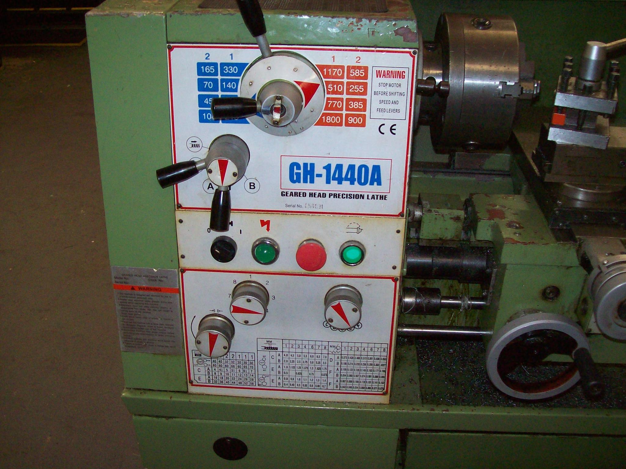

    Hi i was wondering if anyone has a working invertor that would power a Dual Speed motor on a manual Lathe.
    The lathe is a Chinese lathe with the following details on the motor. as you can see it is at 2.4 Kw on high speed so i would think that is is a differt type of invertor as this motor is a Dual speed motor.
    Series Multispeed Three Phase Asyncronous Motor fitted to a Manual Lathe
    Type YD112M-8/4 –TH
    INS.CL= B
    Connection Δ/2Y
    1.5 /2.4 Kw
    4.6- 4.9 A Rating: S1
    50 Hz
    Rpm 700/1410
    415 V
    IP 44/46
    Capacity 2KVA
    if anyone has any Ideas i would appreciate this.

    Be careful - that's a 415V motor, not a 240V motor that the usual invertors will drive directly. You need a rather different invertor to run a 415V three-phase motor from a 240V single-phase supply as it needs the capability to increase voltage. Possibly something like this.
    Some dual speed motors are just not suited to inverters, check if anyone else - Google search - has converted the make & model you have.
    It may be cheaper and quicker to re-motor and vfd at the same time.
    You say that the motor can be wired up in star and delta but you only list 415v, this will be a dual voltage motor, what is the voltage? If it isn't 220v three phase then you won't be able to use a vfd. Can you take a photo of the motor data plate?

    Hi all the Dual speed motor is as previously said a 2.4Kw motor so would require at least a 3HP invertor but this would only power light use. So i would require in my opinion a 5HP invertor and the invertor would have to be a dual stage invertor which as some of you have already said are not the normal invertors that would power a dual voltage motor.
    Dual speed motors require different invertors this is why i have asked if anyone on here knows or has something to offer me.
    This is the motors plate: Type YD112M-8/4 –TH
    INS.CL= B
    Connection Δ/2Y
    1.5 / 2.4 Kw
    50 Hz
    Rpm 700/1410
    415 V
    IP 44/46
    Capacity 2KVA
    A 240V to 415V Digital phase invertor is the way forward so i ask that if anyone has a second hand unit that is working i would appreciate the help.
