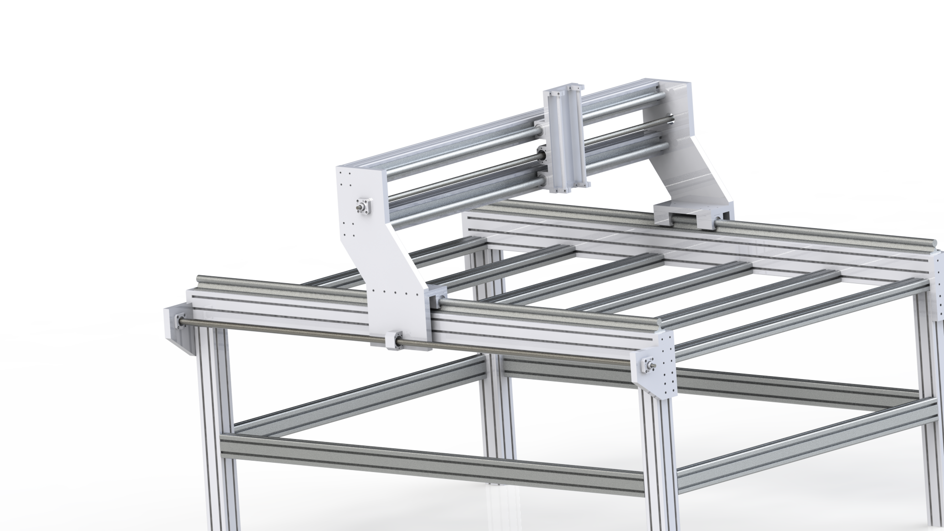

    So we are building a CNC Router.
    And i am in the designing phase
    The machine should primarily cut wood, but should be able to handle aluminium at a decent speed.
    Electronics (had this from an earlier project)
    Nema 23, 420 oz steppers 2 for the x axis and 1 for y and 1 for z with
    Gecko 540 drive.
    UC100
    Spindle
    2.2kw watercooled chineese thing from cnc4you.co.uk //thank you Clive S
    Frame
    Supported x side would consist of 120x80 mm aluprofiles
    Legs will be 80x80 alu profiles

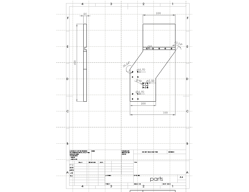

    The gantry is where i have a few isssues i dont wanna make it to complexm i am considering adding another 80x80 profile so that it will be 80x240
    Linier motion
    sbr25 supported round rails for y and x
    For z (400-500mm) I am considering square rails or the round unsupported since I have been told on another forum that the sbr may not be the best for Z
    I have chosen the round rails due to the cost and from what I can figure out it has an accuracy of 0.01 mm over 1-2 meters.
    rm2010 ballscrews for x and y
    rm1605 ballscrews for z
    A lot of people have advised rack and pinion but to me, it seems a more complex solution with a lot of issues,
    I dont have a reason really other than I am in love with ballscrews (i know about whipping)
    I have also been advised to move the ballscrew up so it is a little higher up than the sacrificial plate.

    For the CNC build, I am switching the round rails with squares( i got a good offer)
    ill place it on the side of the build, and I will probable add the ballscrews at the same place as the sbr25 on the y-axis.
    I will make the ballscrew fixed in both ends which should give me a theoretical speed of 1000pm before it starts to whip.
    2,7*10^8 * (1x15) / 2000^2 = 1012.5
    ill post a new design tomorrow.
