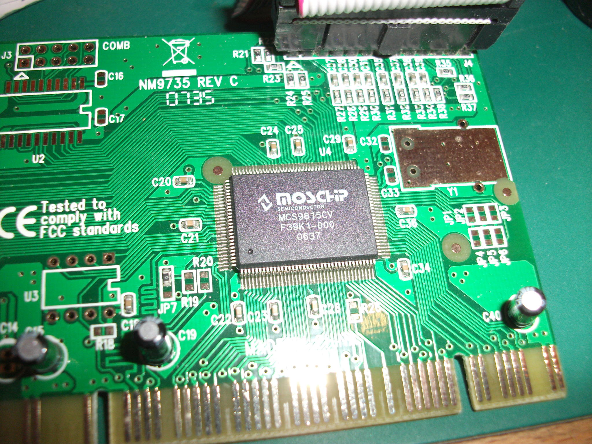

    Right, I found a driver and downloaded it. It came with a thing called driverupdater or something. Alas, I couldn't install the driver as driverupdater wanted the internet and my mill pc isnt connected so it simply would not install. I got the driver from elsewhere, and again, it came with driverupdater, and as such, wouldnt install without the internet. Bum
  13. #8
    Is this the chip on your printer port board ?Click image for larger version.
    If so your printer driver is here https://www.dropbox.com/sh/fjwgmfaue...sFt6cGSta?dl=0 You will have to copy the files to a memory stick and run the Moschip setup program form the stick.
  14. #9
    Hi Cropwell.
    I'm afraid not. the chip has no logo on it, just the aforementioned number and some other numbers. Such as: CH350L, 202205221, CH352PA5@1012, and 0413.
    This is just for a driver, hahaha, before I even make a vague attempt at settings etc
    Those stand alone controllers are looking really good about now, lol.
