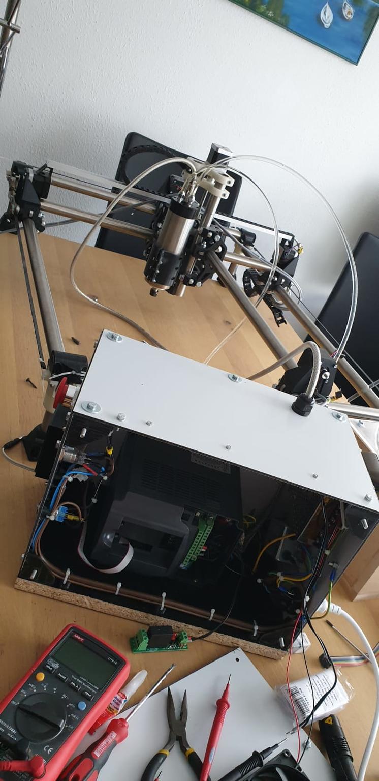

    Hi, I built my first CNC Router (just a "lousy" MPCNC :)) and got a 0,8kw Chinaspindle and Huanyang VFD2,2kw.
    I created a Waterpump solution using 12V supply.
    I would like to only turn the pump on, when the spindle runs. Therefore I wanted to use the DRV/UPF/DCM connectors switching an external Relay on. I already programmed PD050 and PD051 to "1" but I cannot measure anything between these two ports (no matter if spindle is on or off).
    Now I dont have any clue how I could use these 3 ports for this action?
    The FA/FB/FC Terminals are already used to switch the CNC off by error.

    The Relay with FA/FB/FC is already in use as an emergency off for the cnc control (motors eg.). Therefore I have to use somehow these Optocouplers.
    As you have only one possibility to program FA FB FC, you cant use two functions with it. When I program it to switch only with an error, then the pump will run always except an error occurs. The plan was to switch the pump on, when the spindle starts.

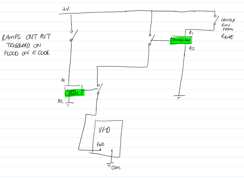

    Not difficult to do.
    You could run a relay from your controller, activated on M8 (flood) or M7 (mist) G Code, that then enables the Coolant pump but then runs through another relay which is triggered by the Spindle Run command (For your spindle). I do the same for my CNC Lathe but dont care about spindle status.
    Get yourself some 24V relays and drive the logic from your controller. What control option are you using?
