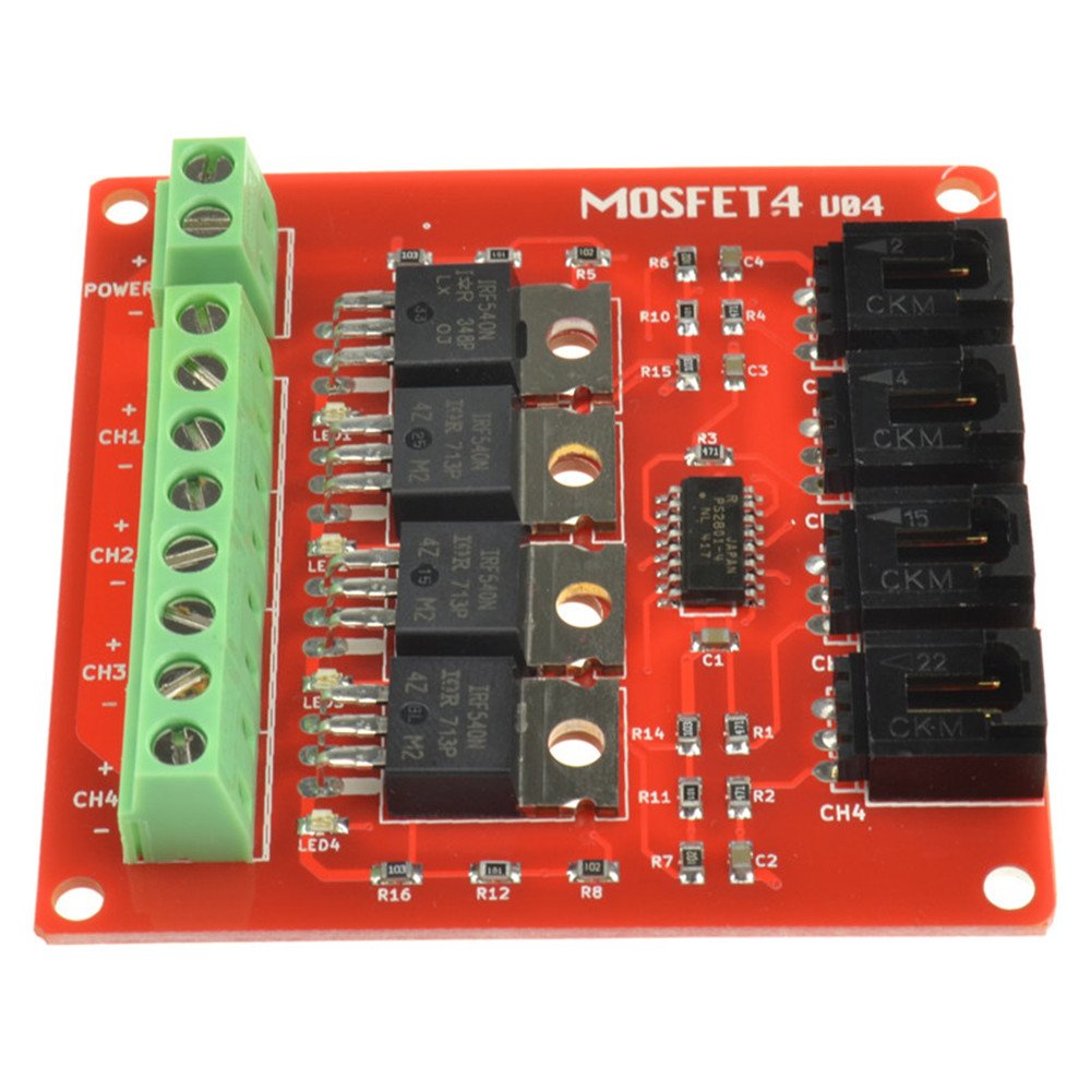

    I have had a quick look at the various arduino boards available
    this looks like a ready made you can use (amazon are out of stock but it appears to on sale from ebay )
    https://www.amazon.co.uk/d/Wall-Sock...ino/B01MRQFYJN
    hi res readable picture from amazon advert
    the small 16 pin IC is a quad opto isolator - part number PS2801-4

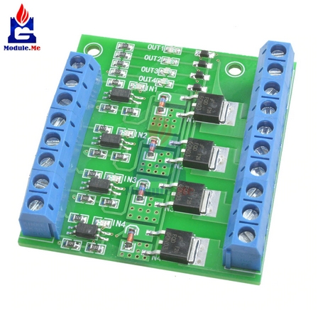

    another possible board
    https://ja.aliexpress.com/item/32748...3-954e0244d34d
Name:	4ch opto-isolated switch.jpg

    Wouldn't a relay board be easier?

    Cheers guys, I really appreciate the help. I went ahead and used my mosfets and soldered it up in the sun yesterday...boy it was hot!!
    Anyway...its all sorted now although the red switches are very bright
    Cheers again...my machine will hopefully be finished this year!

    the relay board is a simple alternative to using transistors that some will prefer
    ( as always the best solution is the one that works for you )
    the relay board has the advantage the outputs can be wired to either have a common +24V or common 0V / ground connection
    Charlie
    great result
    do you have the option to use 28V bulbs in the switches ?
    under run 28V bulbs will last longer
    an alternative would be to add a resistor in series with the bulb
    if the bulb takes 40 mA a 100 ohm resistor would drop the voltage by 4 V
    john
