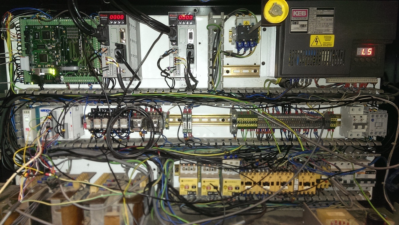

    To give an idea of how good trunking is, here's a couple pics from my lathes cabinet during it's retro -
