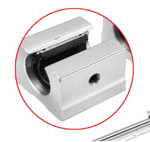

    Yea you could remove the seals from the SBR bearing units, first though have you checked the little grub screws on each unit to make sure they haven't been over tightened, these allow you to take up slack in the bearing fit and if you go to far it starts to bind.
    Just find the sweet spot and then keep checking regularly as part of maintenance for this rail system, use oil after the wipe down.
    You can see what I mean in the pic below.

    My bearing block is double length, two cartridges.
    The interference is starting after moving it along fast, as if rubber catches the rail and bends in introducing friction. It is a medium sized laser cutter, not much load, but i need it as "freewheeling" as possible. The gantry is moved by nema17 motor, so any interference is not good.
    I have "exercised" the bearing a bit by moving it by hand, it loosened some. Torqued the retaining set screws etc. For now its good, but i just want to know what happens if i remove/cut grease seals.

    Hiya, yea just found your other thread about rebuilding it (Rebuilding terribly engineered laser cutter) so got a better idea what your dealing with now...
    You can't take the rubber seals out as they keep the balls retained but you could trim the outer most part that is bending, the bit that rides the rail and stops swaf getting in.
    Non of the ones I've handled had this problem and I've handled quite a few!, I'm wondering if they've used the wrong size rail and that's the real problem, can you mic the rail and get a proper dimension off it ?
    If you look at the rubber seal on the ends of the bearings (where the snap ring lives) it should give you the sizing, something like SBR12UU.
    They may have done something stupid like used 12mm bearings with 1/2" rail... I could be wrong.
