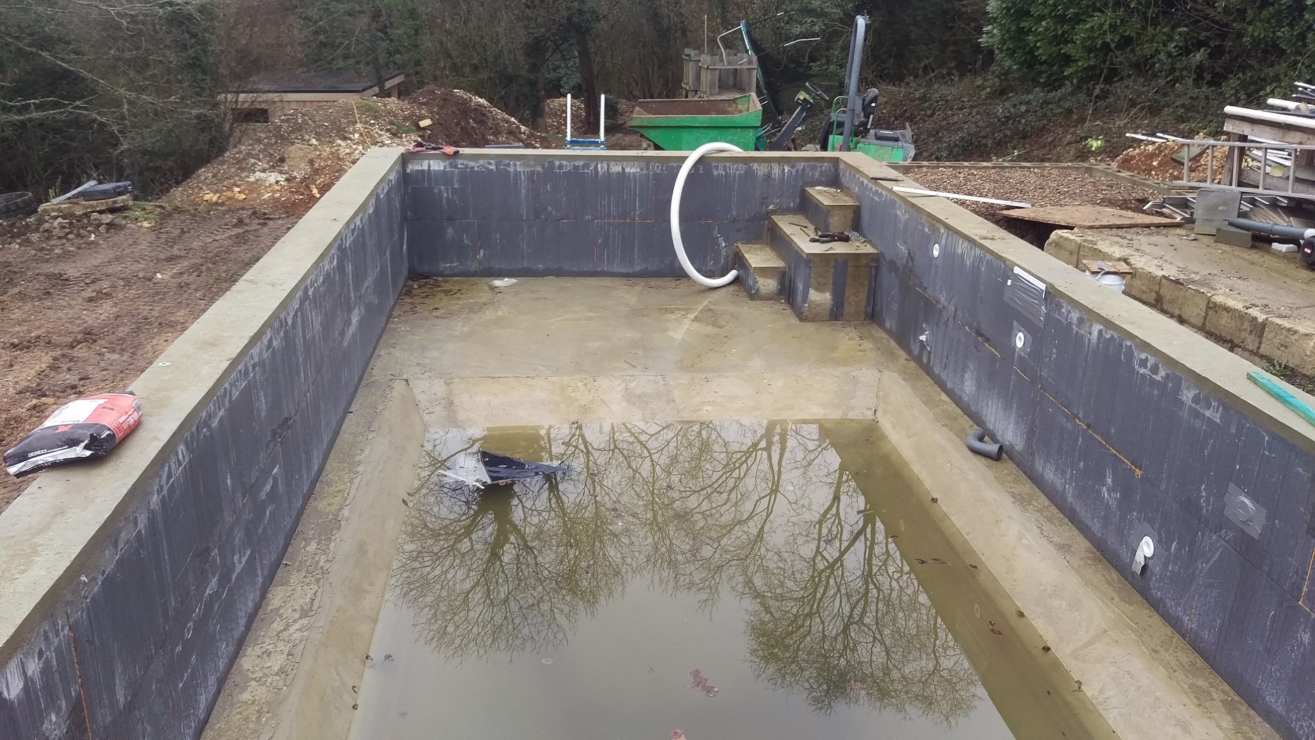

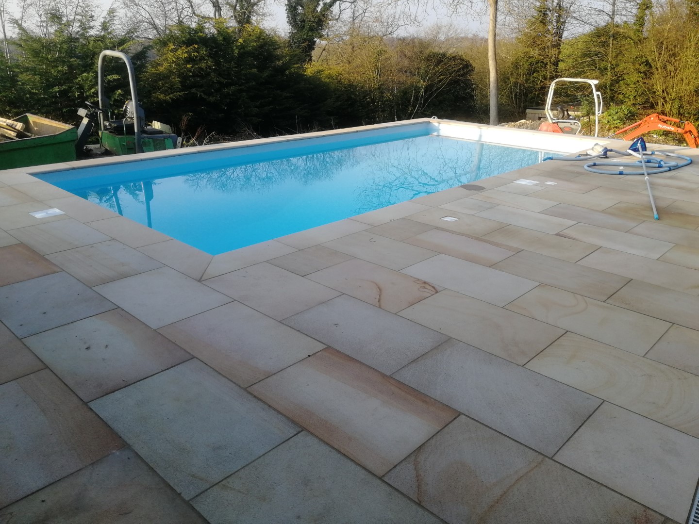

    LOL, my swimming pool is within 2-3mm when full and I used a cheap dewalt laser when I pumped the concrete for that, your eyeball can tell 4" at the length of the pool. Anyway you are confusing the pendulum laser alignment error with the optical error, quite different things, surveyors only care about the former. Similarly a window fitter, specifically someone who fits bespoke bi-folds will have a laser scanner for scanning the openings as the units are manufactured to fit.

    Still would have required some shimming to attach linear rails rather than sandstone ;-)
