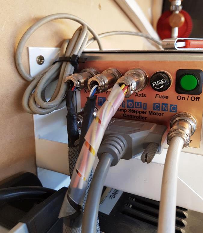

    Here are the pictures, the first is the controller and the second is the VFD I want to control. There is a second parallel port on the computer so I was wanting to control the spindle through that.

    Hi Virgin,
    Ok well first you say the machine is working so would guess you have some type of breakout board already.? If you are not sure then you need to take pictures of the control box so we can see what you have.
    Plain Vanilla 4-Axis control only with Home, Limit and E-Stop inputs using the PC's onboard PP (I added the 4th to the 3-axis box)
    The PC has a second PP.
    He wants to add On/Off/RPM control using the second PP.
    Right then, it appears I will need a couple of things. I will need a project box for all the bits. A parallel cable to run from the Computer to the Project box, this in turn will connect to the Break Out Board. The Break Out Board will send a signal to the Controller Board I have and as m_c has said above the Controller board itself will need a 24volt supply which I can incorporate into the project box.
    I spoke to Nick today about this and he also thought a relay might be required on the BOB if I want to control on/off of the spindle. So, all things being equal, does anyone have any suggestions as to which BOB I should buy? Ideally dual function because I could also use the board to turn the coolant on and off, maybe, perhaps? And will I need a power supply to the Break Out Board?
    Thanks in advance.
    Lives in East Lothian, United Kingdom. Last Activity: 9 Hours Ago Forum Superstar, has done so much to help others, they deserve a medal. Has been a member for 9-10 years. Has a total post count of 2,910. Received thanks 360 times, giving thanks to others 8 times.
    In all honesty, I would probably say get one of the cheap 5-axis BOBs off ebay.
    They've got a relay output, and a 0-10V output, along with extra inputs and outputs.
    You'll need to wire in a 12-24VDC for the 0-10V output to work, and IIRC you need to connect the USB (or the 5V to the relevant terminals) to power the optos.
    Just search on eBay for "5 axis breakout", and you'll get plenty options.
    And you'll also need a straight through parallel cable to go with it (at least I think it's a straight through that you need, I've never actually used a parallel port for CNC!)
