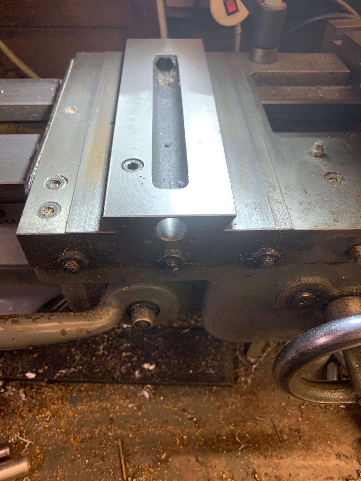

    I'm a little confused now with what I actually have. I fear a Frankenmyford (remember, it was one of the last ML7s off the production line, according to the serial numbers on lathes.co.uk)
    The link to the conversion site that John provided at the head of this thread (bottom of https://cncyourmyford.com/modifications-needed/), suggests the extra bolt-hole on the left of the saddle is that of a Super-7 saddle, not the ML7. And the bore for the cross feed screw is 1/2"
