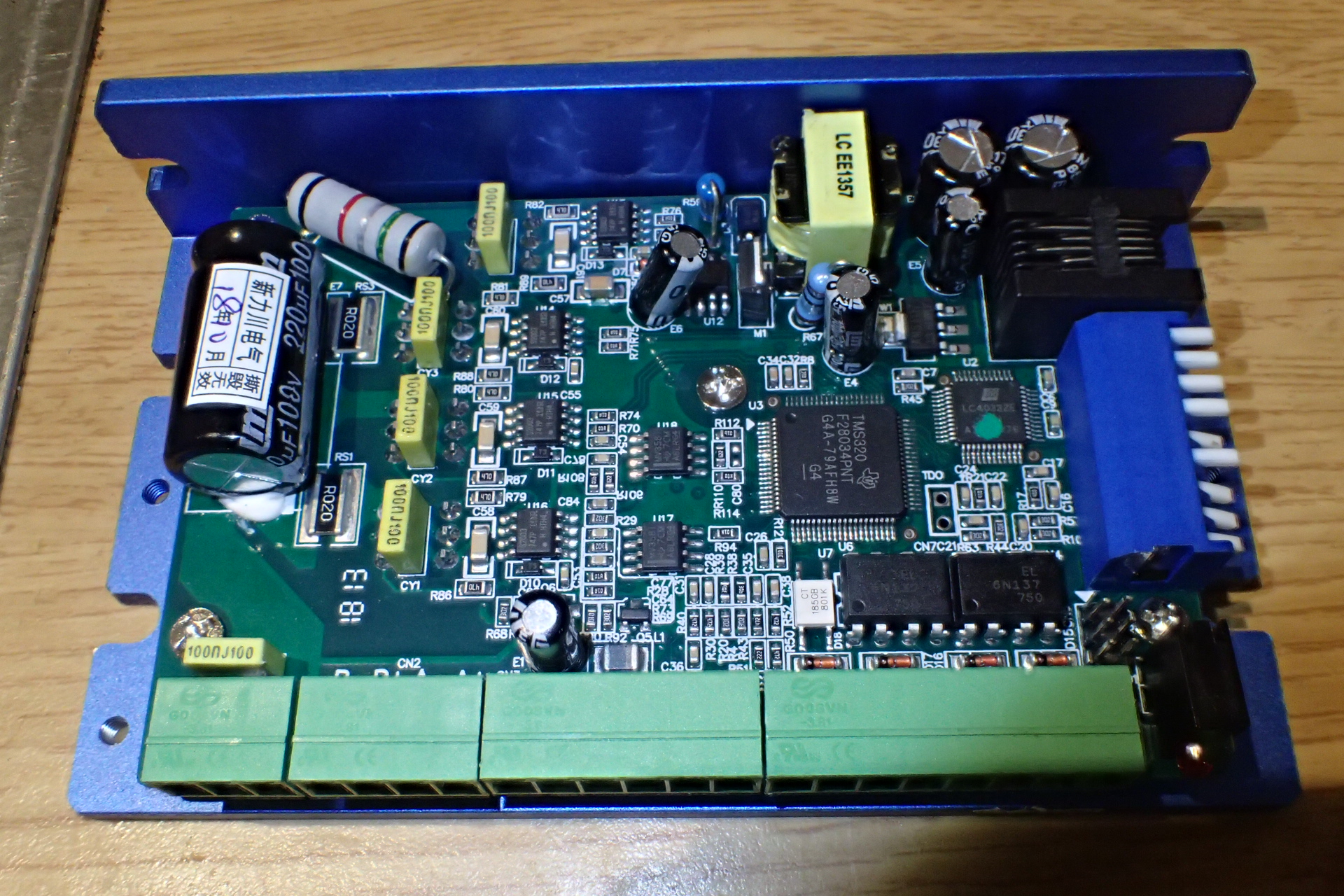

    Just wondering if anyone has any knowledge of these please as I'm not getting a reply to my question from the factory.... There's an "alarm" output on the LCDA2575 driver module - does anyone know what this does in terms of function i.e. when it switches, and what is the max voltage it can switch? I have a data sheet which came with the motors, but it makes very little mention of this output.
    http://www.t2cnc.hu/downloads/Lichua...r%20Manual.pdf suggests the output is simply the C/E of an optocoupler. Without knowledge of the part number of the opto you could make an educated guess based on common devices - most seem to have a Vceo of 60V upwards.

    I'd probably go for 24VDC and 20mA being a safe limit.
    And given it's very likely a Leadshine copy/clone, and having checked some similar Leadshine drives, their usual output is 24VDC but with current limits varying between 20-80mA.

    Looking inside I can see a little white (hence likely an opto) 4 pin device adjacent the pins, but like most SMD's it doesn't have the device number, just some cryptic code on it
    24V/20ma is a good guess, but there's still the issue of what does it indicate....

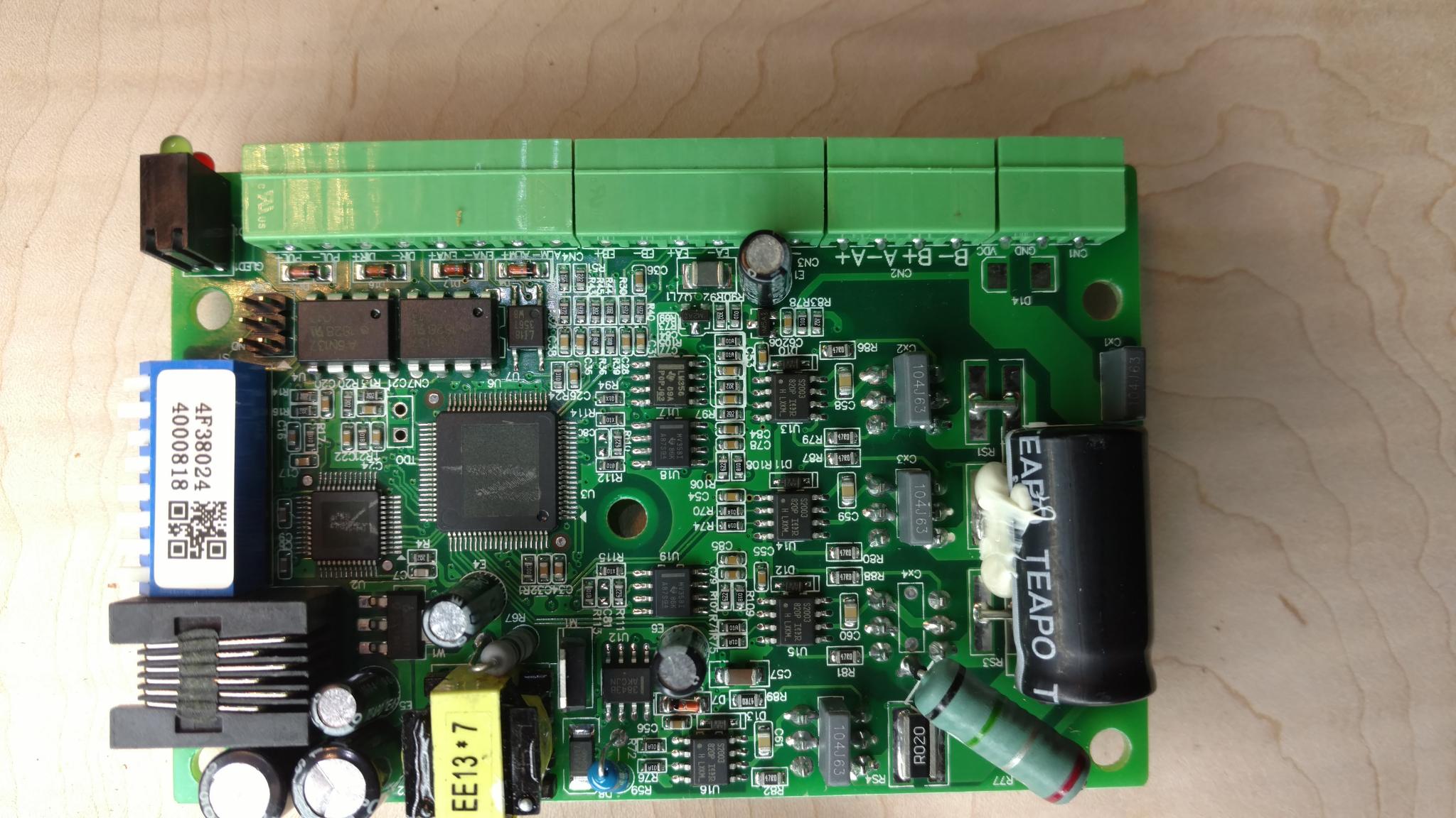

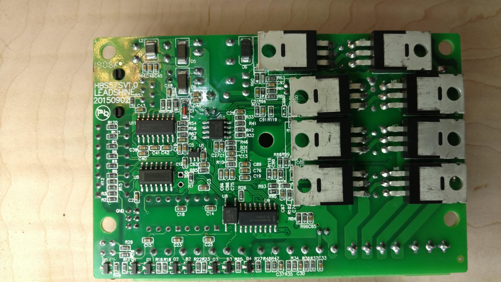

    Well, by chance I came across this page:
    https://www.omc-stepperonline.com/cl...tor-cl57t.html
    These drivers seem to be mechanically and electrically identical to the LIchuan parts other than the paint colour, branding and slightly smaller supply voltage range - if anyone has one of these it would be interesting to remove the cover and compare the PCB with the Lichuan part, I have a suspicion that they will be very similar knowing how things happen in China!. And there's a manual full of all sorts of good info you can download, and which has a very interesting typo in the last paragraph of page 5

    Hi Voicecoil
    The cl57t run with up to 8 amps. I think they are made by leadshine. I have 3 on order at the present time. I'll pop one open when they arrive if it's not to difficult and post a photo.
    cheers
    Andrew by the way if you order these as kits don't forget they come with cables, I didn't notice that and ordered some cables from their Belgian site. Oh well i'm sure i'll find a use for the wire or plugs
