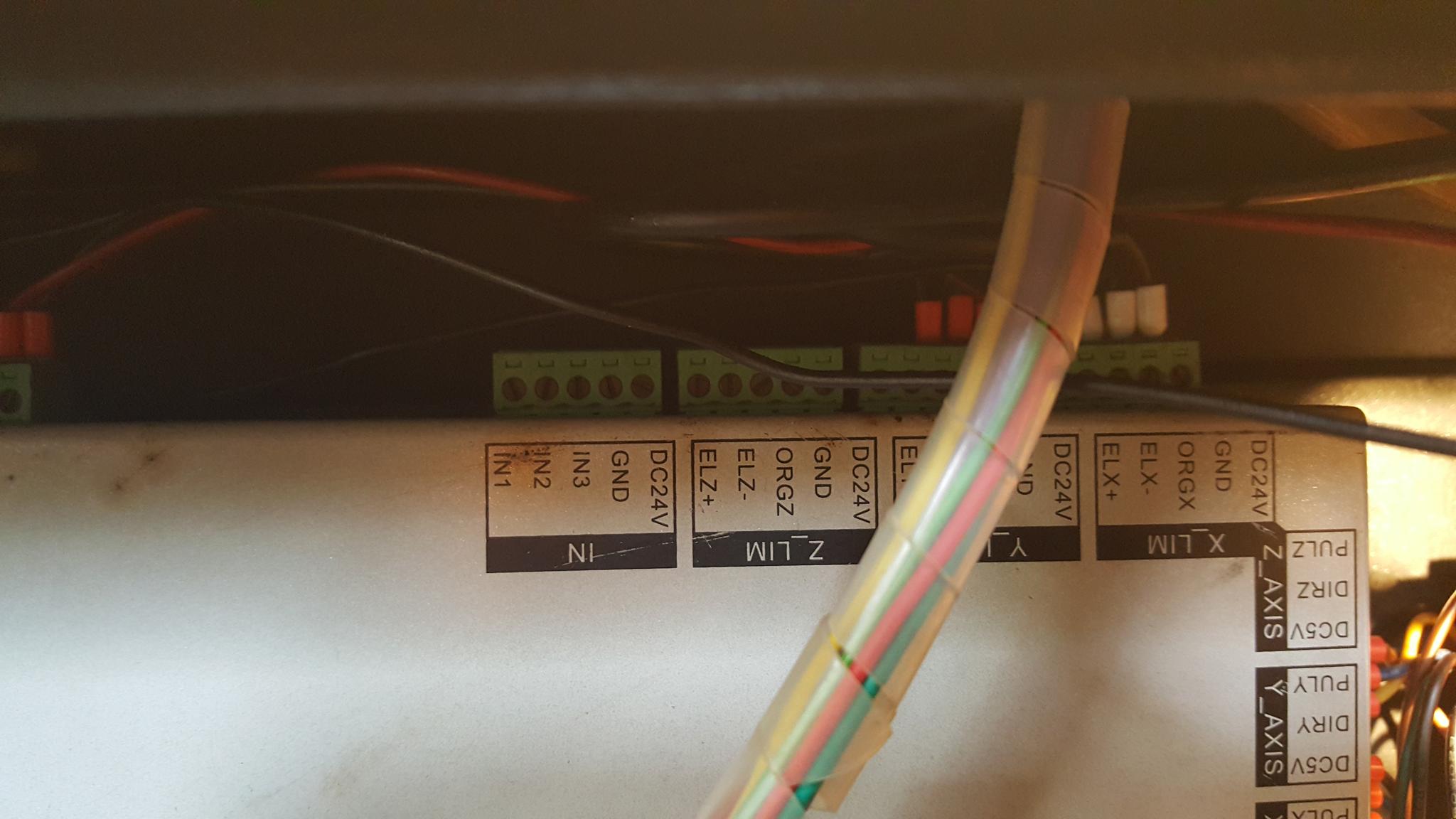

    However, an error message appeared on the control panel..."WATER PROTECR IS EFFECTIVE"
    I checked the pipes from the chiller for kinks and made sure the water was flowing round the tube which
    it does well.
    I checked the cable from the chiller to the machine and it has continuity.
    I see no water sensor on the machine !
    I can download files for contouring from the laptop but not set the laser to fire from the laptop and if I do try it ceases to let me download files unless I shut the software and re-open it.

    A quick google has found a manual for that controller - http://www.leetro.com/english/down/p...%20En-V1.3.pdf
    By the look of fit, the manual example wiring diagram shows the water protection (pin 3 on the input connector) as just being connected to ground. I'm guessing Redsail have added some kind of switch (low water level?) somewhere. It should just be a case of following wiring, to see what has been connected. Or maybe first add a temporary jumper wire at the connector to see if the fault clears, before investigating what the real problem is.

    The connector on the controller.
    This manual has a nice picture on the front cover that shows the connectors - http://www.rabbitlaserusa.com/Manual...wareManual.pdf
    By the looks of it, it's the terminal marked IN3.

    I have just followed your advice and looking at the controller there were no wires at all in that area at all which i thought was strange as it had worked previously a year ago.
    This morning I put in the jump wire as suggested and now the error message has stopped and the control panel is now unlocked.
    I have just downloaded a simple file and everything worked fine.
    Apart from needing a new tube all is working well.
    should I be happy with that or do you think I need to investigate further ?

    As long as it's working, I wouldn't worry about it.
    If it's previously worked like that, I'd guess there is probably a setting buried in the software somewhere to disable the water protection.
