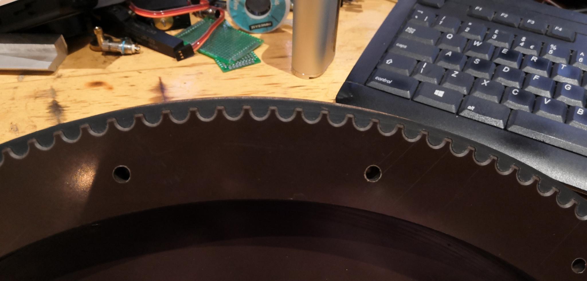

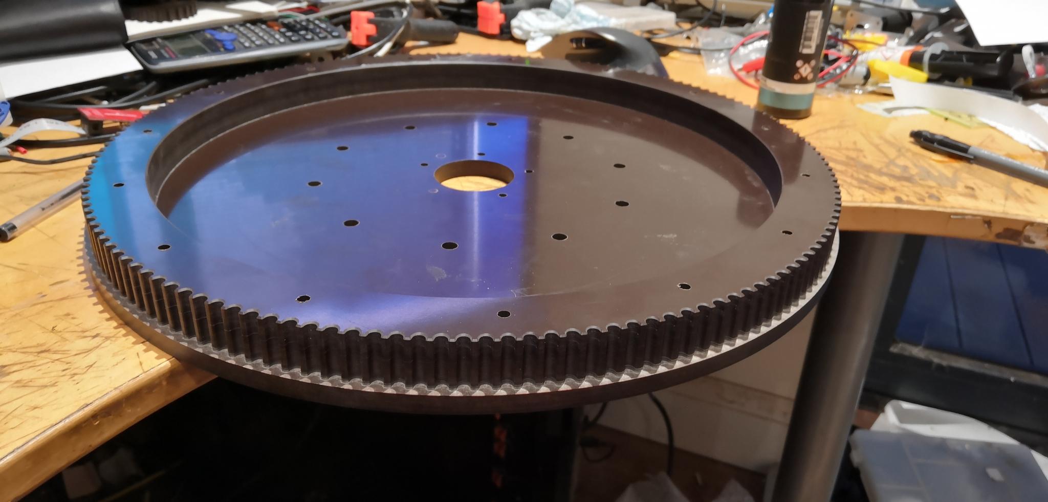

Now I have a question for you pulley experts. I need to make a very large 157 tooth 8m timing pulley ring that will be fitted to the perimeter of a winch drum. The pulley needs to be made of a ring of material ~25mm thick with an outer diameter of 400mm and inner of 340mm. It could be made from aluminium, SRBP, delrin or even hdpe.
Trouble is I don't want to waste a large piece of material just to make the ring, any ideas? I've even considered casting a blank in aluminium but I don't have a foundry. Are there any castable machineable urethanes that are strong enough for timing belt pulley teeth?

I use a free command line dxf generator that can generate all of the main timing pulley profiles, super simple.
I just cut an 8m test pulley in 10mm SRBP P1, if came out very nice and extremely strong teeth. I think I will use this material and laminate a few layers together then bolt through, it is pretty cheap stuff and locally available to me.

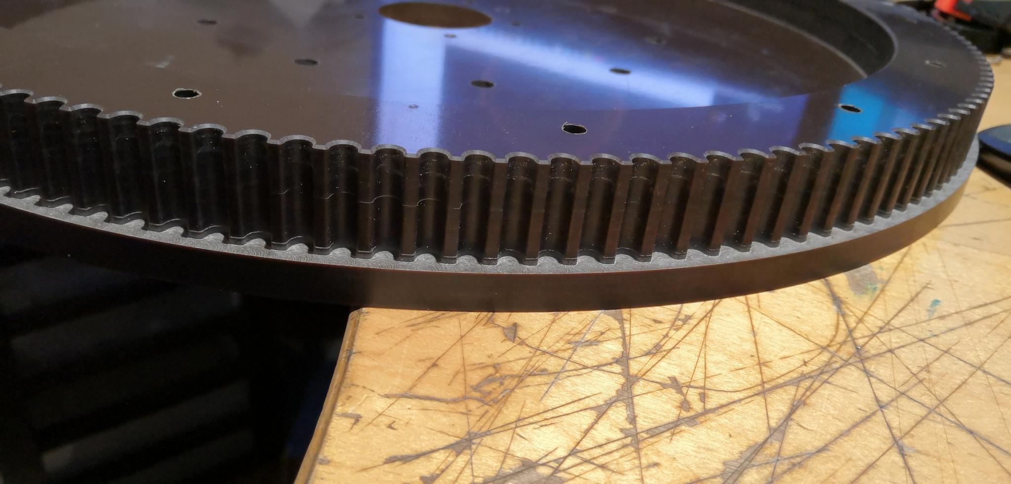

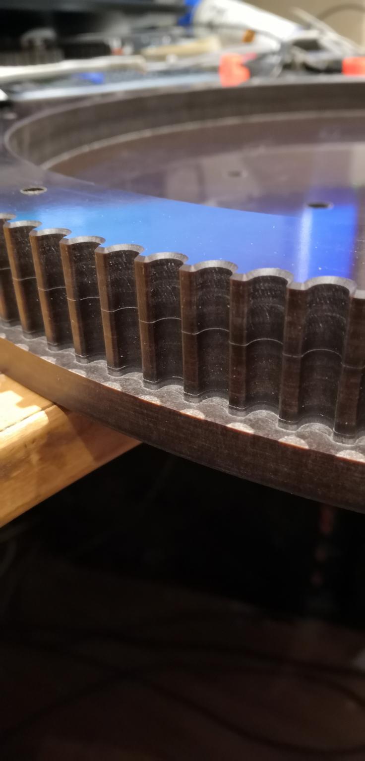

I made the large timing pulley I was proposing today, it is a 157 tooth HTD 8M (20mm belt) for a project, pulley is ~400mm diameter. It was made from 10mm SBRP with 3 laminations at the rim. Turned out fantastic. I used screwfix cyano to laminate, this makes a very strong joint which you cannot get apart. It will never the less be reinforced with a ring of M5 bolts.
