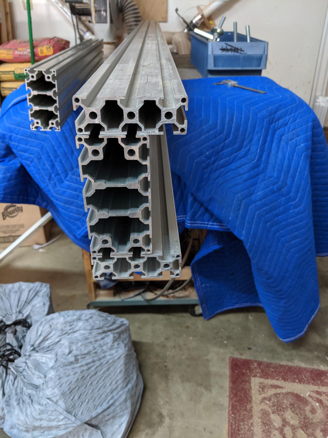

    I am beginning to plan my CNC router build and have a few questions about my gantry design.
    First all, I came across a large lot of 60x60, 60x120, 30x90, and 30x60 extruded aluminum that I will be building the machine frame from. I also sourced a 1" 6061 T6 aluminum plate which I will be machining for supports, plates, etc. I plan on building a machine with a cutting area of 1850mm x 1250mm.
    I did some math for the gantry, with the 60x120 extrusions, 68kg load in the center, and the span being about 1250mm, it will sag about .14mm. So I think that will be unacceptable and I want to stiffen it some without buying additional extrusions. So I was wondering how do I calculate the sag if I attach pieces to the tops and bottom of the 60x120 and make it a C shape (attached image)? So I will place a 30x90 on the top and bottom of the 60x120.
    Also, are there cons of placing linear rails on the top and bottom faces of the gantry? Or should I stick with the side the z axis will be on? I am just thinking about how I will fasten these 30x90 extrusions to the 60x120s.
    I look forward to this build and sharing my progress with everyone :)
    Thanks for the feedback!

    routercnc shared a fantastic spreadsheet in the following thread; it can calculate the sag of some simple geometries, you might have some fun with the more complex profiles but take a look anyway.
    http://www.mycncuk.com/threads/2023-...ign-principles
    Pros of placing the rails on the same face as Z are that the Z axis is a lot simpler to construct - you only have to have a single plate to connect the Y and Z carriages.
    Con is that you increase the distance from your cutting bit to the gantry, which increases the rotational force around the gantry causing more deflection.
    JoeHarris' build has a good description of how he joined the profiles in the way you're looking to do by using shims and then drilling and bolting through the extrusions.

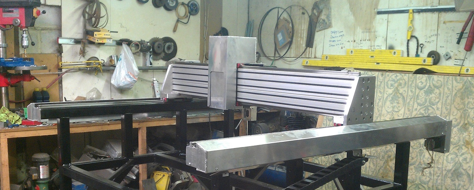

    I've built in excess of 30 machines ranging from 2 x 2 to 10 x 5 using L shape gantry system and I can tell you 100% confidence that 2 x 120 x 60 arranged in L shape (not C) will easily handle 68Kg at this size.
    Here's one using 120 x 80 at 1800mm length. with 28Kg Z-axis and doesn't even know it's there.

    Jazz,
    There are lots of different profiles out there of differing cross section and strength at the same outer dimensions. Can you give us some details of the profile you use, especially the weight per metre? This would allow a reasonable comparison between manufacturers.
    Kit
    Jazz,
    Kit
    Yes, no problem. I use 2 different types equivalent to ITEM and Bosch Rexroth profiles depending on machine size.
    On the smaller machines,(up to 1000mm width) I use Bosch Rexroth equivalent 45x90 with a 10mm slot. 4.2Kg/M
    The reason I use this type is that the slot spacing just happens to match the bolt spacing of BK12 bearings so it makes fastening easy.
    On the wider machines, I use ITEM 120 x 80 (10.8kg/m) or 160 x 80 (13.5kg/m) with an 8mm slot. This does mean plates have to be made for mounting Bk bearings.
    I prefer the 8mm slot because gives a more flat area for the linear rails to sit on when using 20mm rails The BR 10mm slot doesn't leave a lot of room spare.
