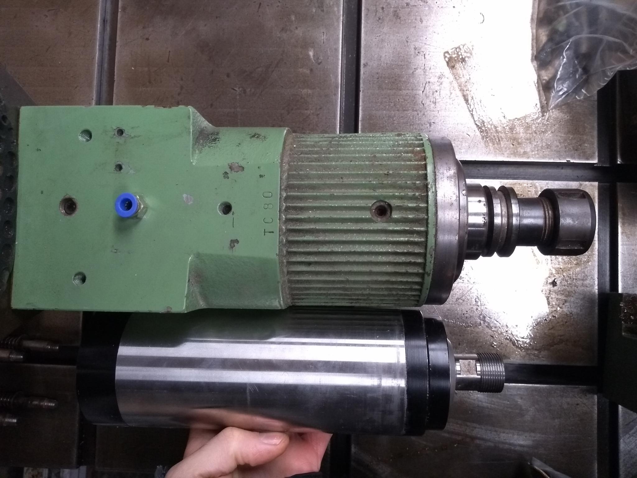

    I'm not the expert here but that 2.2Kw (3HP) motor weighs 22Kg before you add the rest of the gear you need to drive the spindle. Most of us here use a Chinese water cooled 2.2Kw spindle that is somewhat lighter and runs up to 24,000 rpm without the complexity of a pulley system and separate spindle. BST Automation (owned by the unlikely named 'Fred') is a well regarded supplier. This link shows you the package...
    This spindle includes an ER20 collet chuck which will hold (if you buy a separate set of standard ER20 collets) any tool sized from 1mm to 13mm.

    Hi Kitwn, I've got a couple of machines with those spindles (a 2.2kW and a 3.0kW), and this time around I fancied doing it a bit differently. In my experience those spindles work well up to a 6mm cutter in aluminium, but not much further.

    Full disclosure, I do have the spindle I intend to use already - if it proves a massive mistake I can swap on a different spindle later with minimal fuss. Hopefully the picture makes the point (I tried to keep the perspective fair) - it's obviously much bigger than a basic 2.2kW Chinese jobby, but not that big...80mm vs. ~110mm...so also a bit bigger than a basic 3.0kW unit (though obviously unpowered). Consider that a decent amount of the stickout is that particular toolholder, the tidy integral mount (and unpictured belt guard), 30 taper tooling, hydraulic drawbar release, reassuring derating (from 7.5kW / 20,000rpm), I can change the gearing, and that it's rated for use from 0 rpm (though I wouldn't be that mean to the bearings). Cheap, simple motors and VFDs appeal too. I'll concede it's heavy and air-cooled.
    I put the 7.5kW / 8000rpm motor I took off of it on the floor, and now I can't pick it back up!
