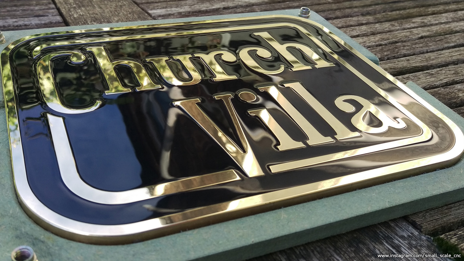

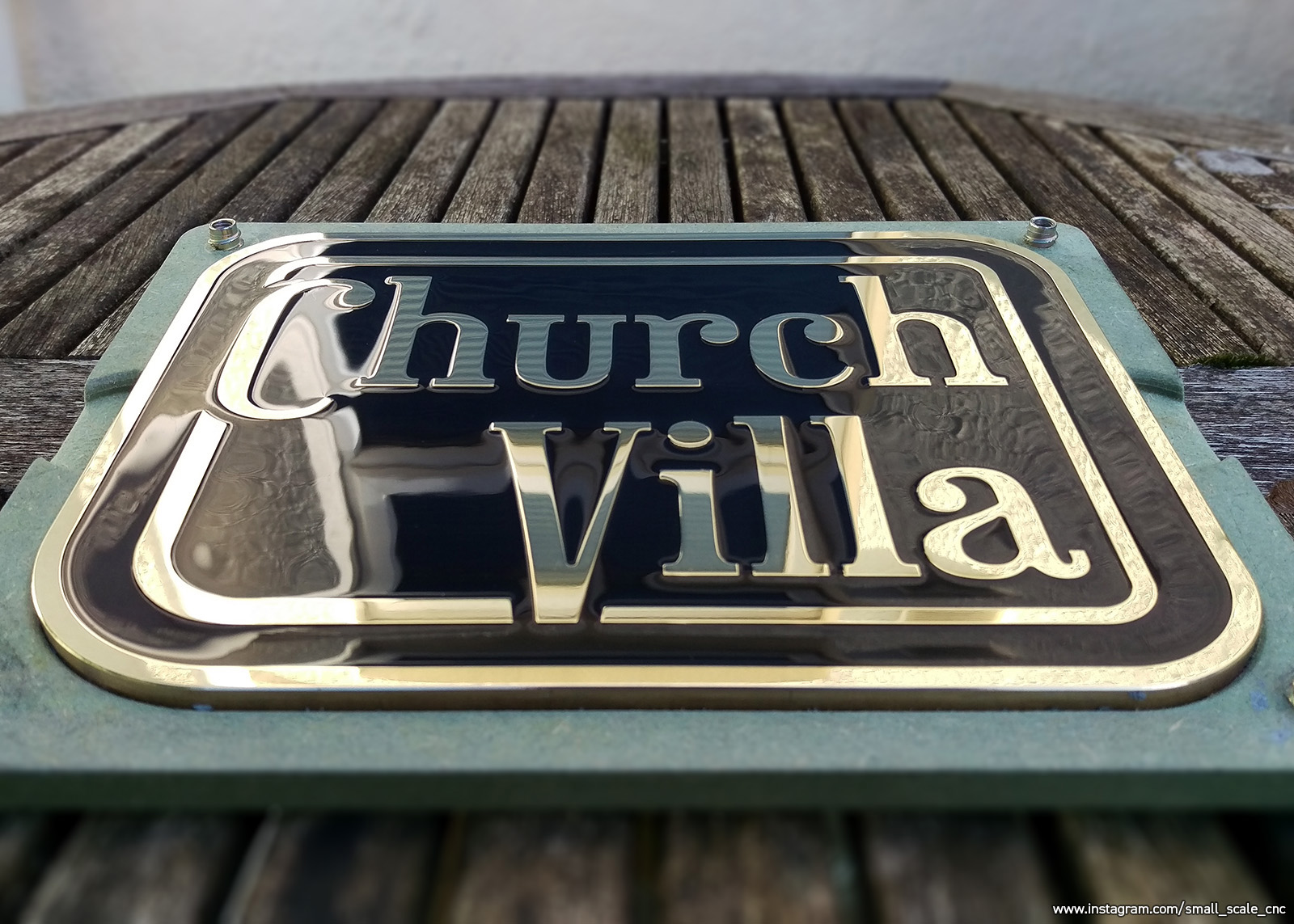

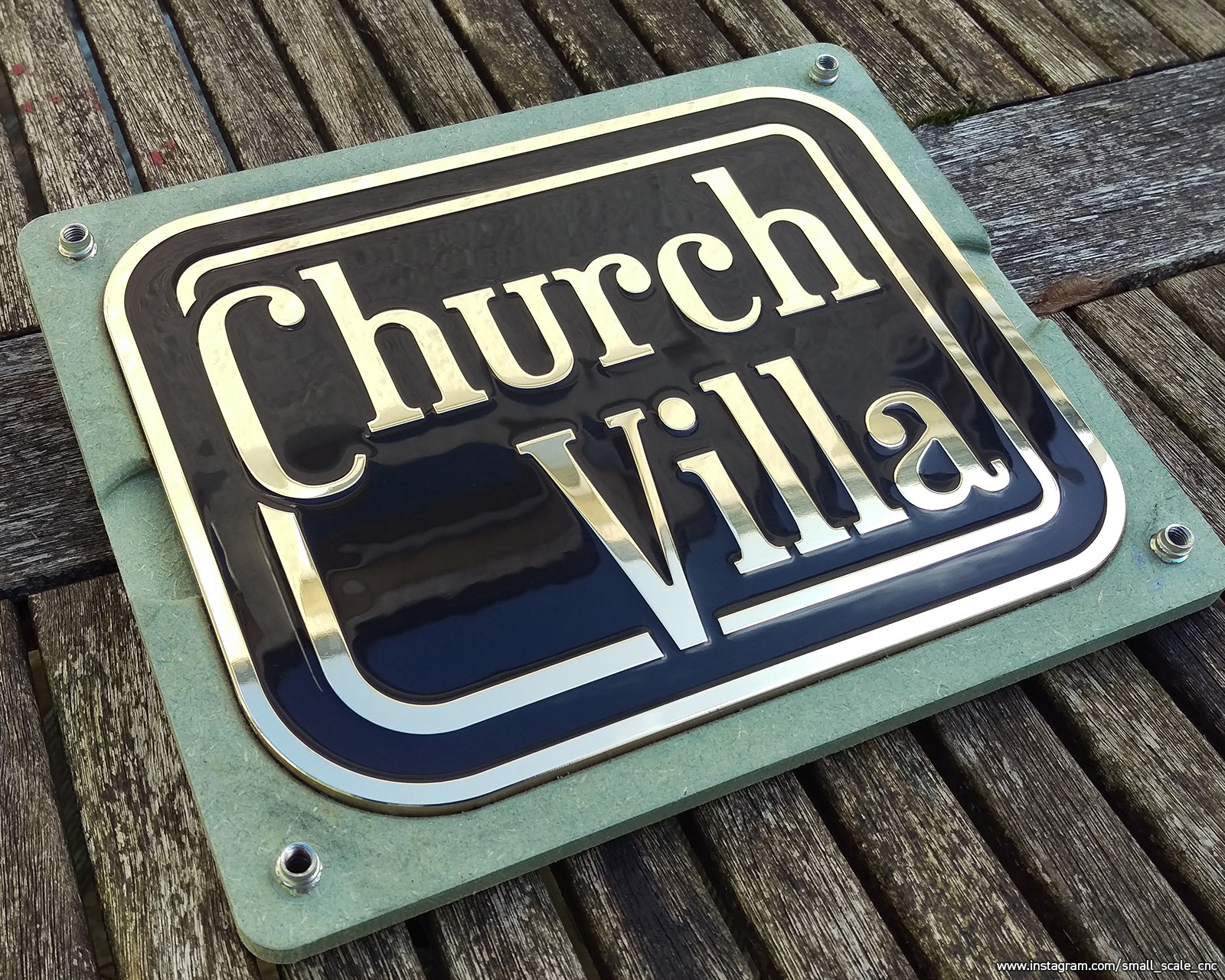

    Just finished up this project I've been working on (and off) for a bit.
    My usual CZ120 / black resin combo. Imagine a world where every piece of signage was brass / black resin. Expensive? Yes. Highly impractical? Maybe. Making the world a better place? Absolutely - especially with the antibacterial qualities brass possesses... Topical.
    Anyway, some pics and some vids:

    Looking Bling Bling Mate good job as always.. (Which machine Wal.?)
    That looks amazing. May you share your process for sanding/polishing/buffing please?

    After cutting I relax the sharp edges with steel wool and then use Brasso before de-greasing and washing off residues. Then the resin gets added. In an ideal situation that would be that, but often you get a bit of over-spill and you need to sand off the excess and re-polish. If you want the resin to be flush with the metal then you'll need to overfill the pockets and sand back anyway, so don't bother with the pre-polish. Resin, by and large, polishes up well with Brasso, but micro scratches are your enemy. Work through the grades of paper - there's no way around it, a lot of elbow grease needed for a decent job. Finish with Brasso and then to remove the micro scratches use a polishing compound, like 310, and buff buff buff..!

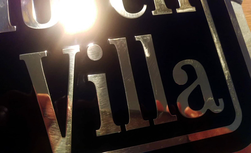

    As a related side note - this resin work was done 'out of house' - I don't bother with the larger stuff nowadays - the half hour pot life of my resin is too short to get a decent pour on a large surface with lettering details that need attention. Whilst I'm happy with the resin work that was done, they'd somehow managed to miss a couple of patches of over-spill onto the border and also introduced/omitted to buff out some pretty bad micro-scratches into the metalwork. Whilst they considered it to 'look great' - I had to re-polish the lot before I was happy enough to consider it worthy of passing on to the guy I made it for. Here's a pic of how it came back from the shop, judge for yourself...

    Anyway, I'm rambling - but my point is that to a certain extent quality takes time and effort.
