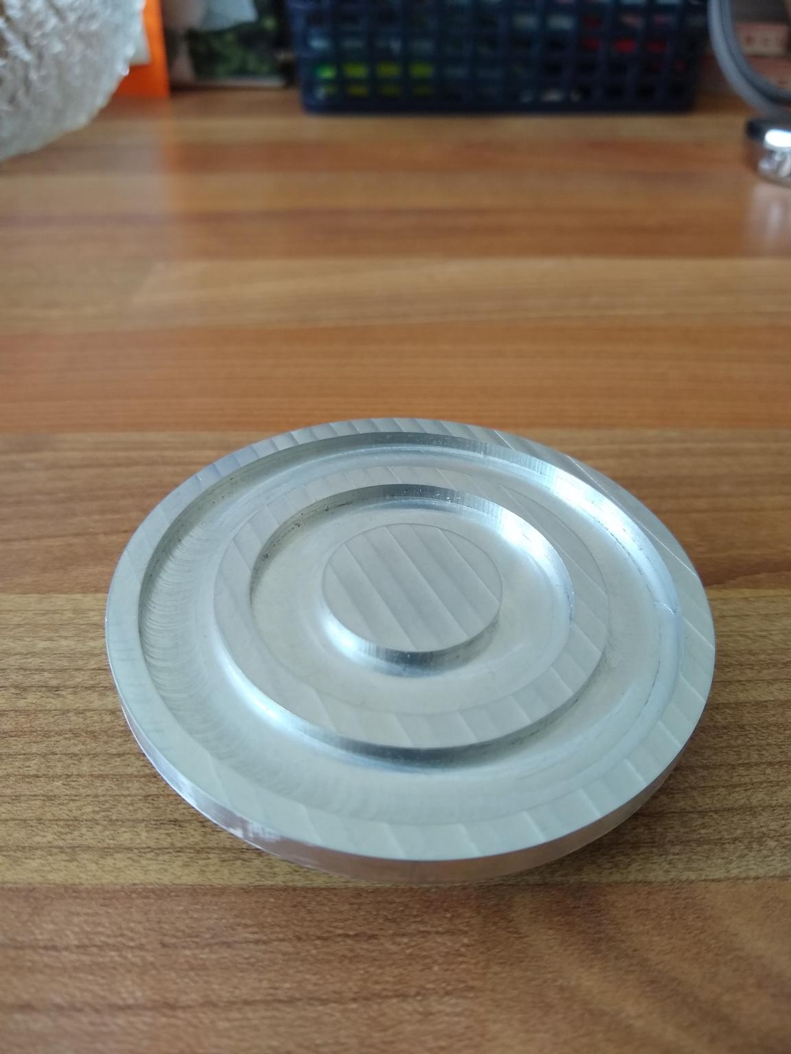

    So much to learn about fusion 360 CAM still - managed to make my first aluminium part! Simple pocket toolpath and cutout, but I was pretty happy with the finish, not that I have much to compare to, just it did it first time with no issues.
    Couple of sprays of WD-40 but used 17,500rpm with 1mm DOC, 6mm 2 flute end mill.
    It's a um... coaster?

    May give the Aztec calendar a go Jazz , is there any specific high quality STL file you have for fusion 360 - as a few various ones out there I've found?
    Also, does anyone have any suggestions for the best way to face a surface that fits in an ER-20 collet? I've seen flycutters etc mentioned but most are too large - any recommendations?

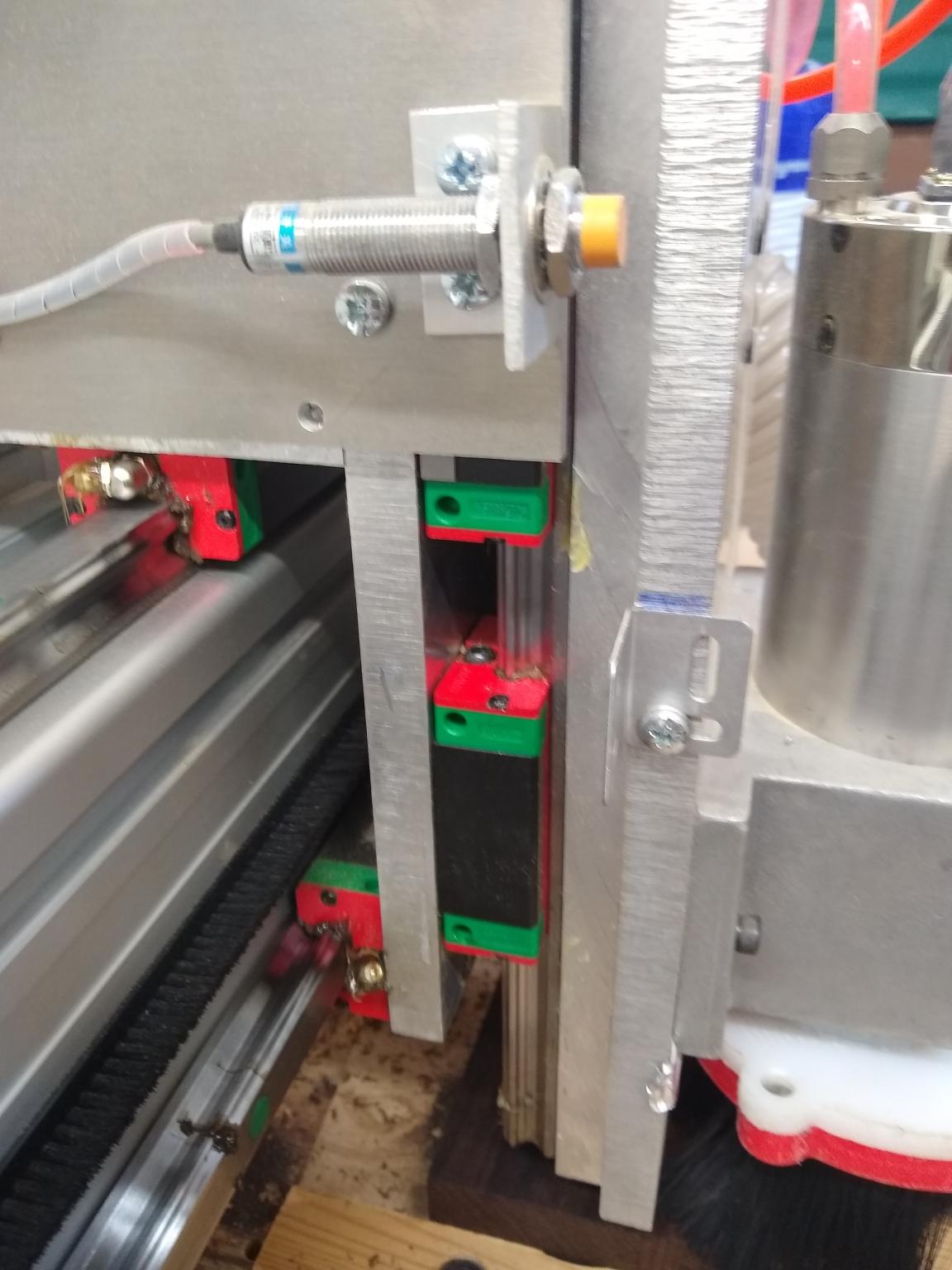

    So one thing I hadn't fully thought out in the design is how to grease the Z bearing blocks. The nipples are in the right place (must avoid obvious jokes here..) but the grease gun "Nozzle" wont fit in the space to engage properly.
    So I'm thinking of using the side inlets - only recently realised that was possible.
    Hiwin say you should carefully pierce the side inlet with a hot metal rod to avoid chips in the bearings. Do you then have to insert a new grease nipple (can't see a thread) or is there a different type of nozzle available you can just pressure fit and fire in the grease. I can't have a permanent fixing as it would hit the side plate.

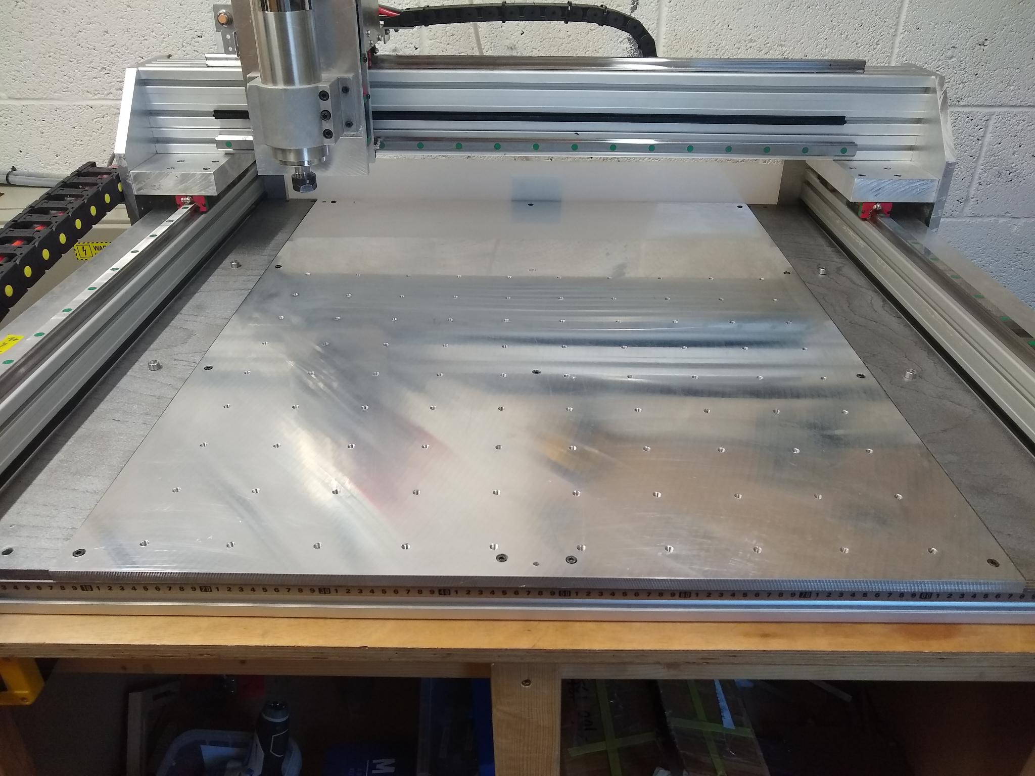

    I've used just about every method and my personal favorite by a long way is the Matrix grid of tapped holes. It gives the most flexibility and if combined with a few strips of T-slot in strategic places there's not much you can't hold.
    I wouldn't buy a rolled plate and surface it thou as it releases stress and moves around, ground cast tooling plate is much better and doesn't move around when you drill/tap it.

  10. #140
    Hi NordicCNC - I ended up making a hole in the side inlets - 2.5mm I believe (as hiwin spec sheet) and using the small blanking bolts to seal the holes when not in use. Then used a conical adaptor for the grease gun to grease from the new holes - seems to work well.
    Got around to upgrading my machine base - ended up getting 12mm aluminum tooling plate and using the router to drill 100 M8 holes @ 75mm spacing. Then the fun of tapping 100 by hand:)
    I'm sure a thicker plate would give even more rigidity but It's much more rigid/less deflection than the 12mm ply ! Plus no more threaded inserts falling out all the time. It's also nice and shiny (for now)..
    Added a ply spoilboard for now, but planning to use phenolic on top in the future.
