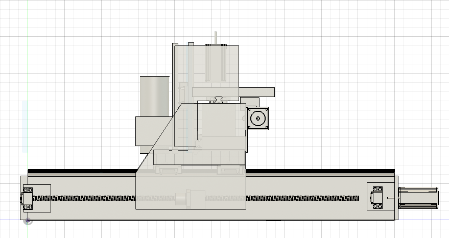

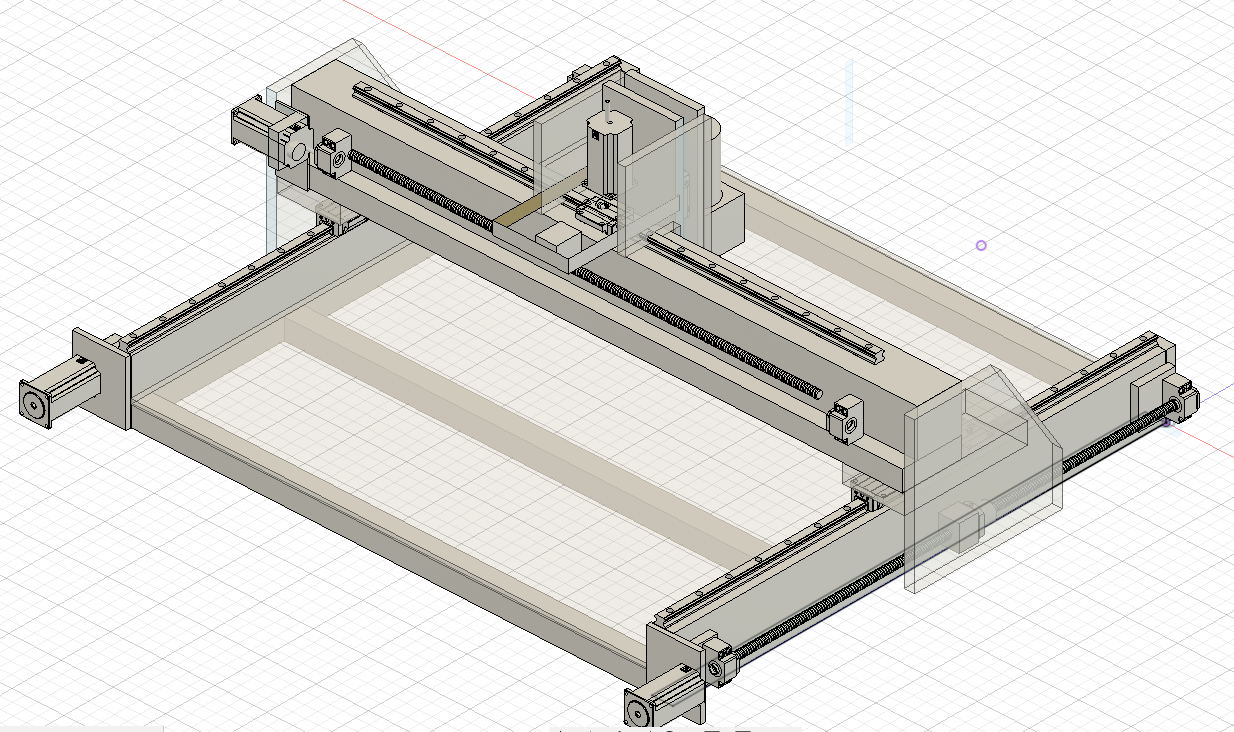

    OK so I've figured out enough of Fusion 360 to model something - not going to win any awards but at least it's clearer and I can edit the design as needed.
    The blocks on top of the X carriages are set to 40mm thick currently
    All rails are 1000mm , to be adjusted if needed
    Aluminium profile on gantry is 120 x 40 with 90x90 on top.
    The purpose of the ballscrew and ballnut running inside gantry plate is to allow an L angle (or perhaps long brush) to be fixed to the extrusion above the screw and cover the ballscrew from dust/chips
    Issues I'm thinking of so far is the the Z axis clearance isn't huge, 125mm from top of baseboard to bottom of gantry, although probably OK for my needs.
    The Z design with rail on front and top is based on the fact Z clearance would be even lower if I put rails on top/bottom of profile. I plan to add extra C shaped plates to side of Z axis to strengthen - will it be enough/OK design?
    Y axis travel is limited by how far forward Z is - losing about 275mm so probably need to bring the carriages closer together and gantry plates narrower, maybe mount motor to back of gantry extrusion instead with pulley.
    Any comments on those bits? thanks

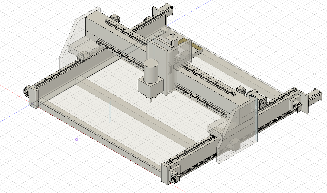

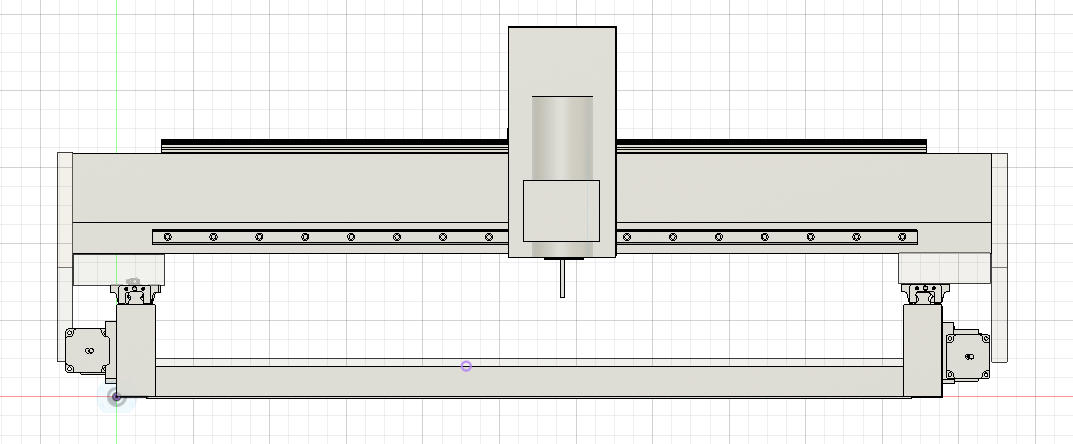

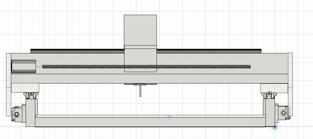

  7. #17
    Hi All,
    I've spent some more time on the design - moved the dual X motors to the back, and added a pulley based drive to the Y axis (borrowed from Andy's build log!)
    Also shortened the plate fixing gantry to Y rails to give more Y cutting area. I expect I'll get 750mm out of the 1000mm total Y length.

    For my Z axis, I'm planning to make this 350mm tall with 350mm rails and 265mm ballscrew.
    I think I'm ready for a quote on linear components - would appreciate if someone could take a quick look and advise if there are any glaring issues?
    These are sets from BST automation e.g https://www.aliexpress.com/item/3288...35f43557qd67J5
    Ballscrew sets to include ballnut and mount, BK/BF supports and coupler.
    2 set 1610 ballscrews X @ 965mm long
    1 set 1610 ballscrew Y @ 1000mm (With Pulley Machining)
    1 set 1605 Z @ 265mm (With Pulley Machining)
    X rail set 2 x 1000mm rail and 4 x Hiwin 20mm Flanged Carriages
    Y rail set 2 x 1000mm rail and 4 x Hiwin 20mm Carriages
    Z rail set 1 x 350mm rails and 4 Hiwin 20mm Carriages
    Thanks.
    Ryan
  8. #18
    On the model, you show BOTH ends of the ball screws using BK bearings which are the fixed end bearings, which is the best way to fasten, BUT it's not the standard way. Usually, you have a fixed end BK bearing and a floating end BF bearing, so if you want BK on both ends you will need to tell Fred at BST otherwise they will machine them to standard.
    Also mention you want the "F" Dimension which is the coupler portion at 25mm otherwise they will machine it 15mm.
    Tell Fred you want the best BK/BF bearings not the cheap ones.

    Jazz's comments are spot on, and also your BK nearest the motor is back to front. Mention to Fred that your dimensions are for the screw part not total length else you'll end up short!
    I'd recommend an F length of 30mm on Y and Z to give more room for those pulleys. Don't know if Jazz was saying 25 for the X couplings or the pulleys? Either way just gives more room to align that pulley.
    I've noticed your gantry vertical plates are wider than the distance between carriages - the angle continues further than the carriage. Might be worth trimming that because it's essentially cosmetic in its current form and will be costing you when you order the plate.
  10. #20
