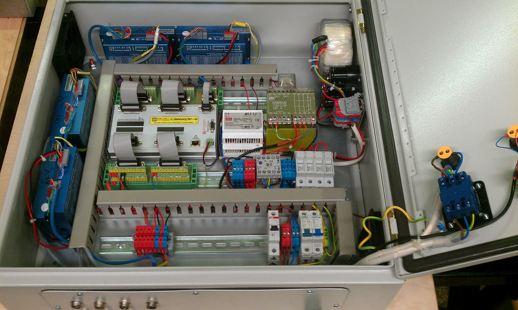

  4. #34
    OK so I've listened to the start simple advise and taking each part at a time! So plan is to sort out the cabinet layout, power distribution, e-stop and switches first, then add controller and drives once the machine is actually built.
    That way the low(er) cost and less complex items can be fitted now and drivers / controller / home and limits / alarms / faults to be added once the machine is built, and finally VFD and spindle.
    I have this for the cabinet layout - does it look OK or any issues?
Name:	ext cabinet.PNG
    I'm planning to buy these - could someone confirm they are OK choices, especially the contactor! Looks like it is DC
    https://www.rapidonline.com/mean-wel...cy-psu-85-5684
    https://www.rapidonline.com/schneide...tactor-66-1939
    Couple other questions from the never ending list:)
    - Do I need to Fuse the drivers? They have overcurrent/voltage but I notice some people have?
    - Are EMI filters needed with decent star grounding? I'm planning to add the EMI filter option on the transformer.
    Possibly one day I can answer some questions:) On a side note, looks like quite a few builds stall or just about complete and then people disappear from the forum, big thanks to those who stick around to keep helping others.
    Ryan

    AndyUK's Avatar
    Lives in Southampton, United Kingdom. Last Activity: 3 Weeks Ago Has been a member for 6-7 years. Has a total post count of 469. Received thanks 100 times, giving thanks to others 43 times. Referred 1 members to the community.
    Be interesting to hear if these fuses have ever "saved" anything!
    I've already buried the spindle in the work a couple of times, both times have 'gently' blown the VFD fuse before any damage was caused elsewhere. The power loss to the VFD also causes a fault on the controller so stops the motors, which is kinda nice.
    Quote Originally Posted by CNCRY View Post
    Three things spring to mind:
    • VFD Spacing against internal walls. Read the manual for how far it should be away to allow adequate air flow.
    • I'd keep earth near Line and Neutral, thats where it comes in after all, and a lot of the big ticket earthing items will be mains voltage.
    • You've made a good start trying to separate voltage levels, but the 5V PSU should be at the low voltage end of the cabinet rather than its current position near 65V DC.
    • Think about air flow through the cabinet - At the moment your drivers will get decent flow, but the VFD won't. What direction are those fans? I orientated my drivers to allow maximal air flow through their heatsinks, at the moment your heat sinks are at 90 degrees to the air flow.
    Will it work in its current state? Sure. None of these things are big issues, just minor points.

  9. #39
    You need to think about how the wires run and trunking. how you have it there would be awkward for running wires etc.
    I would move the drives away from the Transformer and bring the DC PSU and MCB's etc down near the Transformer so all together in one area. If you have room even bring the VFD into the same area, this way all the high voltage stuff is together.
    I would have the drives and controller close together to keep Signal wire runs short as possible. Separate the high power stuff from the Low voltage stuff by placing high and low in the case with Terminal blocks and Relays etc along with trunking between them, essentially dividing the case into 3 areas.
    This doesn't matter if it's separated horizontally or vertically, for instance, I often run the drives along the sides of the case vertically as it's easier to wire them. On the opposite side, I will place VFD at the top and PSU, etc below. In the middle will be Terminals and Controller.
    Also, I would think about having 2 fans in the case to create a positive pressure in the case to push hot air out.
    Edit: Noticed that you have a Pilz relay shown, you don't actually need a safety relay. A normal Relay will work just as well and save you a lot of money.
    Lastly, looking at your drawing the scale looks wrong on the parts shown so be very careful when planning out the box because it's SO EASY to run out of room. Often the case will look massive when empty but it quickly fills up. Also if you haven't got the box to measure from then allow a little extra because things like hinges or Earth clamps etc can rob precious space and easily screw up layout plans.
    Also if not got a case and solely planning layout in Cad or on paper then I'd try to get exact dimensions of any components because again can soon run out of space and no matter what you do or how you twist things around it just won't fit.!
  10. #40
    Attempt number 2 - tried to separate Low/High voltage more and incorporate some other suggestions. Airflow intake at the bottom and out at the top, by VFD fan.
    I checked the scale and believe its correct - cabinet is 700mm x 500mm . Although the DIN rail items are NOT to scale yet, the DIN rail is. I'll take some photos when parts physically arrive..
    I think the conclusion is that fuses are v unlikely to be a negative addition, and probably positive, I'll add these between transformer output and Drivers AC input - probably 5/6A.
    I did buy a PNOZ already as I made an ebay offer on one new much below "retail" price and got unexpectedly got accepted.
    Andy - yes good shout on 24V PSU, just chose wrong one.
    Think I'll need to add a fire extinguisher to the list too before I get started:)
