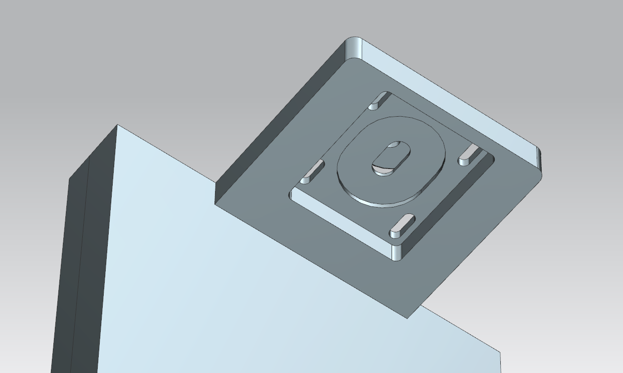

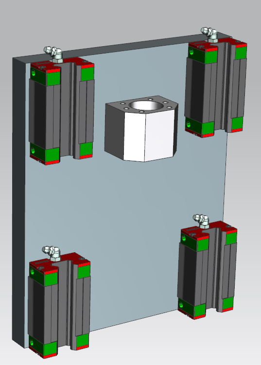

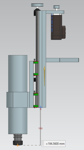

    The solution I will be using to allow for the heavy ATC spindle is to keep the Z-axis weight as low as possible. Linear rails, ballscrew & bearings, and servo motor will all be mounted on the rear plate. The ballscrew nut housing and guide carriages will be mounted on the front plate. This is based on the advice that there is not much difference between front/rear mounting when it comes to stiffness. Yes, it is slightly stiffer with front mounted linear rails, but this is a compromise I need to take. The gantry clearance will be 200mm. Anyway I will still be able to surface components up to a height of 240mm and with a diameter of around 160mm, since it will be possible to raise the tool above the bottom of the gantry. I could also decide to make the rear plate longer to further increase the height if I want.
    Components that I plan to use:
    - Aluminium tooling plates
    - HIWIN linear rails: 20mm
    - Delta 400W servo motor, with brake - Was JMC 180W servo motor.
    - Ballscrew: 1605 - Was 1605 or 2005.
    - HTD 5M pulleys with a 2:1 ratio Was 3:1
    - 3kW Auto tool change spindle

    Some comments in no particular order, assuming you want to build a decent machine and not a toy:
    - 1400 x 1000 x 200 mm is a _huge_ working area. I would expect a machine that size to weighs at least 1500 kg.
    About servos:
    - those 180W JMC servos are toys and seriously underpowered if you want decent speeds. If you want to go servos, use some proper ones. Delta servos are cheap and good. You need to size the motors depending on the max feed/rapid rates and accelerations you seek. 400W is probably the bare minimum.
    - Personally I expect a router this size to be fast, I would target 30m/min (1000 ipm) and maybe 0.5g accel.
    About ballscrews:
    - 10mm pitch ballscrew would be the minimum I'd use, without any reduction. With servos direct-drive is the best and the cheapest. Good pulleys are expensive, and add unwanted inertia to the system. Servos are usually rated at 3000rpm, with 10mm pitch this gives you a max speed of 30m/min.
    - 5mm pitch ballscrew is acceptable for the Z axis. Again without reduction. If you really want pulleys for space issues, use 1:1.
    - Ballscrew diameter: you need to calculate it depending on the desired max speed. A ballscrew 1400mm long that don't whip at 3000rpm with fixed-floating ends is around 60mm diameter... If this sounds too big you can go with rotating ballnut (complex) or larger pitch. 20mm pitch would be ideal and you would only need 32mm ballscrews.
    About rails:
    - don't bother with anything less than 25mm. For the simple reason that 20 rails use M5 bolts and require tighter drilling positioning tolerances.
    Yes it is a huge working area! About the weight, I've quickly added all components to my build with assigned material weights etc. and it sums up to about 200kg right now. I excpect it to be around the 300kg mark once everything is mounted (with aluminium profiles as base frame). Not much is missing so I am not sure if you thought that the whole machine would be built out of steel? Then the 1500kg would make sense.
    Quote Originally Posted by jarjar View Post
    About servos:
    Yep, I realized this later (NEVER BUY PARTS BEFORE DESIGN IS READY) that I would've been better of getting either 400W JMC servo motors or 400W delta servo motors (seems to be pretty much the same price and specs!) or even stepper motors.
    Targeted speed is 15m/min and about 0.25-0.5G acceleration. This I plan to achieve with a 2:1 ratio with 3000rpm and 10mm pitched ballscrew. I will also achieve some increased torque with the 2:1 ratio, which will be helpful for these small beasts of servos.
    About rails:
    If I go for the aluminium profiles on the Y-axis (base frame), then I will only have to drill and tap the M5 bolts onto the rear Z-axis plate. This plate size fits well in my shitty CNC router that I built 10 years ago. It can handle the requires tolerances needed for those holes, I am pretty sure.
    Anyway, do you think 25mm would be to prefer over 20mm rails for the sake of stiffness?

    About rails:
    That seems like a terrible reason to spend more money. A standard clearance hole for M5 gives you 0.5mm of wiggle. By marking out carefully, setting up the rails with clamps and a dial guage, then using a transfer punch, this is more than enough.
    Indeed I was wrong about that. The clearance is the same for M6 bolts. Still the price difference is low and bigger is always better for rails... It helps for stiffness, ballscrew clearance, and the rails are better supported when mounted on T-slots profiles.
    Yes, price difference seems to be only about 15-20% for either 25mm or 30mm rails. If it is bringing me added value and it isn't overkill, I think I am ready to go for the 30mm rails.
