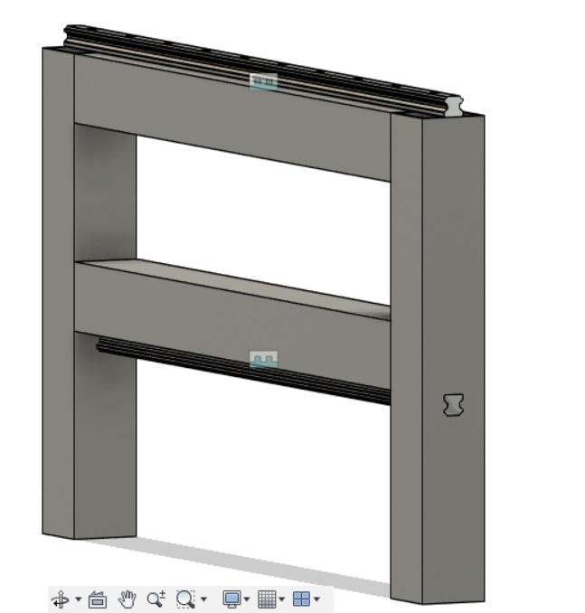

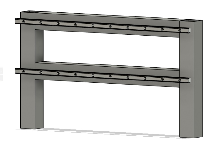

    Apologies if this has already been asked but I'm weighing up my design choices and wanted some input about the different arangment of x axis bearings. I don't know what or if these two designs have an official name (so i didn't know what to google) so I've called them alternative A/B
    (The pros and cons are based on my limited understanding, so please correct me if I'm wrong)

    Pros: easy to implement and calibrate how parallel the guide rails are, more travel than alternative B
    Cons: Tool ends up being further away from the axis than with alternative B
    Alternative B

    Pros: Tools can can be held closer to the axis, better for rigidity
    Cons, much harder to check how parallel the rails are, less travel than alternaive A
    Most of the DIY machines I've seen use A, but it would be great to get the merits of each one.

    Before choosing the bearing position you need to fix the gantry.
    Separate tubes are weak.
    You should have one large tube.
    Your pros and cons are correct. There is no "best" for this design choice. They each have pros and cons. It partly depends on the other design compromises you make, for instance how much stick out the spindle will have due to other decisions.
    If you choose good rigid gantry uprights, for example large tubes and not thin plates, you can get back the lost space under the gantry due to rails underneath.
    For me, the hassle of trying to align rails in alternative B and the increased complexity and weight of the carriage make it not worthwhile. I prefer alternative A.
    If you are going to weld up the gantry from steel box section then you can use the epoxy levelling method to get a flat surface to fit the rails to in option A, but you should make it more solid. My own gantry is made from two pieces of 100x50 box section welded together to give a 200mmm high face for the rails to fit on. As always with a DIY build, your best option depends very much on what tools or other workshop facilities you have access to. Option A makes the Z-axis assembly much simpler to build as well.

    Thanks pippin88, I think am leading to the same conclusion as you. My diagram wasn't the best, the rails will be on the tube going across only (along the x axis), the diagram shows that it also goes across the small section of box that is going in the Y direction but this won't be the case since this space will be used to house a motor and leadscrew bearing support, so the rails only sit on one section of tube.

    ADJUSTMENT ADJUSTMENT ADJUSTMENT... I've said this many many times in posts but I'll say it again because cannot be stressed enough.
    With this fixed gantry design, you are going to need plenty of adjustment. If you weld up the gantry completely and especially if welded to the base frame you won't be able to adjust the planes the rails sit on in relation to the other planes.
    Any extra time spent thinking about how you can build in adjustment will pay back big time when setting up the machine and the accuracy you will get from it.
    Regards the 50mm with 3mm box section then like I said in other thread, it's spaghetti-like properties mean you really will need to brace it good. Not so much for strength but for rigidity and resonance. The thin wall means it's resonant which causes vibrations at the tool, yes you can fill it with sand or concrete-like some have done, but this won't help a poorly designed and braced gantry.
    This stage is critical to get right because it's the foundation everything else references from, Wobbley foundation = Shit machine simple as that.!
