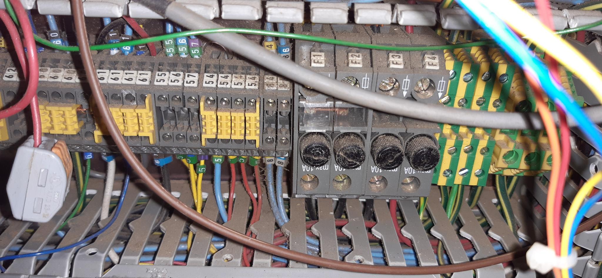

  5. #105
    OK, Step pulses set to 2 - what about the Dir pulses (currently zero)
    Regadng my rewire here is the bottom rail that wouldn't have been too clear on the previous pictures. I suppose I can use some of these for splitting the rectified output from the toroidal transformer?

  6. #106
    I'll bow out of the conversation on re-using DIN rail terminals - I'm not familiar with them enough to advise (Only recently realised there's such things as shorting links). If you have the rail installed (which you have) it feels like a good opportunity, but others here with more experience will offer a more accurate view.
    About the DIR - probably best to be set similar - if you miss a DIR change then you might end up with a single step in the wrong direction - but as this would only be on change of direction the error is unlikely to accumulate.

  7. #107
    If you inventory what you have and find the voltages etc and tell me what controller you are going to use I will happily help you work out a wiring schematic.
    Here is the list:
    Existing items
    Power supplies:
    24V 3A
    24V 14.6A
    12V 2A
    RFI Filter
    Omron relay MK2P-S
    Omron relay G2R-2-SN
    Control Transformer" with outputs marked 28, 110, 120 and 240
    DIN Rail
    Fan (voltage unknown will check tomorrow)
    Main on/Off switch
    On order:
    Airlink 500VA 230v to 2x45v toroidal transformer
    Power supply 50W 5V DC 10A
    bridge rectifier 400V 35A
    4OFF Electrolytic Capacitor, 4700 µF, 100 VDC
    ABXX-E Motion Controller
    3-OFF Stepper Motor Driver 6.0A, 80V CNC Microstepping CW8060
    Terminal Blocks and wires
    I am pretty sure I can wire the ABXX to the drivers and steppers and the VFD is seperate so really all I need help with is getting the mains to the PSUs and on to the devices and the E-Stop.
    I think I can work out the limit switches.
    I thought it would be tidy to use the existing connectors on the rail to get my rectified output from the toroidal transformer the the drivers, I could have the wiring run behind my mounting board.
    Obviously if I have missed anythng please let me know.
