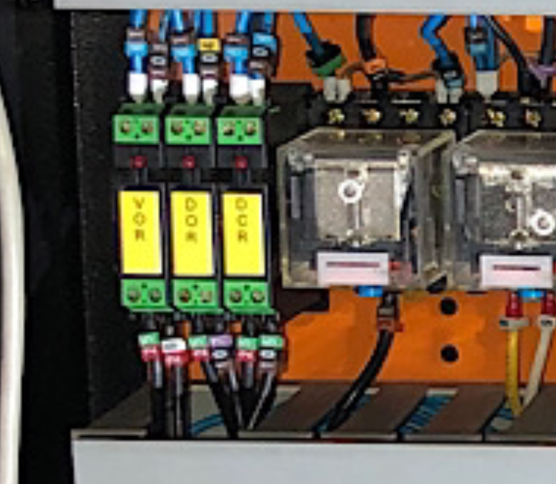

    Yes! I’ve got the VOR, as well as DCR & DOR (door closed/open relays?)

    To the right hand side of the column, is what looks like a push fit air fitting, maybe 5or6mm from memory.
    Thinking now this could be the air supply for the vice?
    Should all of the relays have the LED illuminated when the machine is under power?
    Or just when commanded?

    Not all relays should be powered.
    Things like the DCR/DOR should only have one of the two active at any given time.
