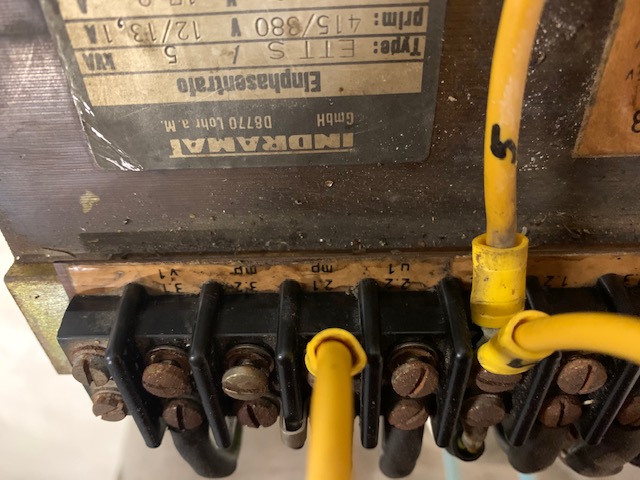

    Just had a play with the transformer, with 240Vac through the 380V terminals it gave secondary reading of 95V on each and 190V across both... could be usable?

    That is a bit of a mother and IXYS is a "premium" brand. That first one you linked to from CPC would be absolutely fine. These diode bridges are generally very robust.
    A better solution would now be to connect the 2 primaries in series and the 2 secondaries in series (as they are already).
    I take it that the 380V windings are the brown and blue. Each contains 2 wires - one from each limb. You could separate them and connect them in series so that there is a (floating) centre tap formed by one brown and one blue. Then the voltage on each primary would be 120V and the voltage across the ends of the series connected secondaries would be your 95Vac. Then you would simply feed the 95Vac into a bridge rectumfrier and you would get your 130Vdc or so.
    Apart from reterminating the wires, you are almost done. It's a rather large beast but there is no extra expense and alongside your 2 tonnes of cast iron, it's all relative!

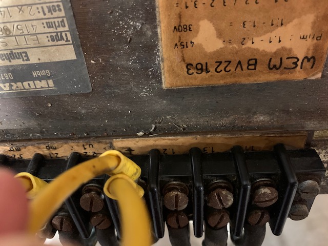

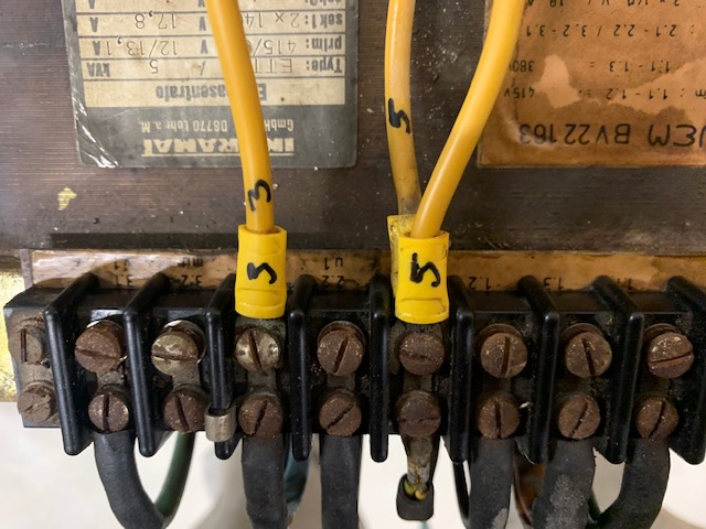

    I manage to un cover some terminal labelling hiding under the grime! pictures attached of which wires do what..
    Yes, as you say, the 380 windings are terminals 1.3 (Brown) and 1.1 (Blue). So leave the secondary as is, and separate the pairs of blue and brown and have a single blue, blue and brown together, single brown..? Hopefully I'm not being dumb and that's what you mean!
    At this stage I think the money saving out weighs keeping the size and weight down, at least for now. So I'll persevere with this lump seeing as its quite close to where I need it to be. your not wrong though, it must weight somewhere between 50-60kg easily.

    .Yes, single blue, blue and brown together, single brown would work.
    You can always swap the transformer out later when things are running and you are feeling flush. Keep your beer tokens for other stuff.
