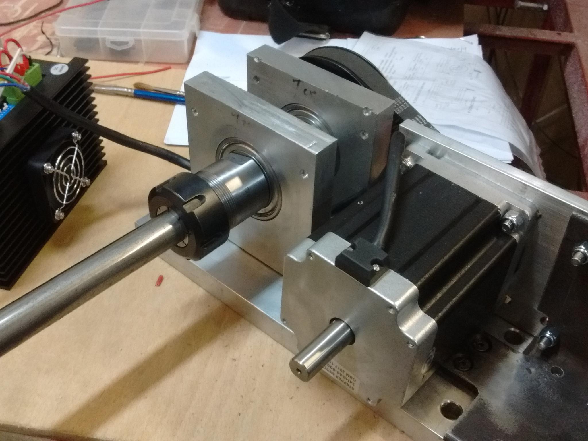

    I'm starting to mill some larger blocks of hardwood on my 4th axis using rotary indexing machining and I can see from the play in the wood when roughing at the extents of the block that the issue will only accelerate as I mill out to the edge of the stock. I've not had this problem with continuous 4th axis machining as i've been parallel milling down the centre line of the axis where there is least radial load on the stock.
    I've not really looked into this it only occurred to me tonight that maybe what I need is to be able to lock off the 4th axis between indexed rotations. Looking at my 4th i'll have to attach a brake rotor to the back of my 72t pulley.
    How have people solved this problem before?
    Anybody got a neat solution or a link?
    ps since the 4th was built i've changed the design a bit but its a standard belt and pulley set up with a nema 34 and an er32 shaft
    More torque or more braking :)
    Only real solutions are, a bigger motor, more gearing (could go to double belt reduction, or screw and pinion), or add a brake.
    1st is likely to be the most expensive.
    2nd you lose speed.
    3rd you need to consider programming it (typically done through custom M-codes)

    I’ll start to look into the custom brake On/off coding and see if its something I can think incorporate without too much hair loss :). Yeah bigger motor could do, similarly the gearing as not concerned with speed just needs to work within the motors torque sweet spot.

    Would a closed loop stepper motor be any use? I would have thought the "closed loop" would prevent un-requested movement and behave a bit like a brake.

    I suspect the answer is probably yes but the gear thats on it isnt too bad, its not closed loop though.
    Current 4th set up
    3DM860, 24~80VAC 30~100VDC 7.5A 20KHz PWM
    Nema 34 , 8.5Nm, 5Amp
    80V + 600W switching power supply.

    Yes and no, would be the answer to that.
    The big benefit of using a closed loop stepper in this application, would be they do tend to self correct to a certain amount so would move the stock back into position, and they would let you run things far closer the motors limit, however any movement could still scrap the part.
    It's a case of balancing up your needs, and what compromises you can make.
    I have just thought of one option if you don't need much speed, how about mounting a stepper onto a cheap rotary table?
    They should be adjustable for backlash, and they'll give you lots of gearing in a compact format

    On the best diy heavy duty mill/lathe 4rth axis as far as i remember relation was 1:7 and there was possible via second belt change to raise that. And i remember talking to the guy and he was using 120?mm mountain bike hydraulic brakes and discs. Check ebay the standard size of brakes nowadays, could be around 200mm. Hydraulic brakes is the way to go i believe, fix the discs on the shaft somewhere.
