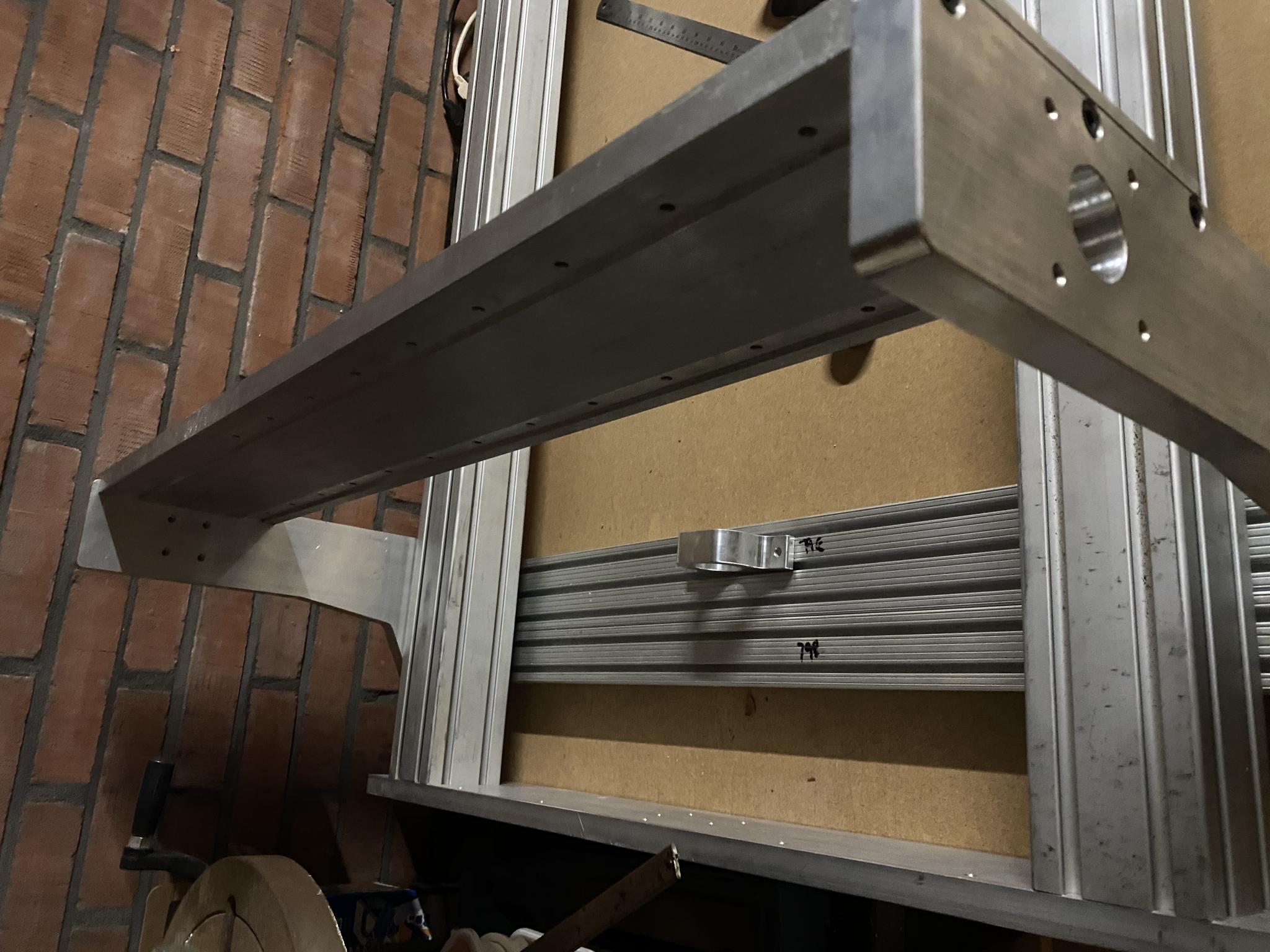

    To spice things up and help draw some interest, here are a few shots of what I have - I've put together the gantry and base (just bolted it up, no loctite, no attempt to really level or line things up) just to get a sense of the size of the whole machine, and to get accurate measurements of the clearance between the 8080 profile and the gantry sides to figure out the required linear rail bits and pieces. Once I've got a little further down the road I may start a build log to document things for my future self and simply for fun, and to get some input if/when I get stuck along the way.

    The ballnut housing has a 40mm diameter hole, which suggests a 25mm leadscrew to me. That would line everything up with the machined holes in the endplates. Overkill, perhaps, but what would the major downside be other than the need for a lot more power? I need to dig up all the other bits and pieces and pre-assemble the Y and Z axes to see if I even have all the required hardware for mounting everything. If not, that's going to take some interesting reverse-engineering, or re-engineering. The backing plate and uprights on the gantry are milled aluminium, the base (which the ballnut housing is attached to) is 2020 profile, bolted in. Being a woodworker, I'm mostly impressed by how heavy things made of metal end up being. The plan (and mounting bits and pieces) is to fit a Teknomotor electrospindle (2.0 or 2.2kw), which weighs a good 8kg. The Z and Y axis run on 20mm HGR rails with 2 'long' carriages (50mm bolt spacing) per axis, the gantry runs on 20mm rails with 4 'short' carriages (36mm bolt spacing). The Y-axis ballscrew seems to be a 1610 with supported bearings on both ends, the Z-axis bottom is unsupported. The machine is very similar to this one, which is a slightly different variant by the same builder/designer:

    I'd also be looking to stiffen up the gantry. Although the Aluminium cross plate may look strong because it's a thick piece of aluminium it's actually not because it's just a flat and unbraced so at that width it will vibrate when cutting, this vibration will transfer into the spindle so will show in the cut quality.
    Also don't be fooled into thinking the rails will stiffen it up because they won't and don't. What it needs is a perpendicular brace across the back to make it like "T" on it's side.!

    I had seen cross braces for the gantry i. Other builds, will see about adding one, thanks! It can double as a mounting spot for the energy chain as well. Any suggestions as to dimensions? Intuitively I would prefer something like 20mm thick 100mm wide solid bar, drilled and tapped every 50-60mm, to a piece of extrusion. Or is something thicker or wider a wiser choice?
    Just a piece of 20mm x 100mm like you suggested would be good. I wouldn't bother with the extrusion.
