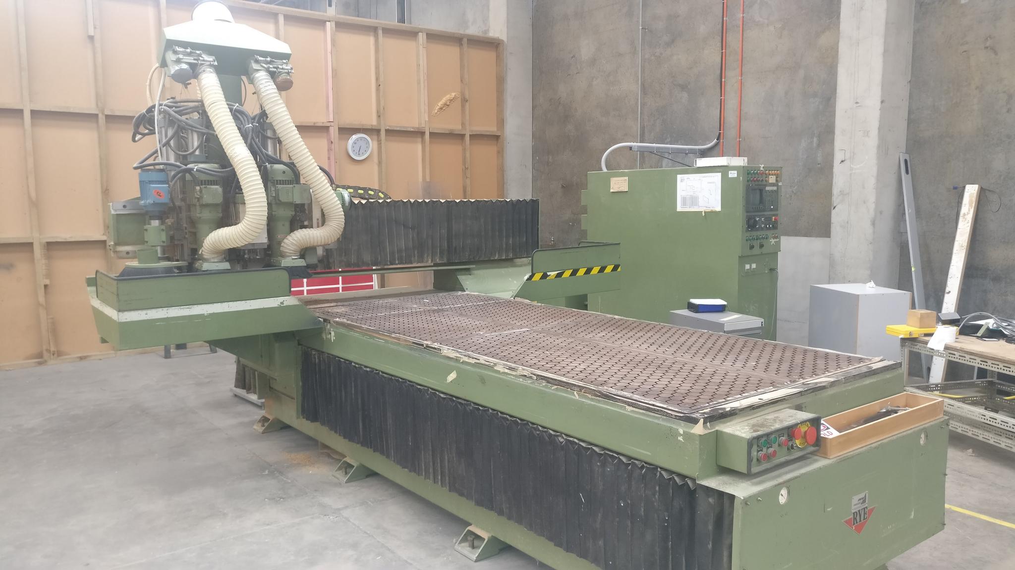

    I recently bought a CNC Router, mainly for the solidity of the frame since the electronics there is a bit too complex for me.
    Currently, it has
    Machine spec:
    - x axis: linear slide rail with (I think) SBR25 bearing, Ball screw and SEM ltd motors (MT22R2-24 perm magnetic DC servomotor), belt driven
    - y axis: linear slide rail with (I think) SBR25 bearing, Ball screw and SEM ltd motors (MT22R2-24 perm magnetic DC servomotor), belt driven
    - z axis: pneumatic actuated (no controller connected to it at the moment, the pipes are open)ò not sure how is called the rail system, it's like trapezoidal
    I will need to change the movement system on the Z axis since I want to use a stepper motor rather than a pison.
    The table is in Bakelite and has a suction system and the pump is there (220V).

    It looks like a nice machine.A few questions; why switch the servos for steppers?Servos are normally regarded as a better option as they operate on a "closed loop " basis and the factory would have specified something of adequate power.Are you quite certain that there isn't a servo on the Z axis?It isn't unusual for a machine to have a pneumatic cylinder on the Z axis to take the vertical load of the moving assembly.What seems a bit more mysterious is what moves the X and Y axes or were the servos removed for transport?

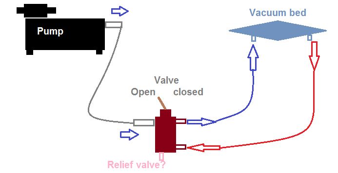

    About the vacuum surface, it's bakelite and I have LOTS of neoprene gasket. What I don't know is the system layout:
    at the moment, I have the Pump connected to a on/off valve that has a 2 way connection to the plane. Is it ok or do I need a relief valve?
    seems that in the on/off valve there is a possible relief valve but I'm not sure, and I haven't connected yet the pump to the power since I don't wanna brake it.
    here is the system layout:

    is this ok or is missing something?
    I'm not sure if the relief valve is there, can you recommend a way to test it?
    If you only intend to machine aluminium,you should have bought a mill.I fear that you may be introducing difficulties by installing 12NM steppers as the machine was built to hold the workpiece in place with 8NM applied to the drive and you won't be able to increase atmospheric pressure by 50% as easily as you can bolt a new motor in place.You also need sufficient surface area to allow the workpiece to remain in place and a piece of wood occupying most of the table would be enough a small aluminium component or a machine vice wouldn't have the area.While you could bolt a machine vice in place,it would lose a proportion of your Z axis.
    I have only used two machines with vacuum systems and only one of those had a pressure relief valve.It only operated if we turned off all the valves to the zones of the table.The other ,smaller machine had no valves to table zones and no pressure relief valve-we just turned the pump on or off with a push button switch.

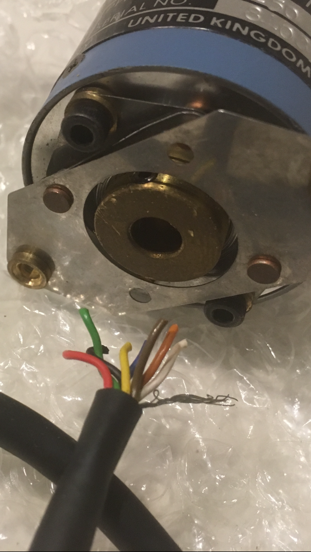

    Those servo motors you've removed, are 1.2Nm continuous stall, and will deliver that torque all the way to it's maximum speed of 5000RPM. They also have a higher instantaneous/peak torque, which gives you a boost for fast acceleration.

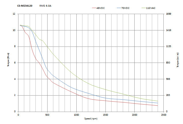

    Stepper motors on the other hand, only produce the rated torque at zero speed. As you increase speed, torque drops of very quickly.
    I couldn't find a speed/torque diagram for those HSS steppers, but Leadshine have one published for their similar motor -
    Running with a 70VDC supply, torque has dropped to around 1Nm at only 2400rpm, so you have under half the performance of the servo motors you've removed at continuous torque, and probably under 20% once you factor in the instantaneous torque available with the servo, which is where servos excel over steppers.

    Forgot to mention, I'd guess the vacuum pump will be some kind of simple design with high leakage, so it's unlikely any kind of valve is needed. You just need to plumb the pump to the bed, although depending on the bed design, it may be better to put it through a manifold to control zones (if the bed is machined with zones?), and also some kind of filter to stop anything being sucked through the pump.

    The key to using those will be making sure the encoders are suitable. You need quadrature encoders, not resolvers which your machine might just be old enough to have.
    For modern servo drives, the tacho output from the motor is generally not needed.
