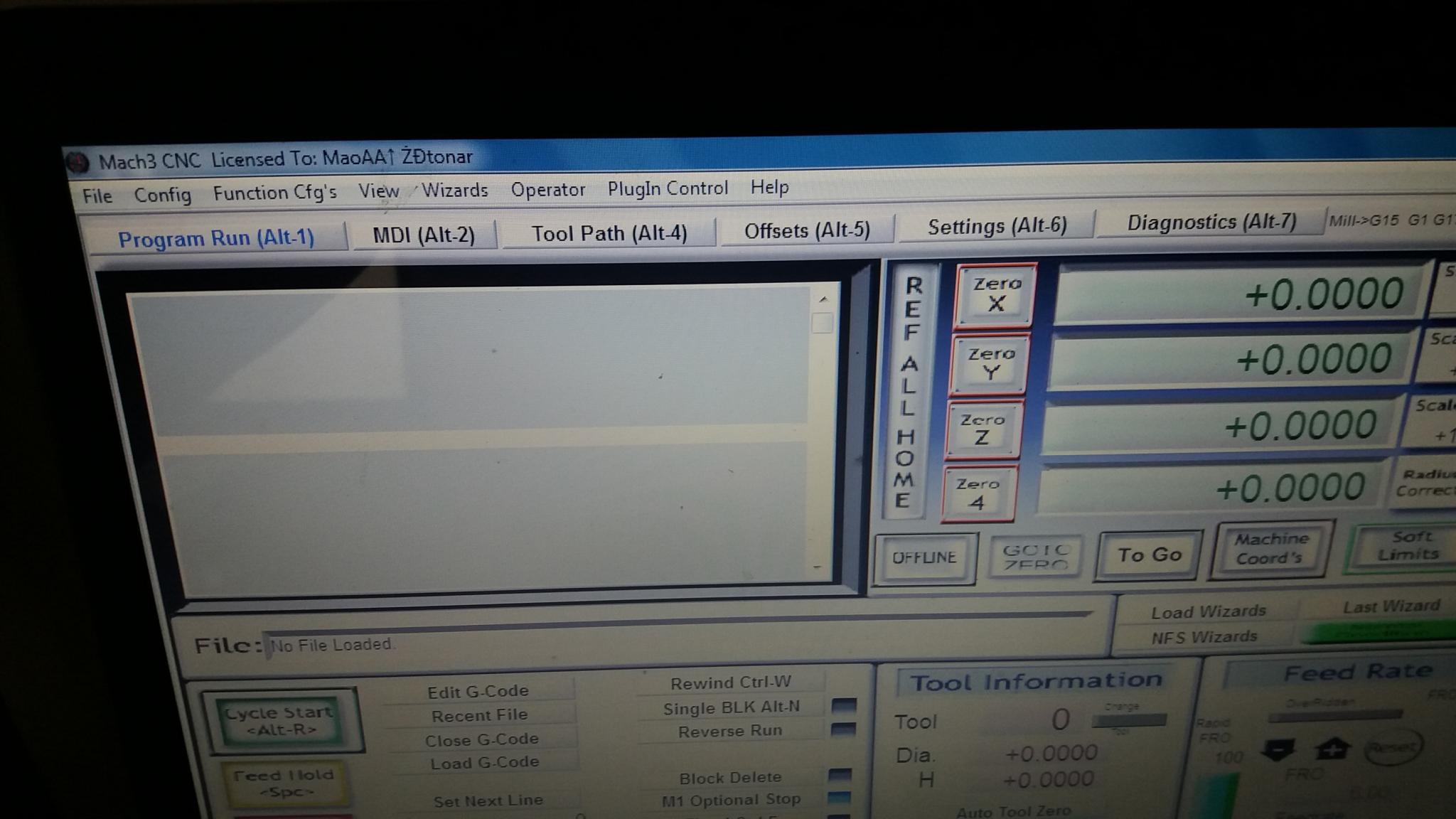

    Hi all, i am new into this forum and i come to ask for some help as i can't manage to find the solution to my problem. Please, if anyone has an explanation regarding this phenomenon. All wiring is multiple checked, in jog mode works fine, in MDI mode works fine, when cutting it works fine. No loosing steps. I can't figure out why it happens when i do tool probe or axis calibration. Before uc400 i had a chinese usb motion control card and never had problems like this.
    https://www.youtube.com/watch?v=zydpSAkk04o
    Hi again, it seems nobody came across with this type of problems so far, mean while i solved the bug in my system, so, for those who will switch to different motion controller you have to make sure when you reinstall the software, don't drop anything related to the old motion controller into the new software. My big mistake was when i reinstalled the software to drop in the Mach folder the old XML file that i believe was related to usb motion controller in the software that machine came with. That XML file i suspect it was corrupting the UCxx plugins in Mach3 causing that weird phenomenon. Now without it the software and machine runs flawlessly.
    Thank you all for your attention.

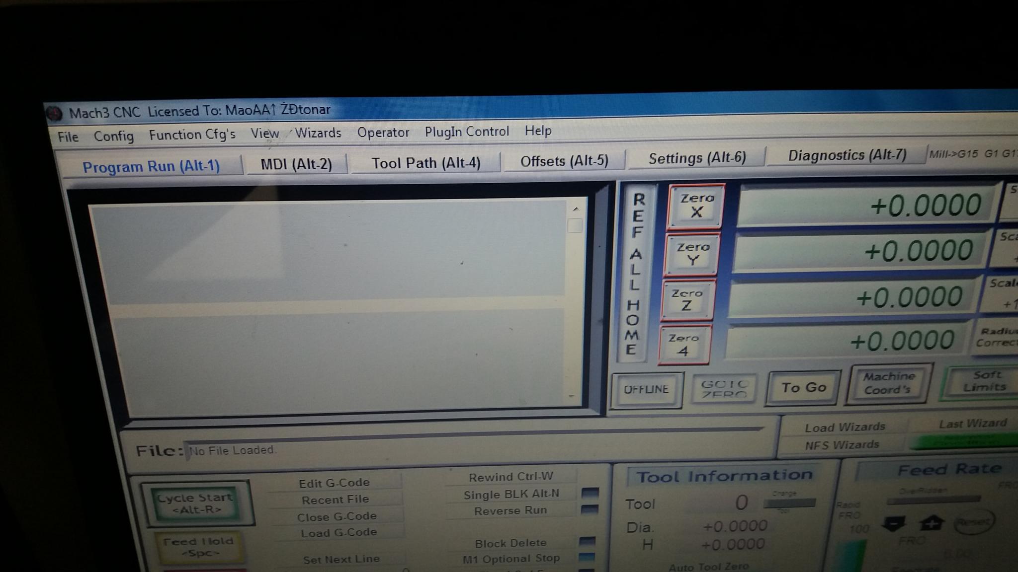

    What version of mach3 is it .? Also, it doesn't show that it's licensed at the top so it could be in demo mode. Not everything works in Demo mode.
    Email: [email protected]
    Web site: www.jazzcnc.co.uk
    It's Mach3 version 3.043 which came wit my 6040 cnc router so it's kind of chinese licensed. It might be limited on functions, i couldn't say if functions are locked because i am a hobbyist and also a beginner in cnc world, but for me it works, especially the functions i need and use basically and i'm happy that my new system is now more stable and reliable than the 6040 one.
