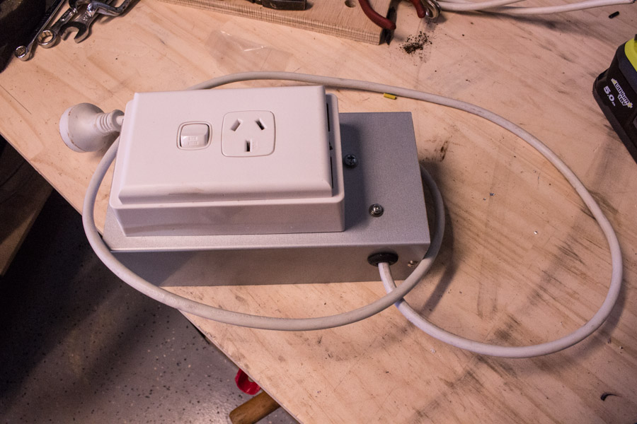

    I've fitted the mains filter and installed it in the machine. I can now power the whole beast including the controlling PC running LinuxCNC, controller with BOB, stepper controllers and motor supplies, water pump and VFD from a single mains socket. I haven't yet got the scope out to see how much noise is still visible on the controller wiring but at least it works!
    The filter is a standard, two stage filter from RS which I linked to earlier. I've also added a ferrite ring to the earth wire since this is a probable route for high frequency noise to escape.

    So after all that the wretched thing tripped again after 5 minutes of behaving itself! Plugging the VFD into a different mains socket fixed it again... I hope.
    Maybe I'll try putting the filter on the controller and/or LinuxCNC PC mains input. Or maybe I'll take up sculpting portraits in clay instead where none of the tools need electrickery. Or maybe I'll make do with it as it is for now and, if this hobby ever does look like it may turn into a bit of a money-spinner, build a complete new reliable controller with an AXBB-E and learn UCCNC. I've got it running in demo mode on my laptop already. Looks OK to me.
